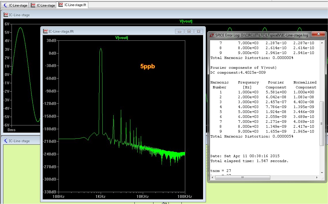

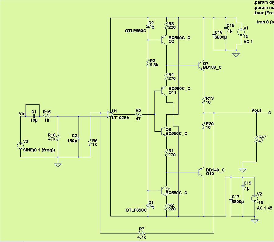

Richard , 10ppm is a standard goal for a power amp , but something
like a line stage , or other intermediate audio stage , why not sub ppm.
I just found a "Lehmann" headphone amp buffer. (below).
Very widely cloned by the asians , they just slap a NE5532 behind
the diamond and most audiophiles give above average reviews.
My LT1028 model just "floored me" !! 😱 (below 2). The buffer
and it's feedback just "dropped the bottom out" of the IC's THD .
Worst I could get was .2ppm 20k (33R load).
I have a better discreet buffer than the Chinese clones (and a better IC) ,
but what a good price/simplicity to performance ratio !!
Any part of your audio chain where you can just eliminate distortion is
an improvement.
