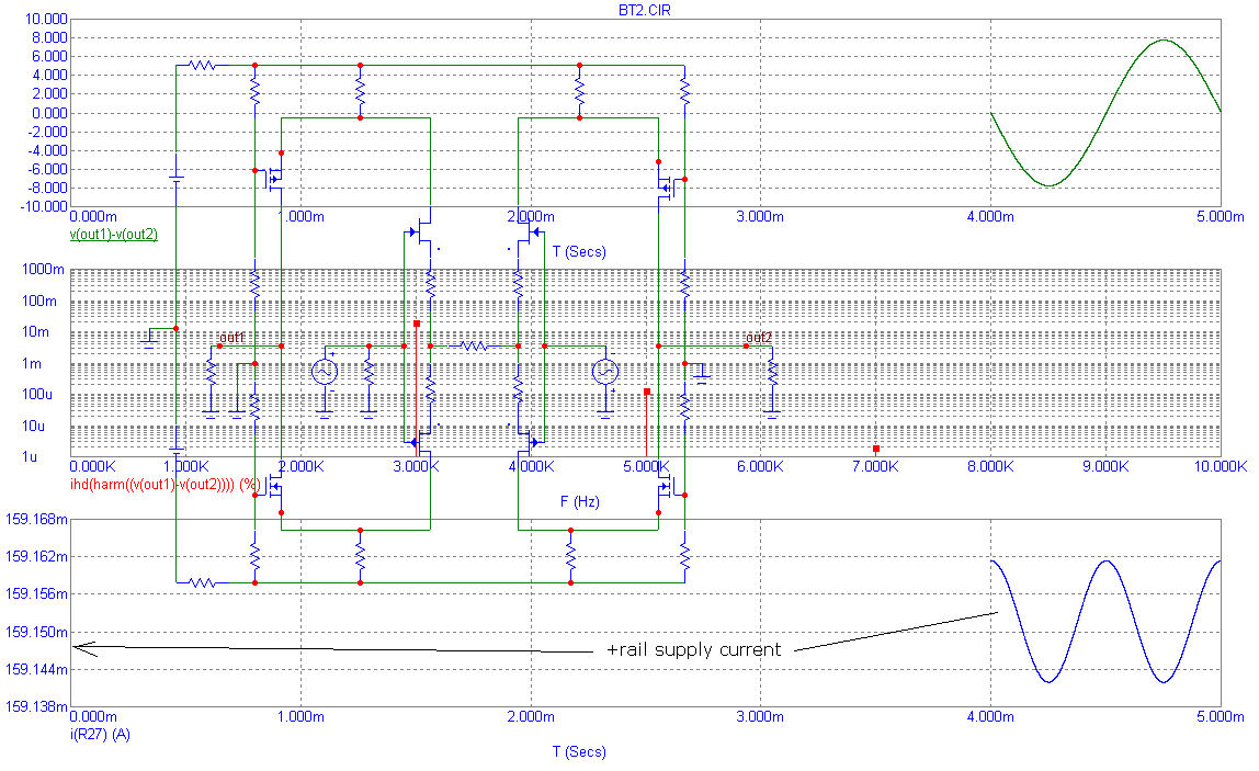

Jan, in the CTC Blowtorch the current changes are almost unmeasurable, because it is a class A, complementary differential folded cascode stage that forces the current to be constant at all times to a first order approximation.
Yes, the BT supply current is almost constant.

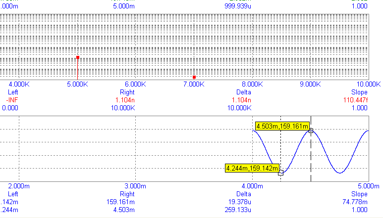

OK, so with the 1k load, and 8V peak Vout, I would expect 8mA peak supply current variation.
Which is exactly what your sim shows.
So it appears that the supply current variation is exactly the same as the load current; in other words the load current is reflected in the supply 1:1. Whatever this circuit does, it does nothing to supress supply current variations.
Your statement that it 'does have very little supply current variation' or words to that effect is wrong.
jan didden
jan didden
Where have you read this?? (8mA supply current variation). It is about +/- 0.01mA. For a clever guy like you, I would assume more circuit theory understanding.
