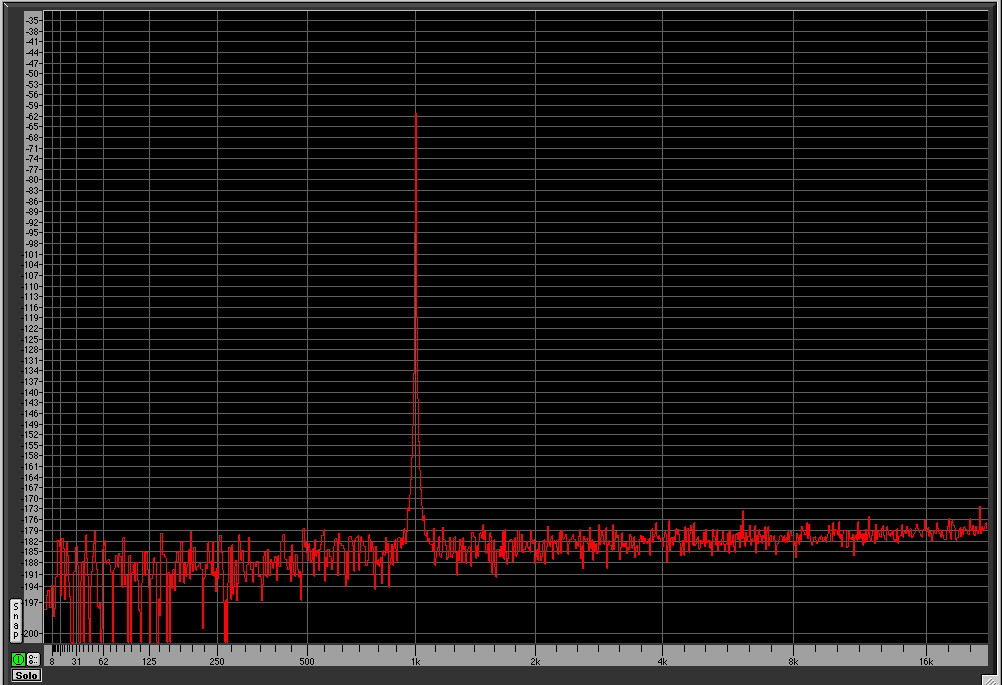

What PMA showed was, in my opinion, a computer generated -60dB file that was loaded directly into analyzer.
I can do that too, see below. 😉
997Hz, -60dB FS, 24 Bit, NO DITHER, PEAK reading, Hanning window, 32k FFT (0.7Hz resolution).
You see - there are no traces of distortion. Why the 'floor' looks like a noise is a puzzle to me..
BUT (!!!) good luck getting the low distortion numbers, like in PMA's post, in real life during signal capture. Take a look at any modern ADC datasheet - 'best' ones show theoretical THD+N numbers around -56 to -60 dB relative to the -60dB FS signal. And that's more like 0.1-0.15% , not 0.02% !
No puzzle at all. Your starting "opinion" is likely incorrect. This looks like a loopback.
Thermal noise of a good cartridge might be -70dB, so even if your numbers are correct, that's hugely worse, even for a perfect record/TT (which don't exist). But I don't think your numbers are correct.
