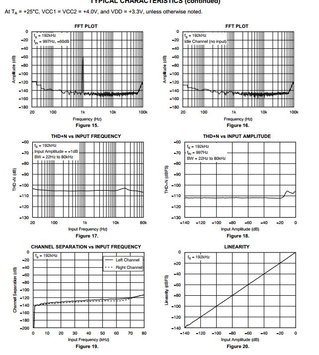

But I don't think your numbers are correct.
http://www.ti.com/lit/ds/symlink/pcm4220.pdf
Page 11, Fig. 18 shows THD+N below –110dB for input amplitude down to –140dB ref max input of 5.6V. This –140dB is then 0.56uV. This is almost equal to two LSB for this 24bit ADC. Impressive.
And Fig. 19 shows an equally impressive linearity.
Fig 15, Fig 16 FFTs show that the THD+N is actually only N (Noise) and this THD+N is btn 0.01% to 0.1% of the –60dB signal .
George

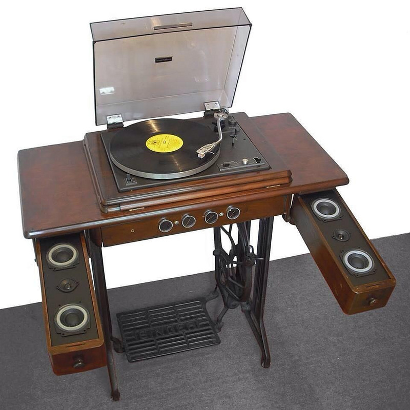

It seems to be missing the belt. How does it spin?
I wonder how many of those Singer made they are all over the place.
George
Looks like 24 bit playback system would be a step forward. Nit-picking..... specmanship at work... the dynamic range is at 0FS not -1. So the 'typical' value is actually a few dB's lower than -108. Just one of those little fudges manfr do to look equal/competitive. Its isnt much but they try to slip it by.
