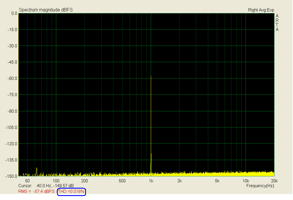

And we all know what the distortion levels for ADC/DAC conversions are at these levels.
I do not know the answer, Scott can probably calculate this in his head,
If you take a sine wave , ADC (-50dBc) convert it to digital using your best ADI chip (16/44.1K), then pipe (I2S) to the best ADI 16/44.1K DAC, measure THD, what #'s are we talking here, I am guessing >0.1-1% THD (IHF limits?)
How do we lower the thd+N at levels below FS? -- If we just want <0.1% at ANY level down to at least -60dB re 1v (if not the full dynamic range)? This is at the center of why analog continue to sound better on a distortion basis. How many bits are needed for 0.1% thd+N all the way down to -60 and -80dB ?
0.1% of -60dB re 1v is 1.0E-6 V (1uV)
0.1% of -80dB re 1v is 1.0E-7 V (0.1uV)
For 16bit and FS of 1V, LSB is 1.526E-5 V
For 20bit and FS of 1V, LSB is 9.537E-7 V
For 24bit and FS of 1V, LSB is 5.960E-8 V
0.1% of -60dB re 2v is 2.0E-6 (2uV)
0.1% of -80dB re 2v is 2.0E-7 (0.2uV)
For 16bit and FS of 2V, LSB is 3.052E-5 V
For 20bit and FS of 2V, LSB is 1.907E-6 V
For 24bit and FS of 2V, LSB is 1.192E-7 V
24bits can cover your extraordinary requirements.
IMO all these is theory.
In practice, even the thermal noise of the analog signal coming into the ADC (thus encoded into the digital stream entered into a DAC) easily reaches the LSB of 20bit/2V FS
George
>Edit. What does this screenshot represents Pavel?
George,
Thank you for this information. I must admit that I don't understand the underlying process here in how the digital bit or word length is changing but do understand your numbers. I am trying to comprehend why changing the output level required truncating the bits to do this, but see even though that is the case that the distortion is still very low even when you do do that. I still don't know the answer as to why it is done this way in the digital domain if that is the result. Would it be an inferior method to doing the attenuation in the analog domain instead of this phenomena in the digital domain or do you just trade one type of noise for another?

Next (technical):
I mention two ref voltages because Richard said so. He asked for a ref of 1V and then of the full dynamic range (not proper term) which for a CD player translates to around 2V (This is actually rmsV but I didn’t want to make things too complex )
Envision then a sinusoid with a peak to peak value of 1V(or just a bit lower).
You digitise it with a DAC that works with a ref. Voltage of 1 Volt.
That is to say that the incoming 1Vpp signal is the largest this DAC can handle.
Now the DAC has to slice the 1Vpp amplitude into 2^n (where n=number of bits) slices, for each sample it takes in time. So an 24bit DAC makes 2^24 slices, i.e. 16777216
If you stack all these slices one over the other it makes 1 V, which is the height of the ref . Voltage that this ADC is using.
So each slice has a thickness -an amplitude- of (1/16777216) V, or 59.6 nanoVolts. This is called the resolution of the ADC.
In this –hypothetical-stack of slices, the slice which is on top, is given the name Most Significant Bit The one at the bottom is called the Least Significant Bit, so ADC resolution and amplitude of the LSB have one and the same physical meaning.
Of course, the 1, 2, 3… Least Significant Bits encode the lowest part of the signal.
Now Richard asks for a weak signal (-60dB rel 1V) entering the ADC.
This sinusoid has an amplitude of 1mVpp.
It is short, so as it passed through the 'knifes' of the ADC which have a fixed height, only some will cut it. Thus, it will be sliced into ‘only’ 16777.216 slices.
The 0.1% of the 1mVpp (which is 1nV) that Richard is talking about is almost twice the amplitude of LSBs
If on the other hand Richard is talking about the distortion created by the digitisation of this weak signal, here is what I think:
The precision in height of slicing (which is around ½ LSB and which is close to what is called quantisation error) is -intuitively calculated- 30nanoV and when mathematically derived, it is even less.
So this 30nV is the 1/3 of what the 0.1% of the 1mVpp (which is 1nV) that Richard is talking about.
I hope the numbers are correct🙂
