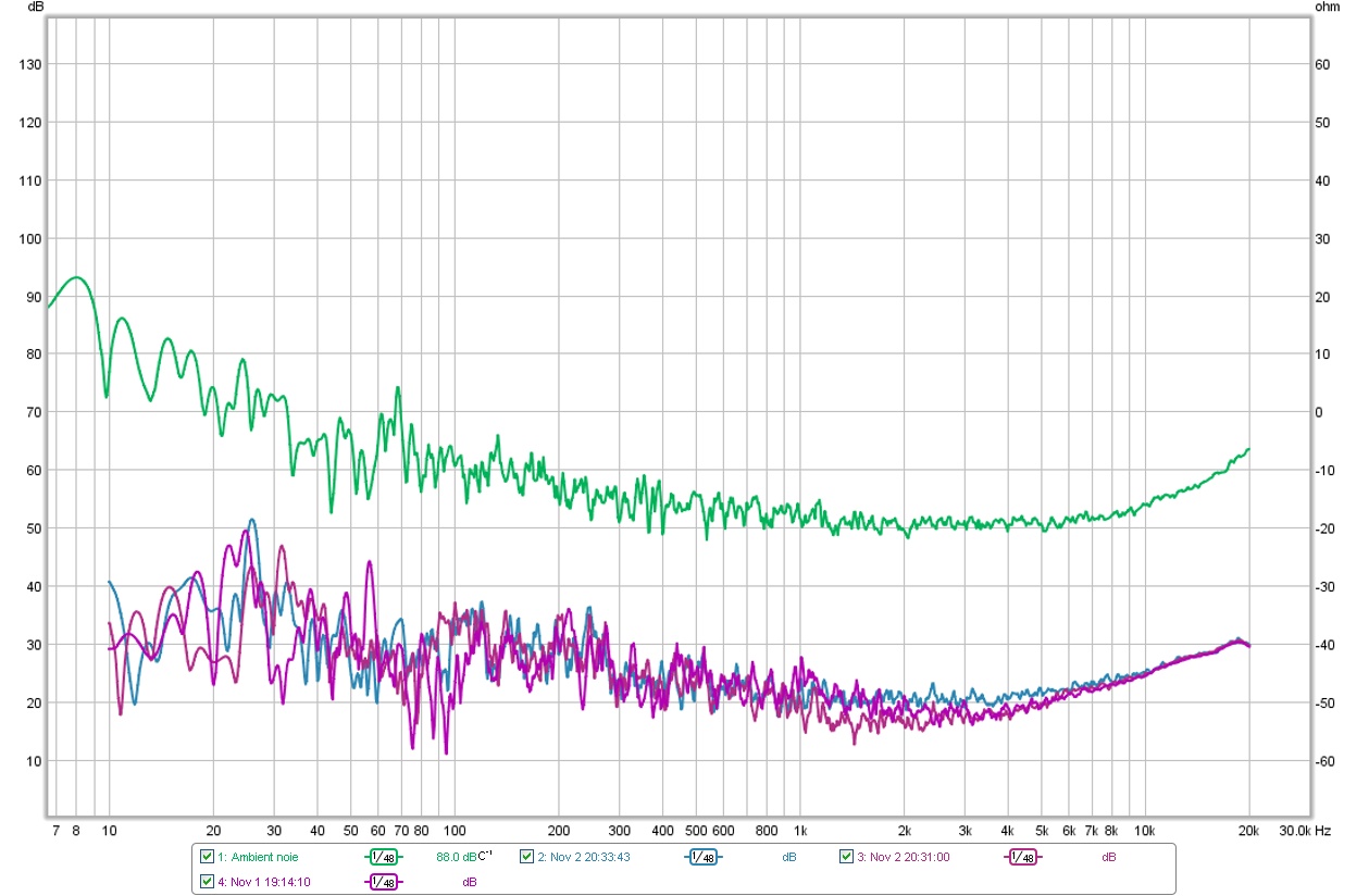

This is my living room at it’s quietest (during daylight time, plots are some 20dBs up) . Each of the three plots is a two measurements averaged. Each measurement last for 5.9s
George
Very nice ! In the mid-upper-mid where our hearing is most sensitive you are at about 20dB spl. At least an 80-100dB dynamic listening range or more. That is also the noise level of good studios.
And here (see attachment) you will say that it is ugly but it could be worse!
Upper trace, same apparatus, same cal file, 12 Feb 2015 18:48 same room, with very low outside noise (it was snowing, no car traffic outside) but an air-conditioning unit was in operation on another neighbouring space, 6m away from the mic.
That must be the theoretically achievable.
From the few times I have casually monitored the min and max SPL while listening to music, I don’t think that the dynamic range was more than 60-70dB.
You have intrigued my curiosity for doing a more cautious observation on what is the average dynamic range in my living room with the music I listen to (classical and opera, the later only when I am alone at home :D )
