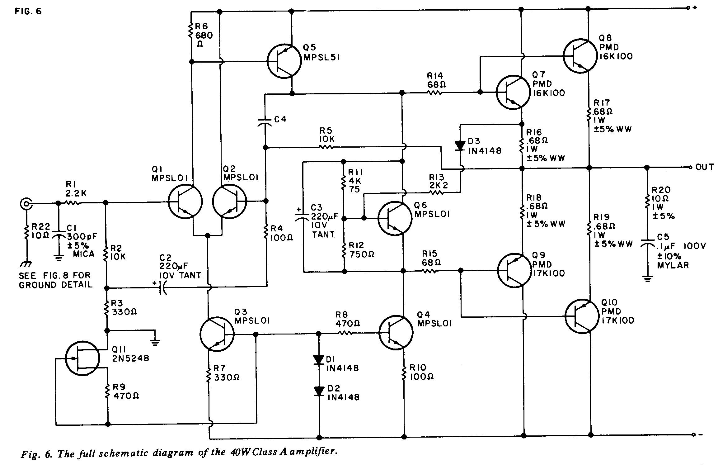

I recall you had a single diode version before this one in an amp you sold. One day, a new technician employee at LLNL who had worked for you had a copy of your schematic which he showed me... a single diode from output to bias circuit to bump up the bias with signal level. Can you show that also now?

I think you are referring to the 1978 Audio Amateur "A40" which was simply
an auto-bias circuit. Note that the output devices are Darlingtons with
two diode drops.
Yes, that is what I was shown by tech. He had full size sheet schematic.
Also, TAA. Auto bias. 😎 Looked like maybe a precursor to the patent idea you show.

Looked like maybe a precursor to the patent idea you show. The post ESS amplifier era in Sacramento.
This was '78. The sliding bias stuff came from '74, but this was a lot simpler
for beginning DIYers.
