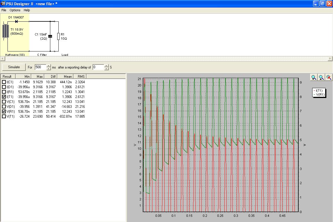

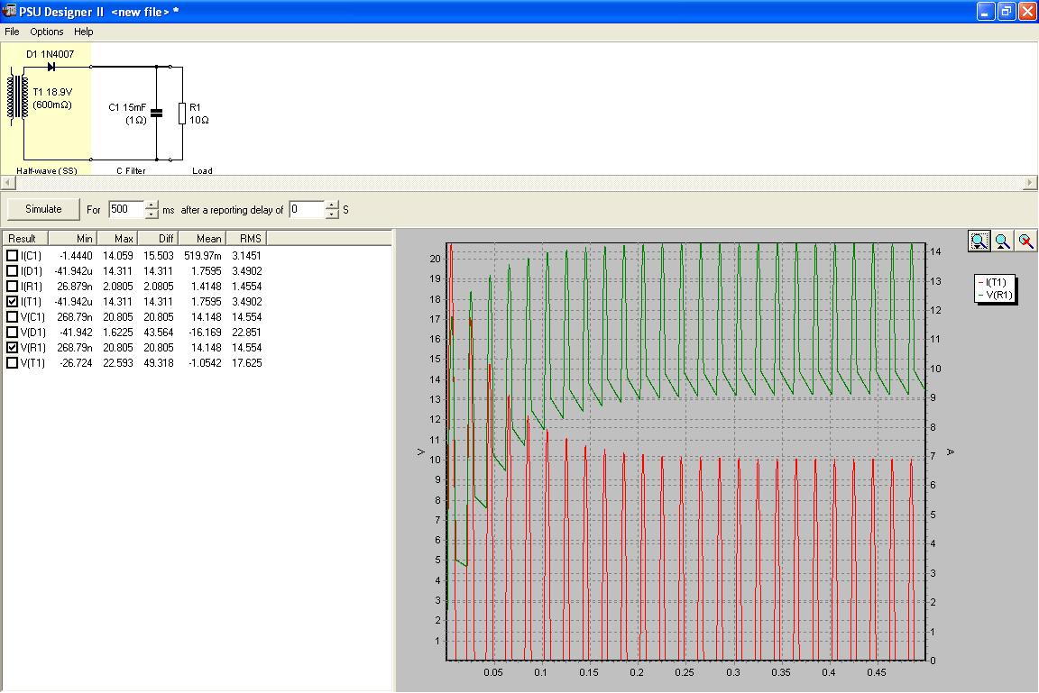

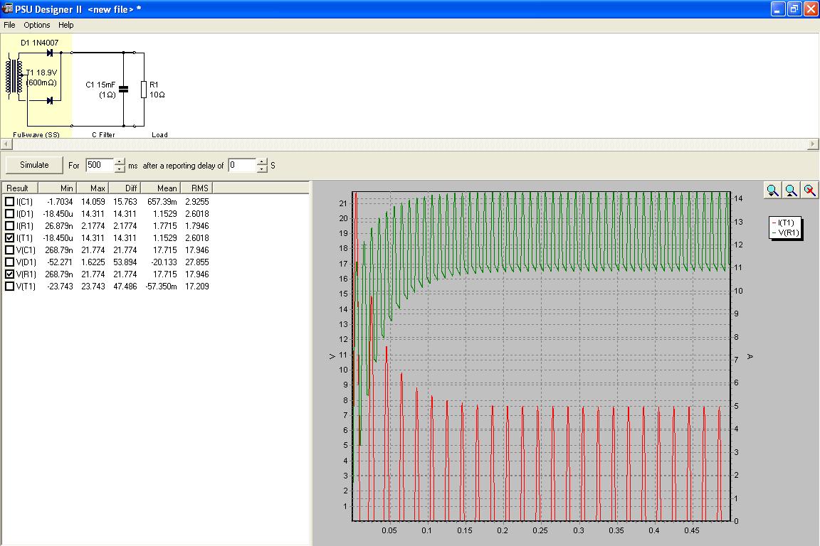

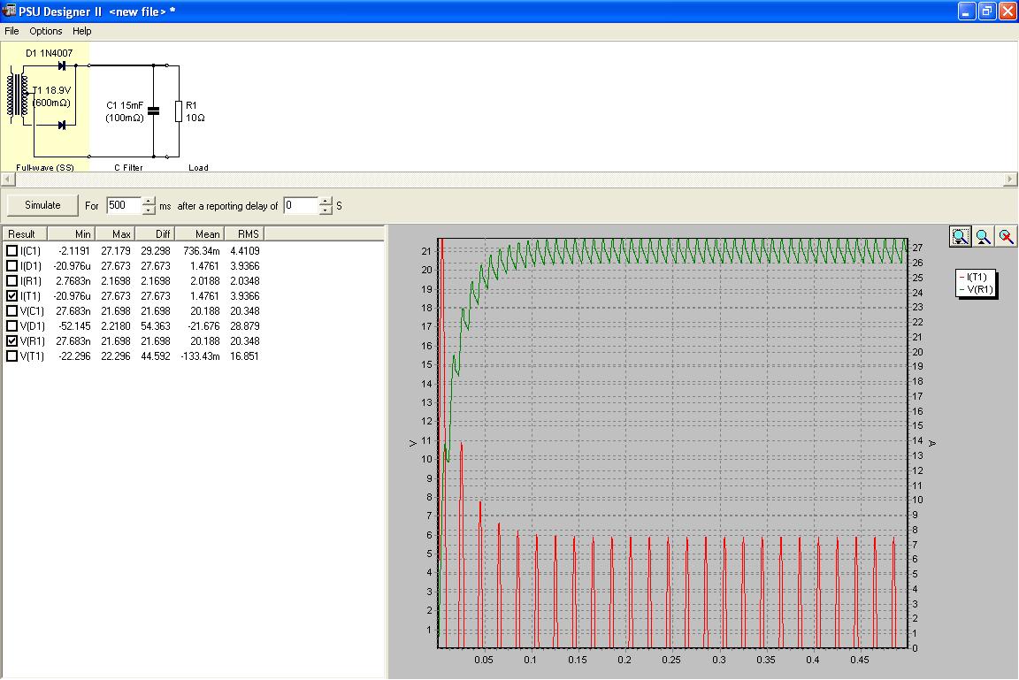

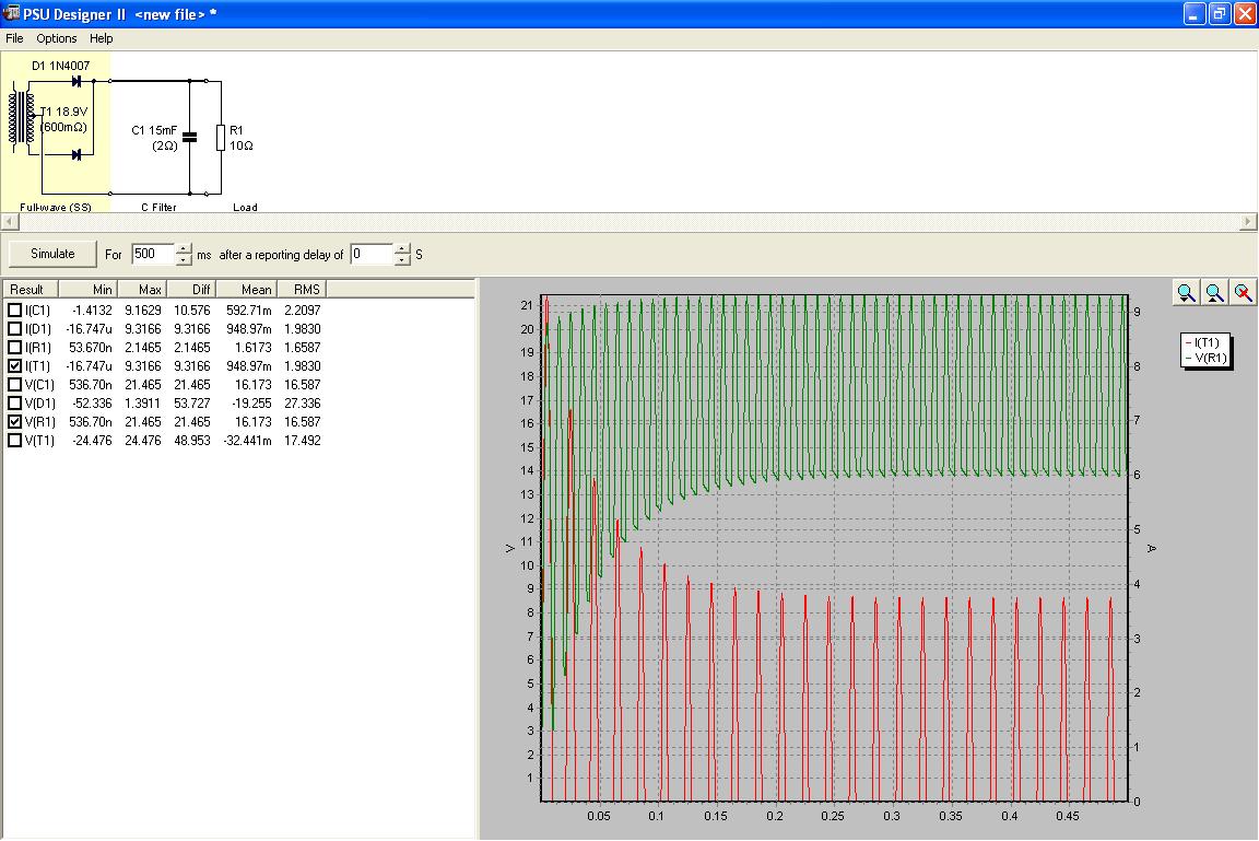

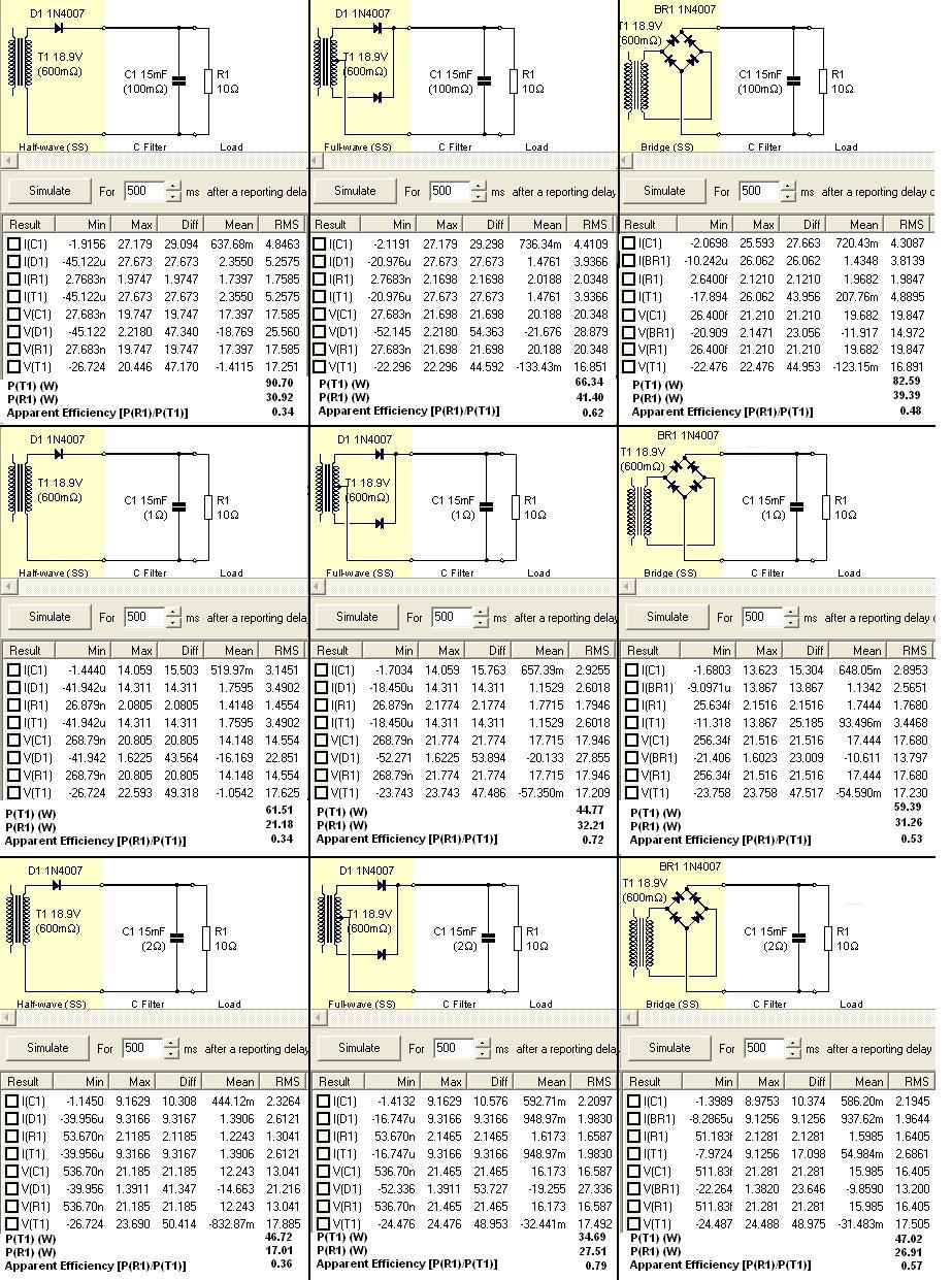

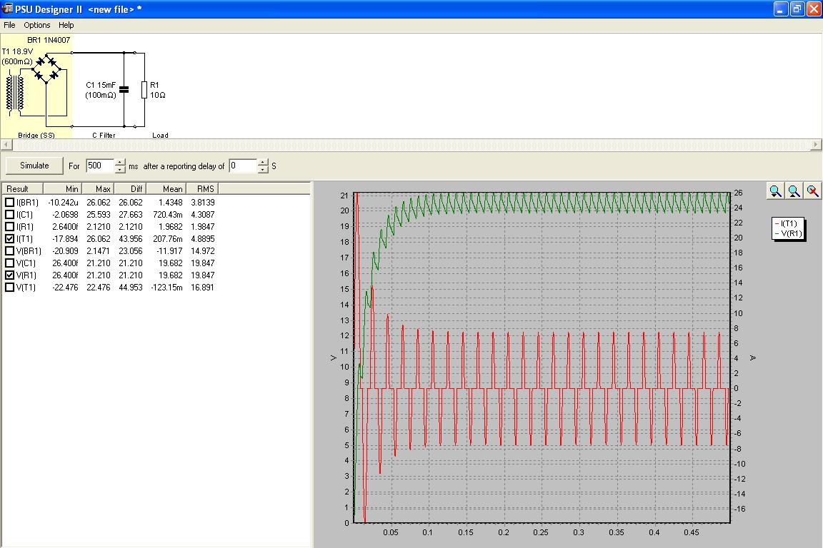

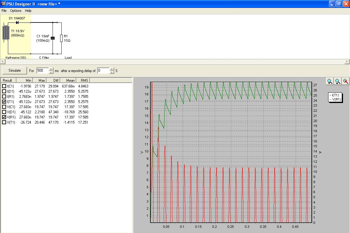

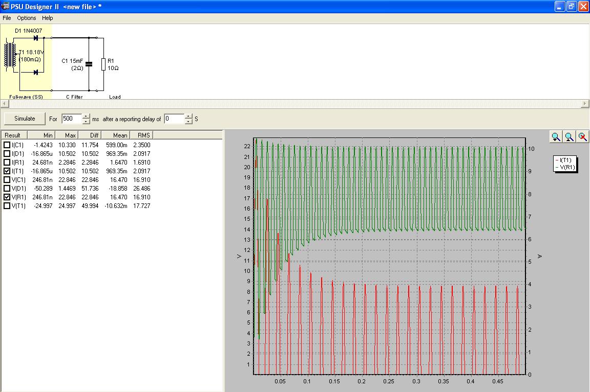

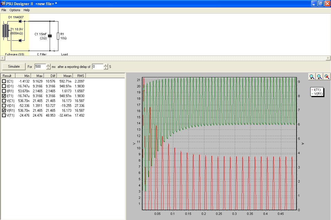

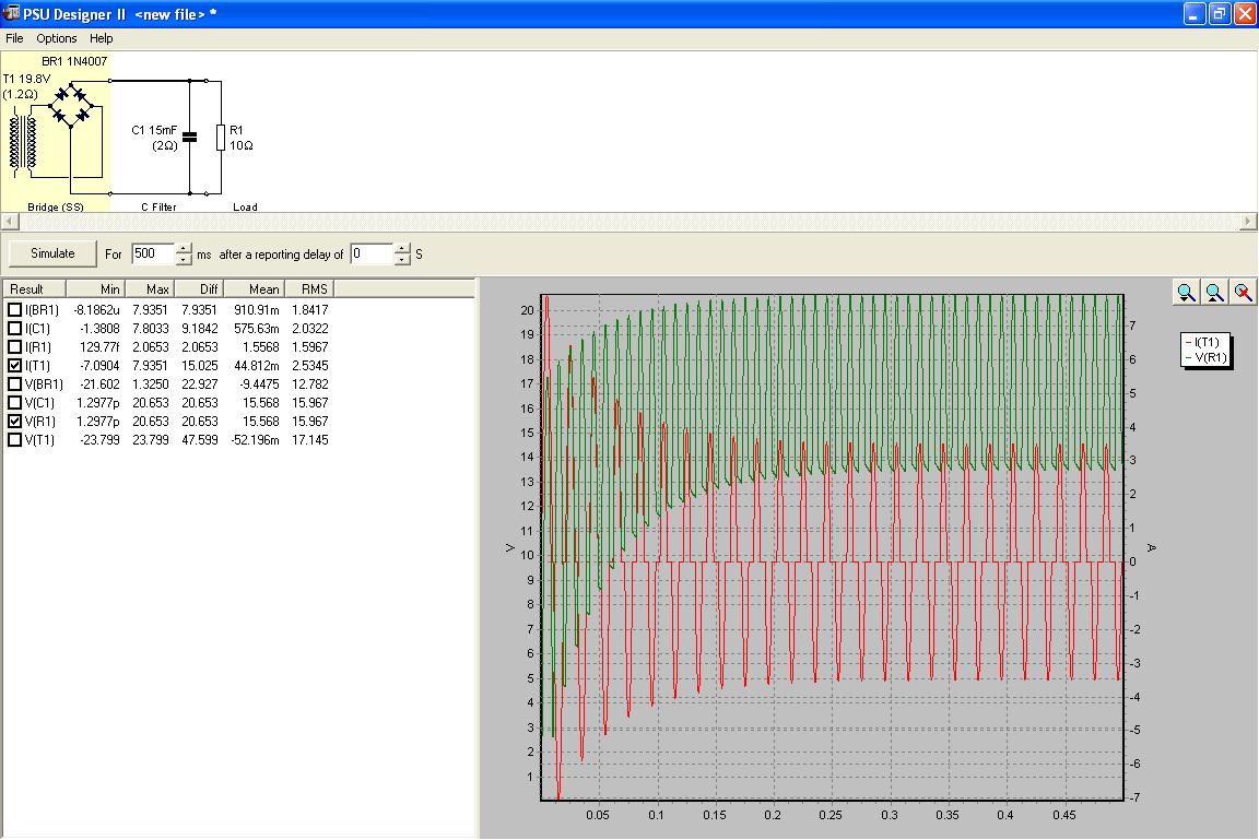

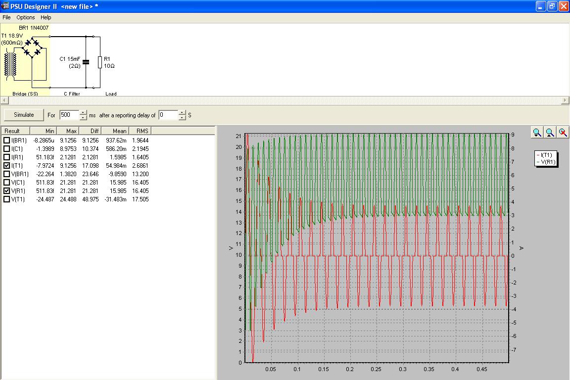

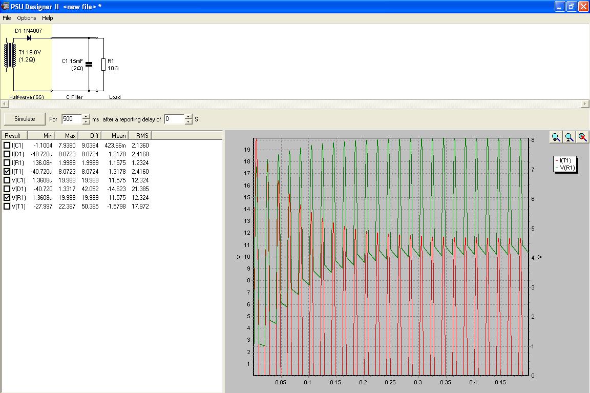

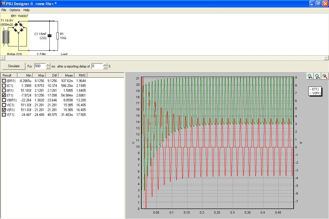

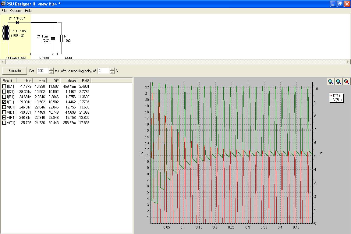

I simulated the psu situation (I have verified results of PSU II with actual measurements many times in the past, so I tend to trust this simple sw). I kept your scenario. 18V rms (nominal) transformer, 1.5A load current, 15000uF capacitor.
The sims show an increase of transformer current with the bridge rectification compared to the FWR (two diodes and a center tap transformer).
The increase is not that dramatic as you say but it is noticeable.

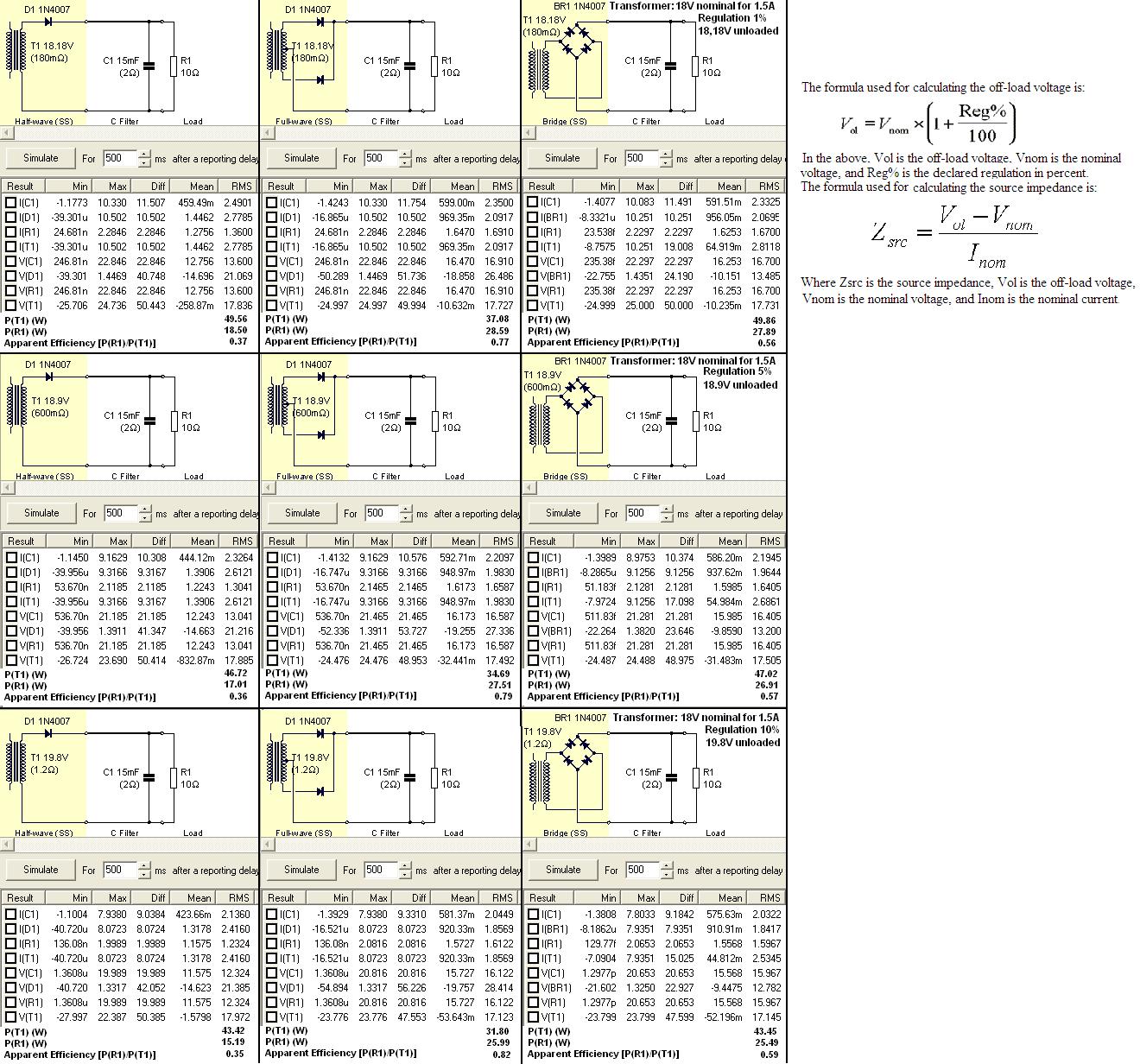

I went a step further and calculated the power supplied by the transformer [P(T1)] and the power consumed by the load resistor [P(R1)].
In all cases [P(T1)]> [P(R1)], thus the ratio [P(R1)] / [P(T1)] I call apparent efficiency.
Then I started to look for what else might affect currents and voltages. Two parameters seem to play a role:
a) the transformer’s voltage regulation ( see the following attachments)

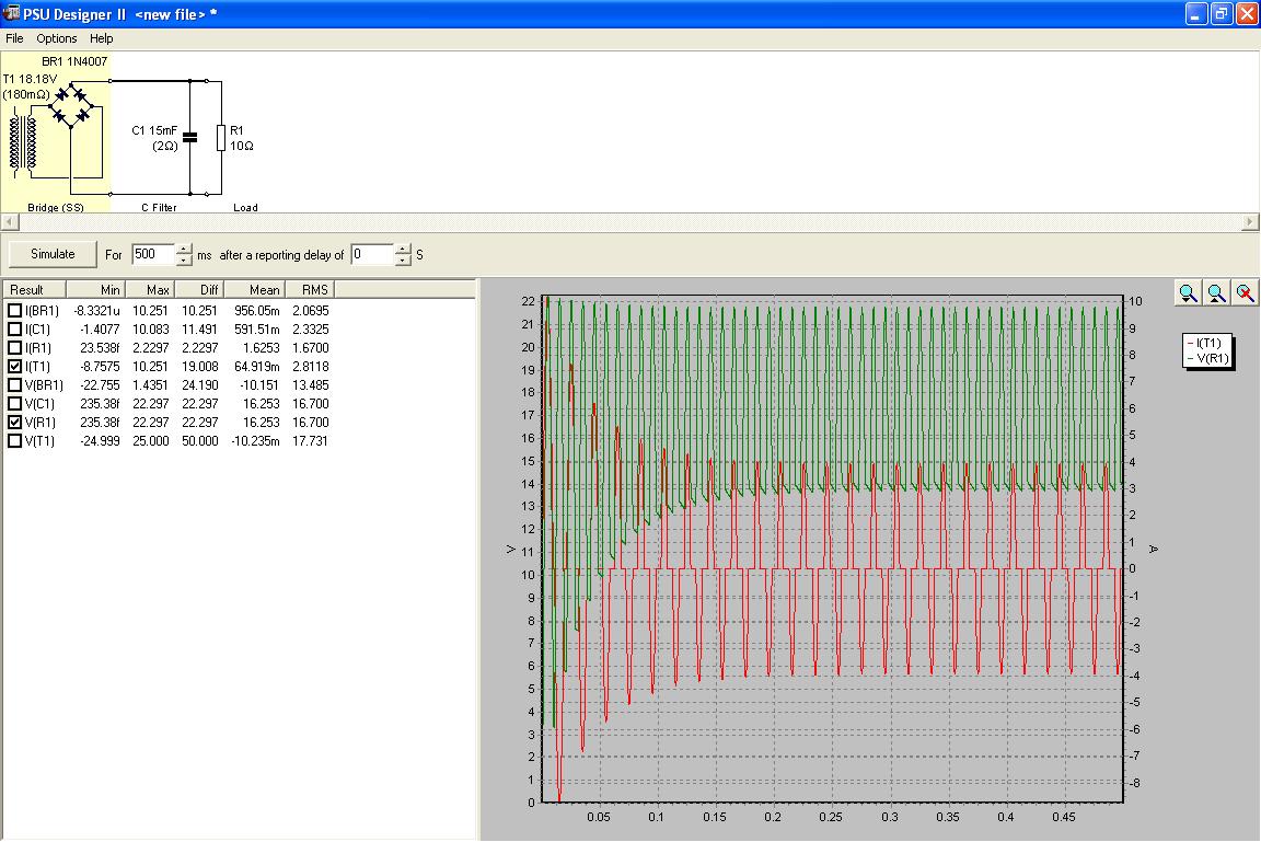

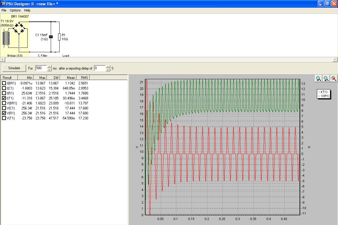

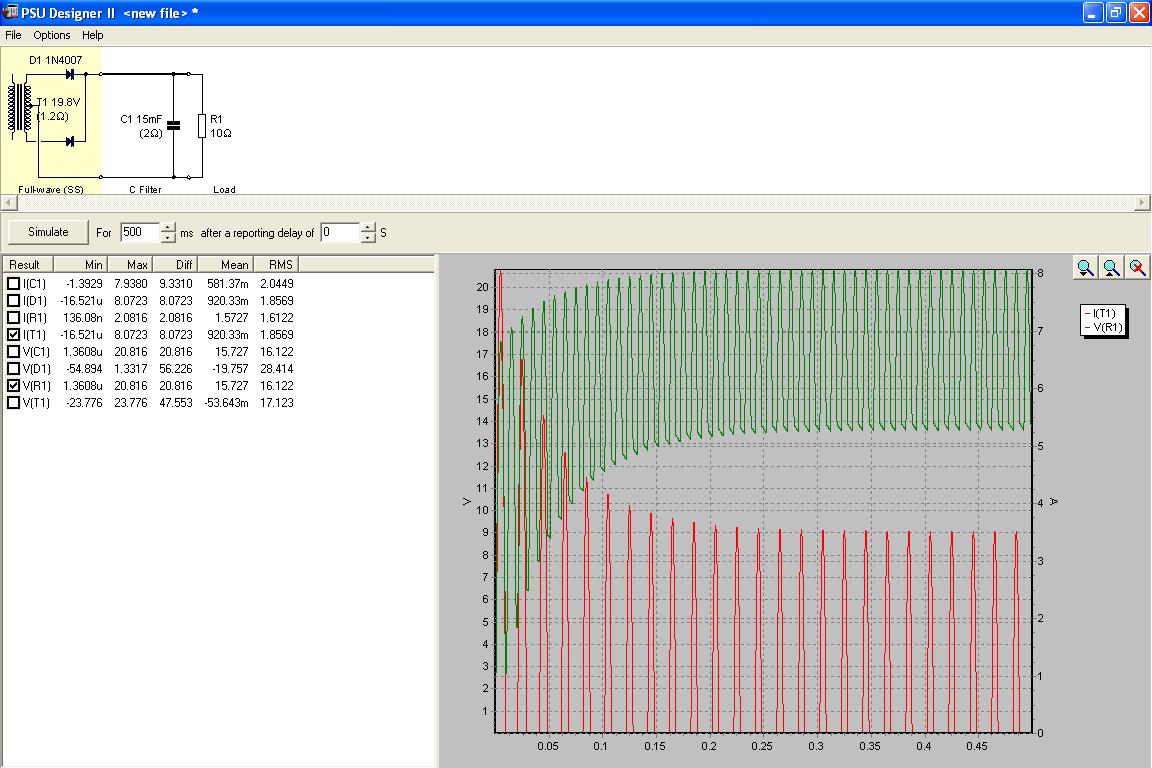

...and b) capacitor’s ESR.
For these simulations I kept the 5% transformer regulation constant and varied the cap ESR.
100mOhm ESR for 15000uf is achievable by paralleling many electrolytic capacitors.
The charging current increase due to that low ESR was a surprise to me.
If this sim reflects the reality, it is not a good practice to place low ESR caps right after the diodes.

If I would mind gross differencies (which was my initial intention), I would make the following sum-up.
