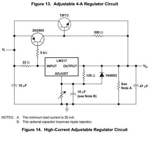

Dan, probably this is what Ed suggests (from TI LM317 datasheet).
For the negative line, use the LM337 with 2N2219 and TIP 74.

George,
I have seen too many of that design fail. If you substitute modern transistors it may oscillate and even with the older ones, it is not a good thermal design.
But let us start looking at what would be required to produce a 1.5 amp 16 volt supply for Australia. The power is 50 Hz with a minimum voltage of 216 volts AC RMS and a maximum of 253 volts AC RMS.
The minimum voltage across a regulator is typically 2 volts DC. So this would be 18 volts DC into the regulator. Allowing for a full wave rectifier voltage drop of 1.4 volts and a 5% ripple we would require a Peak voltage of 20.4 volts out of the AC power transformer.
Using an Avel made in China toroidal transformer our voltage choices would be 15 volts AC RMS per secondary or 18 volts AC RMS.
Now a 15 volt winding would only have Minimum AC Line Voltage divided by rated Voltage times 15 volts or 216/230 x 15 or 14 volts AC RMS out. This would give a peak voltage of 20 volts, just shy of our target of 20.4 volts.
So the choice would be a unit rated for 18 volts out. Now as we are designing for 1.5 amps peak output that by itself would be just under 60 watts for both windings. As I anticipate loading with a full wave bridge that requires almost double the current capability. So I would pick the model Y236453 that is rated for 120 Volt-Amps at 2 x 115 volt primaries and 2 x 18 volt secondaries.
Now the maximum voltage into the regulator would be 253/230 x 18 x 1.414 -1.2 or just under 27 volts. So there would be a worst case 11 volt drop across the output transistor at 1.5 amps of 16.5 watts of dissipation under maximum non-shorted load. Now if we have no fusing then the worst case power dissipation would be 81 watts per output device.
Now there are some tricks to reduce the ouput device power dissipation and provide other benefits.

Thanks George.Dan, probably this is what Ed suggests (from TI LM317 datasheet).

I was thinking of something along these lines myself.
LM338 is TO-220 variable 5A 3 pin regulator for $20.00 for pack of 5 (local RS Components).
So maybe no need for bypass/helper transistors...can't be more simple ?.
Thanks Ed.George,

Good to bring up real world conditions, ambient temperature would be my final arbiter, but not a real consideration in my case here.
My thoughts are for now in this case dead simple junkbox parts construction, splurging $20.00 on pack of 5 LM338 TO-220 varable regs.
My mains is usually 252V, right now I am not sure exactly what transformer secondarys I have on my shelves until I measure them.
I am thinking two LM338 in series per rail to give easy adjustment of relative dissipation and wider choice of junked transformers.
The 16V supply spec is not fully tight, I think I saw 15V somewhere.
In any case its a box full of 071 and a few 5534, all isolated by power local series resistor/local bypass cap, so power voltage is not critical, and perhaps supply noise is not particularly critical also.
I also view this as an opportunity to have a play, and see what objective/subjective effects power supply quality has on such a mixing desk.....maybe some surprises ?.
I'm Interested in your comments.
Dan.

Thank you for commending on the circuit.
I am interested on these tricks 🙂
Comments so far?
1. My limited knowledge leads me to think of max transistor dissipation of (VIN − VOUT) × IL) = ((27-15)x1.5) = <20W . Which way do you calculate “81 watts per output device”?
2. I don’t understand the following: “As I anticipate loading with a full wave bridge that requires almost double the current capability”
Do you mean that the use of a full wave bridge loads the transformer secondary with double the current?
I am under the impression that
a) HWR loads the transformer with double the instantaneous (peak charging) current compared to FWR.
b)The average current in either case is dictated by the demands of the load
George
The 81 watt figure is for a fault condition, ie a short on the output, he did say with no fusing...Ed

George,
It is short circuit dissipation of 80+ watts. A center tapped transformer with the center grounded and a pair of rectifiers requires less current than the same with four rectifiers as each winding must now work on the entire power cycle. So the current ratting for a full wave bridge should be twice that for a half wave version.
Nowwhen using a monolithic regulator that can handle the current and is properly heat sunk, the next issue is capacitor size.
The definition of capacitance is C=q/V From this we get C x V = q. As dq/dT is i, we can take the first derivative and get C x dv/dT + V dC/dT = dq/dt = i. As the change in capacitance with voltage is very small we get C x dv/dt = i. For a fullwave bridge on a 50 hertz AC source we can reduce this to C =i/100 x 1/dv. At 5% ripple or about 1 volt we get C= 1.5/100 Farads! (15,000 uF).
So the simple power supply would be a fuse, transformer, fullwave bridge, a pair of 15,000 uF capacitors and a pair of regulators. Now if the transformer has dual windings we can use two bridges and both regulators can be the same! Of course small decoupling capacitors across the input and output of the regulators are probably required for stability.
Now adding a few parts can decrease noise and ripple and actually lower the cost.
I would use five 1000 uF @ 50 V capacitors in parallel for the first filter capacitor and then use a pair of 1- 5 ohm resistors to couple that voltage source to a second bank of five more. The increase in filtering will really drop the ripple. So if the junk box transformer is a bit high on voltage, dropping it with resistors is a very low cost method and provides the benefit of not only saving money on capacitors but also reducing heat sink requirements.
