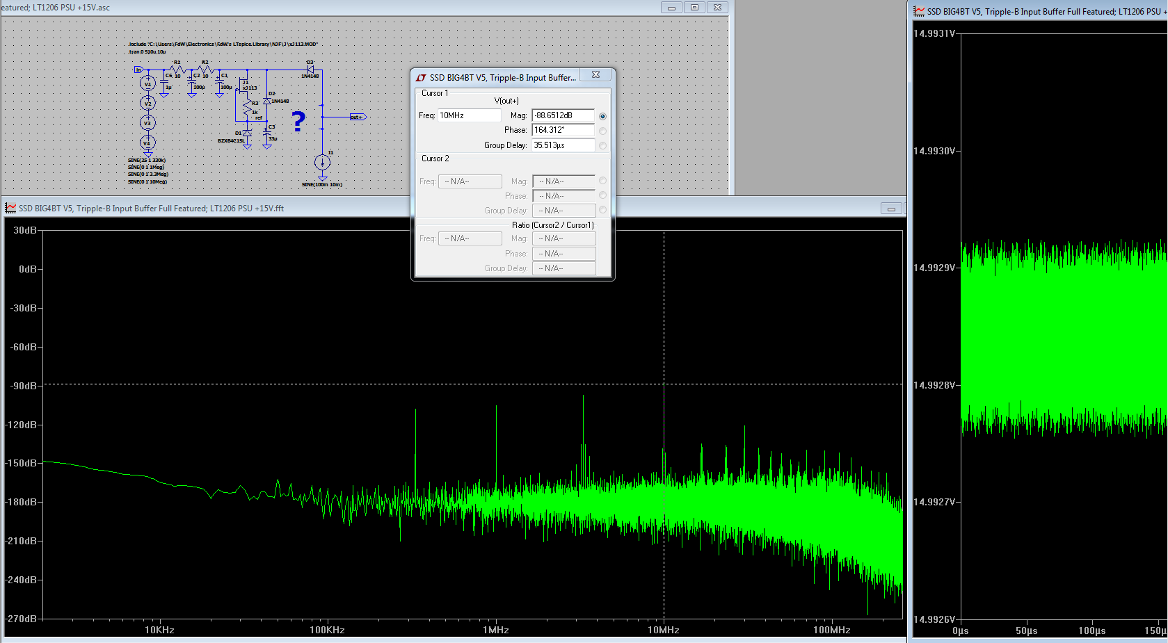

I wonder why anyone has the desire to use batteries for supplies, Even for for floating supplies a set of cascoded Jfets will suspend the circuit and keep PSSR sky high. Also with batteries you have more problems than the noise, charging and shelf-life are also factors.
I do agree 🙂 This simple 100mA loaded (250mA max) PSU shows (almost) 90dB PSRR at 10Mhz!
