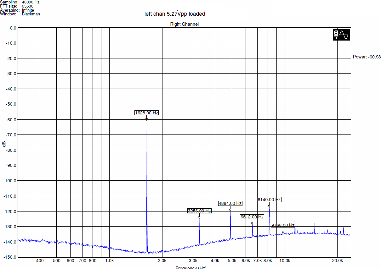

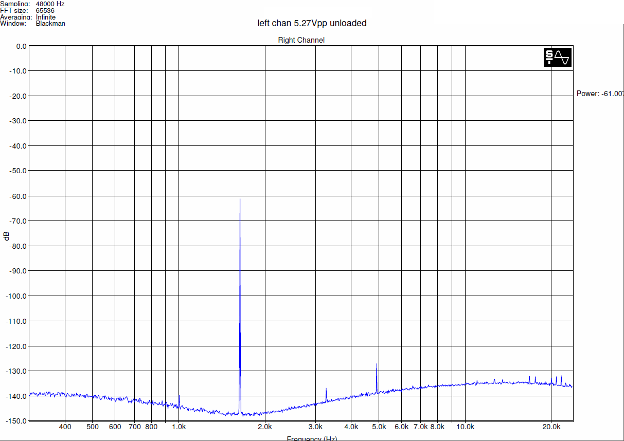

OK. The point is further made re OPS distortion under low Z loads... and showing that it is cross-over distortion. BTW - wouldnt FFT show this also?
Richard, of course it would. Measurements with fundamental notched of 61dB. FFT is far best tool to show this.
I assume this might be audible. Our imagination is not restricted to a single sine 😉
BTW, this is the opamp + BUF634T. So even a monolithic buffer is not a complete cure.

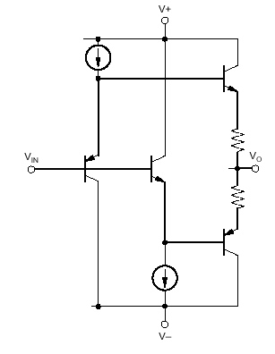

What else about OPS of opamps?
Follower topologies of the output stages of said opamps.
I have a book on IC design from the mid 80's in my possesion, whose author expressed his dislike of the complementary EF topology that is so popular here and is also incorporated at the output of thousands of opamps these days.
He talked about the condition where one of the input transistors of such EF becomes saturated (even if for a very short time) and what happens when this EF is inside the FB loop.

Probably refers to the input followers which might also be starved for current or in the case of the pnp very slow. This would be much less of a problem these days.

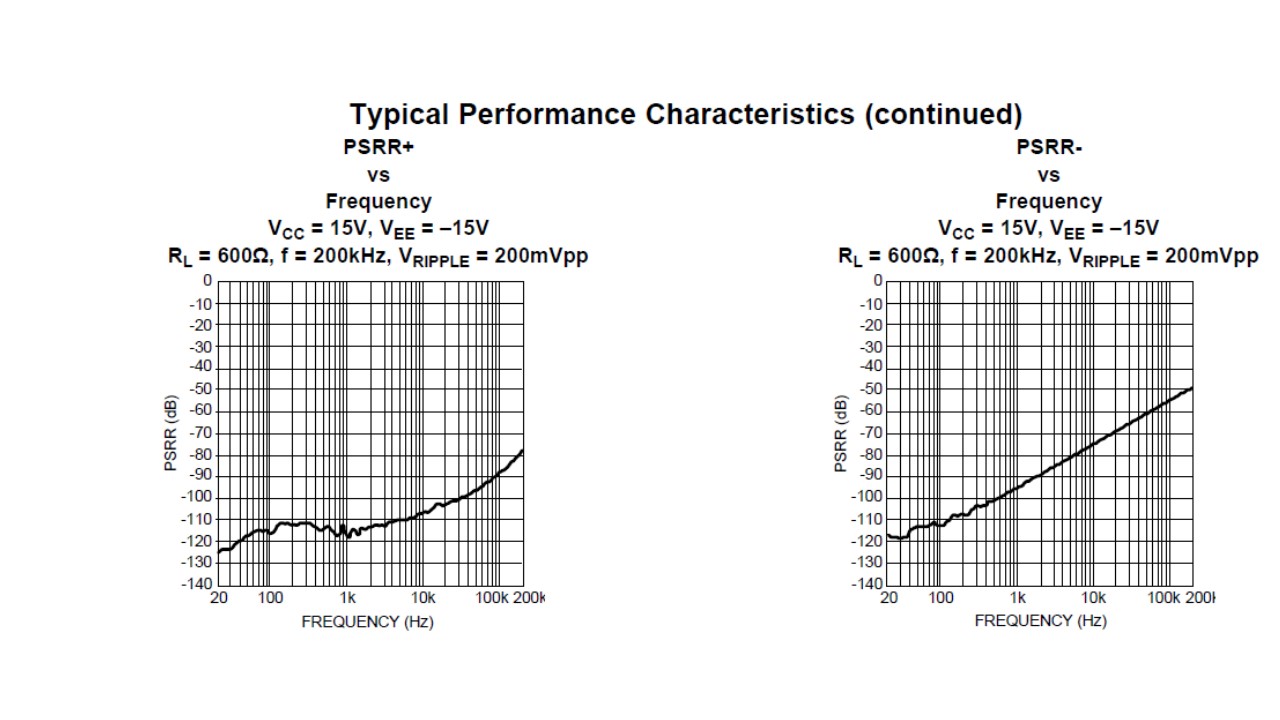

Right - and which opamp has stellar PSRR above 100kHz? Very, very few. I recall Bruno Putzeys pointing out in one of his excellent PPTs that due to Ccomp, PSRR tends towards 0dB at HF, to the rail that Ccomp attaches to.
LM4562 PSRR.
Very good up to 20 kHz; above 100 kHz it is not spectacular - but then I dont expect discrete solutions are any better (quite the contrary - I expect in most cases they are much worse).
Class A operation and heavily damped (i.e. local RC filtering - I use 22 Ohms and 100uF per rail per opamp) rails fix most of these issues.

There are not many discrete solutions that can meet all of the performance points of a good Modern IC opamp. At 100 kHz the 4562 still delivers 50 dB PSSR.
Yes Bonsai, and on the positive rail even 90dB @ 100KHz; for me the main reason to switch from opa134 to the LM4562.
