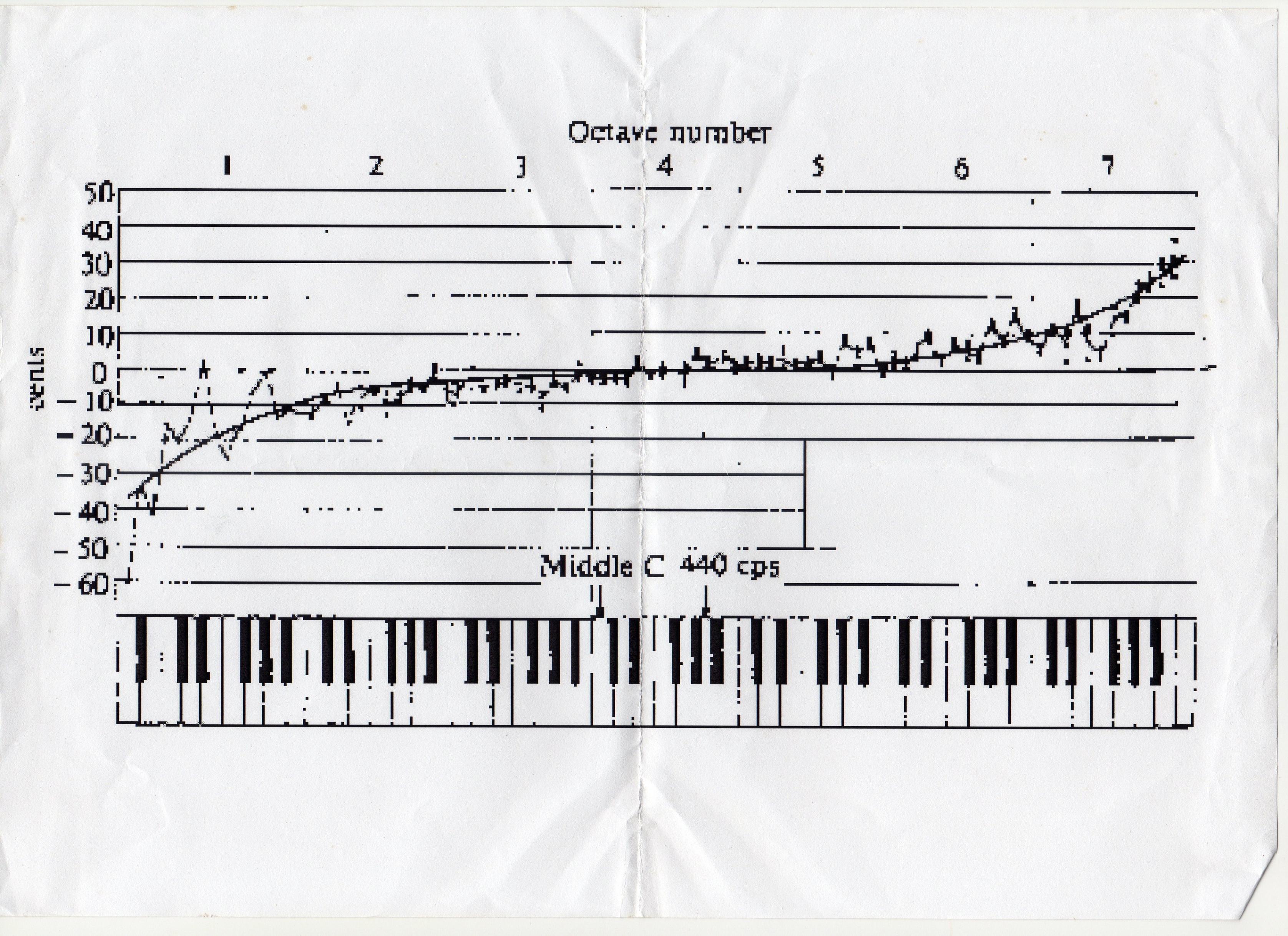

I went to a piano store in Roseville, CA. Huge building.... with several concert grand types from yamaha, steinway et al. I went around and hit keys on each and only the low notes didnt sound on key to me. So, went to the 'Grands" and did same listening on the 'tuned' concert Grands and others (they have life performances inside this building)....... they all sounded different in the lows. perhaps they had different harmonic/overtone structures(?) and not pure... but the fundemental tuning freq seemed off. This was confirmed at the store --- they will all sound different... they are hard to get and stay in tune on those long low strings/notes..... I was told that for this reason very little has been written (other than F.Liszt) that use those low keys because of tune being off so easily and different sound. And, those keys get left behind in smaller models... which is no real loss.
THx-RNMarsh
Every piano is very different and it takes a real expert tuner to get the tuning correct for that particular piano. You can study all the frequency relationships and so on but that goes out of the window when you realise that tuning by that method alone gives poor results. The different stringing of different pianos means that ultimately, each will be tuned slightly differently to give the best result by ear although concert pitch at A440 is the primary constant for all modern pianos.
For extreme low bass on a piano try a Bosendorfer Imperial which has an extra octave on the bottom end. There has actually been music written for this specific instrument.
Does this link work to Bosendorfer audio and video files ?
BOSENDORFERIMPERIAL.COM
This shows the typical "stretching" of the octaves as done by a pro but there is no hard and fast mathematical model, each piano different.

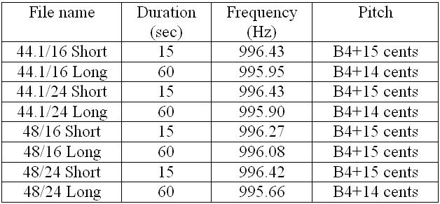

No SPDIF involved, take an HP frequency standard set to 1kHz and record it at 44.1/24 and 48/24 the two files play back at
Scott I checked my M-Audio Audiophile USB from 2001.
It uses a TUSB3200 and a 6.000 MHz external xtal to generate all the clock frequences needed for both USB operation and CODECs (as I read in the TI chip’s datasheet, even for a MCLKO of 24MHz, the programmable adjustment can be made to a resolution of 4Hz)
I fed the soundcard from a Hameg HM8030-3 function generator set at 997Hz to a card’s input level of –12.5dB (300mVrms ).
ASIO via USB, I use Steinberg Wavelab SW. The PC runs W XP SP2.
Results (attached) show no practical freq difference btn 44.1k and 48k recordings (considering the freq stability of the signal source which is neither PLL nor xtal stabilised)
In addition to these, on purpose, I initialized the SW a few times, each time setting the recording attributes, did many experimental recordings and measured the freq of the recorded signal on the spot.
At one instance the frequency of the recording turned to be 2.16kHz, although the signal generator was steadily sourcing 997Hz.
It happens that during SW loading, something happens that f the settings, producing erroneous results.
