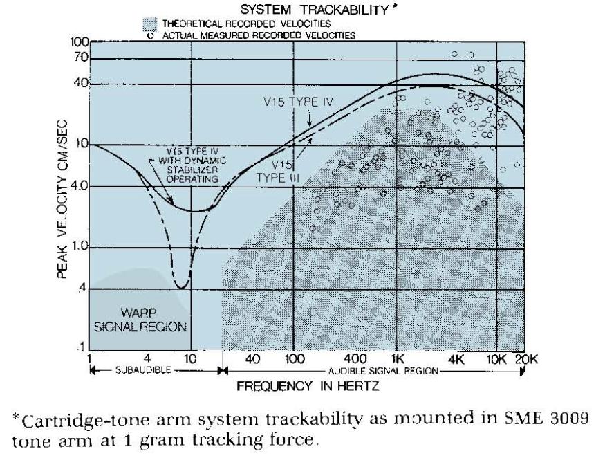

Even the FF15 is just 5.5mV at 5cm/sec, which is fairly middle-of-the-road. No MM phono stage should overload with that.
‘Should’ or ‘would’? 😀
20dB over nominal is not unheard of.
http://www.diyaudio.com/forums/attachments/lounge/422532d1402090769-john-curls-blowtorch-preamplifier-part-ii-shure.jpg
:up:
On the one hand you have noise, and the other overload capability.
Would anyone of you be willing to trade overload margin for lower noise? (serious question)

No, since one can have both.
In case that one has to choose one for the other ?
And just as important is recovery time.
I agree.
If it's essentially instantaneous, the occasional clip won't be bothersome.
Under some TT/record conditions, ‘musical’ signal may ride over a strong subsonic signal.
With certain preamplifier topologies, this combination will not produce ‘instantaneous’ overload. It is a real issue.
This is one of the reasons that overload margin should be tested over a wide freq range (starting from 5Hz).
George
