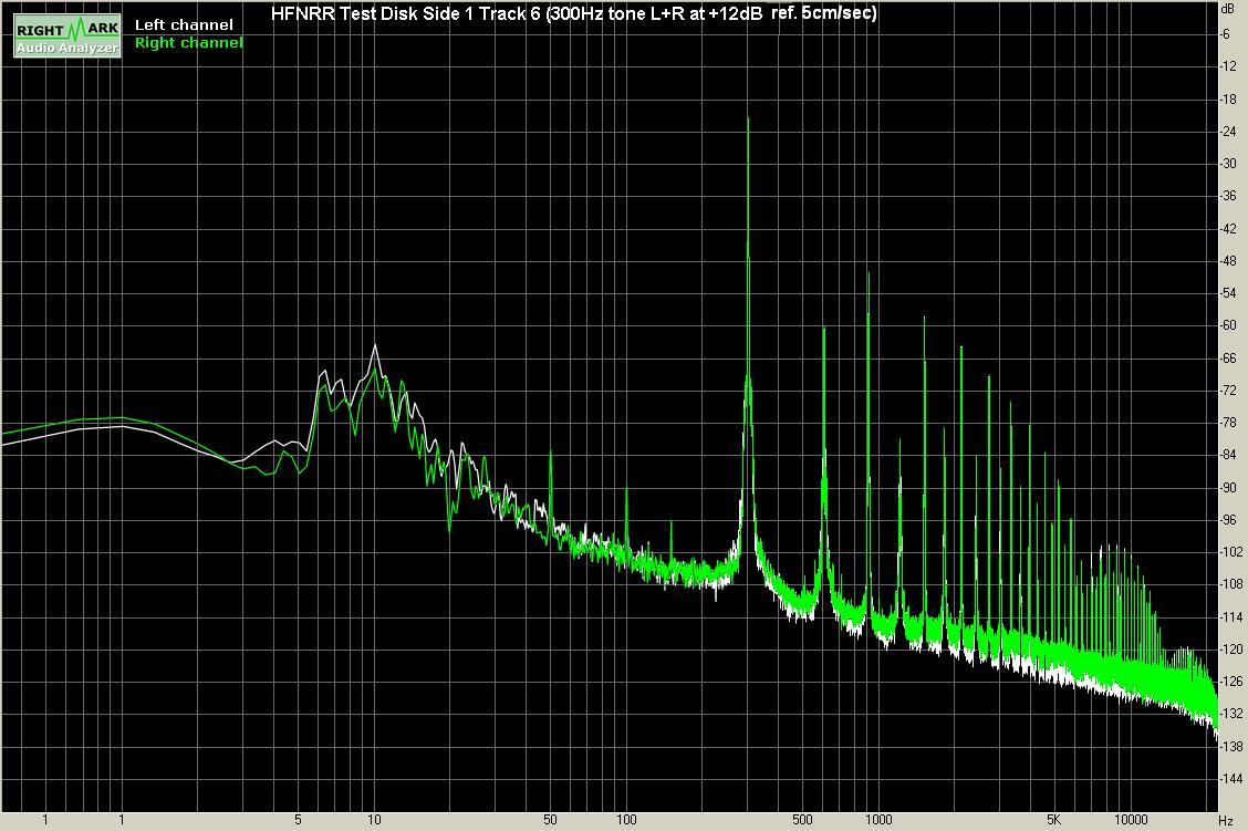

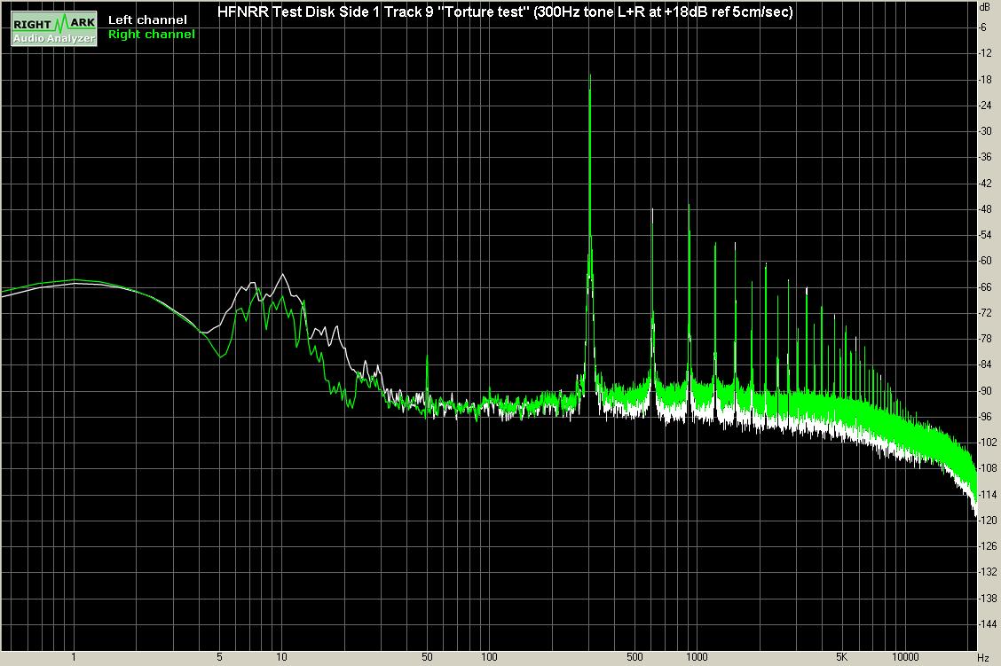

With my system, here is what I can show you.
There is some 20-27dB of subsonic signal that the pre had processed in addition to the intended sonic signal (and still not overloading 😀).
You wouldn't expect it to overload. The biggest subsonic peak is at the arm-cartridge resonance (~10Hz). That's about 40dB down from the reference, which is +12dB from nominal (in the left figure). So the LF cartridge signal is -28dB from nominal.
Let's plug in an MM with a 5mV nominal output. Assume that the MM preamp has a normal gain structure with 50dB of gain at 1kHz. At 20 Hz, gain will be about 70dB. The LF signal is roughly 0.2-0.3mV, corresponding to about 0.6V out from the preamp. Not very challenging!
