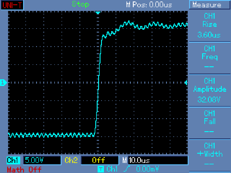

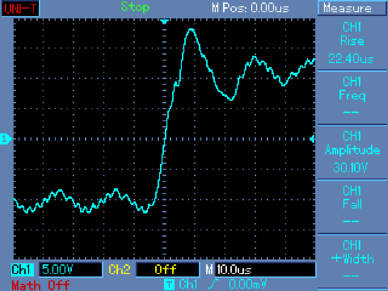

I have measured their their Hypex NC400 amplifier. At least my measurement is independent 🙂
THD is vanishingly low, but it is not everything. I do not like behavior of class D amps. Attached is step response into 10 ohm and 10 ohm//6.8uF. I do not care what manufacturers claim, this is real and repeated on 2 pieces.
P.S.: to measure THD, I have built a passive, 2 x RC filter with 20kHz cut off to get rid of the HF and middle freq mess.
Interesting that it oscillates into a such a large capacitor! This is evidence of a multi-order feedback loop being used to increase the feedback bandwidth. If you can tolerate resonances in clever places, then maybe you could do even better. Maybe this is the case with the class D amps?
Any amplifier would be expected to resonate into a 6.8uF capacitor, but if it rings even without a capacitive load, I wonder what kind of output snubber would be required to critically damp it?

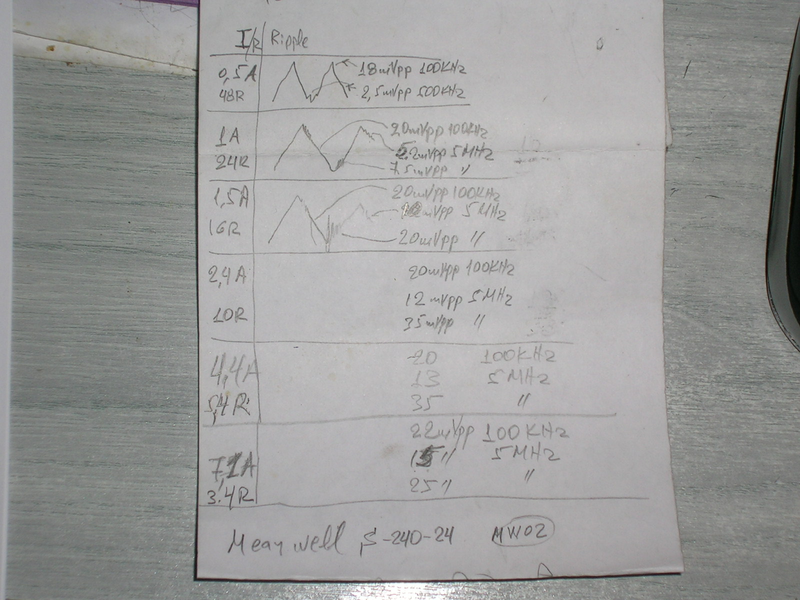

I am concerned with 'out of band' frequencies that are so strong that they interfere with measurement. The Hypex devices that we put into this amplifier are used as a variable tracking power supply. They are the source of the ultrasonic garbage.
Here is what the output of a Meanwell S-240-24 MW02 (24V/10A SMPS) looks like on an 20MHz oscilloscope when I probed it years ago .
First column is current (A) into load (R).
Second column is main ripple at 100kHz with a fairly constant amplitude and 5MHz glitches which increase in amplitude with load current.
George

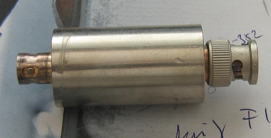

Yes, I saved it from the bin, along with a few other things. The trick is you stash them in your office and see if they get on the gone missing/needs cal list.
The top one AP High Performance Audio Analyzer & Audio Test Instruments : Accessories
This has a more reasonable price: AES17 1998 Switching Amplifier Lowpass Low Pass Filter | eBay
Somewhere I reverse engineered the AP box but I can't find it right now. That box is completely passive and the inductors appear to be very carefully worked out for it. I will find the disk I stored it on but it may take a while.
