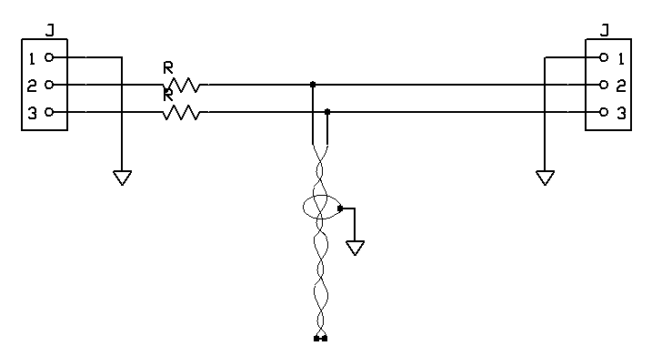

I think someone with AP can take a spool of shielded cat5 cable and make two measurements - with twisted pair and with two wires from different pairs.

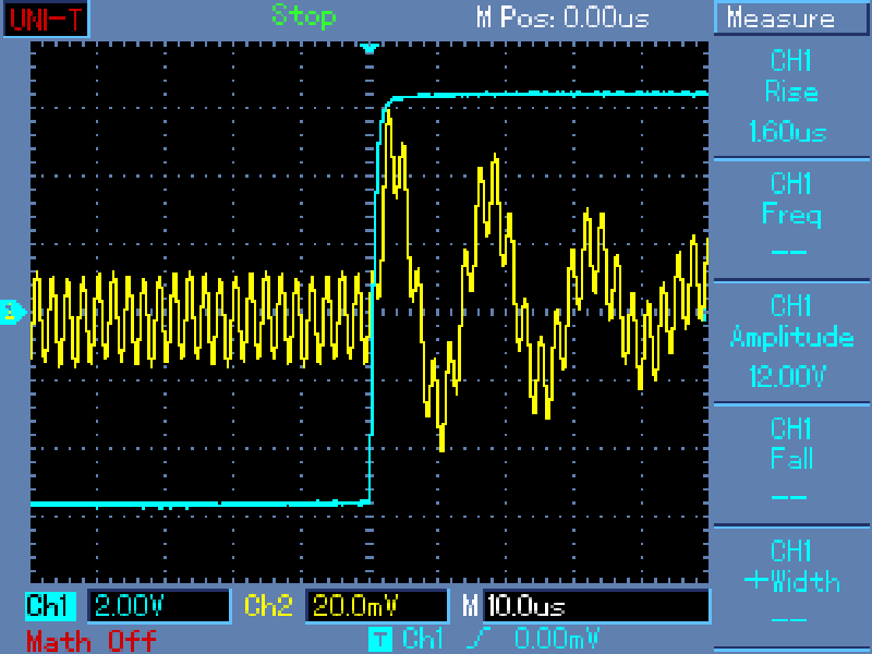

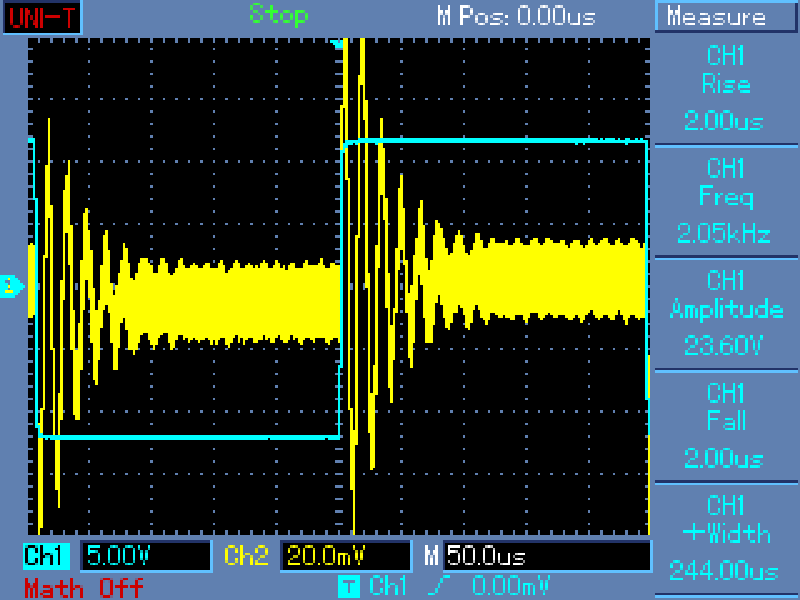

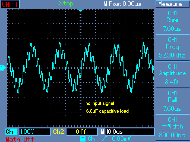

What I was commenting on is that EVEN Hypex modules can scatter significant amounts of RFI, so cheaper supplies will probably be as bad or worse in this respect.
1) They have constant HF output frequency about 450 kHz and 0.5V
2) when loaded capacitively, they oscillate at about 50kHz (attached)
3) output impedance for step is awkward (attached)

John how did you measure that RFI, or do you mean RF noise on the output of the DUT?
The latter is, in an overwhelming number of cases, either CM or a result of grounding issues between all the test equipment and DUT(s). Issues often hardly noticed with docile analog stuff.

1)1) They have constant HF output frequency about 450 kHz and 0.5V
But you spoke about amp with SMPS first, Hypex is class D PWM.
Hypex sell several SMPS as well as their Class D N'core.
The measurements your referred were for Their Class D AMPs, i suppose ? Not their SMPS ?
I see no 450 KHz in their SMPS. And, by definition, they are loaded capacitively ;-)
