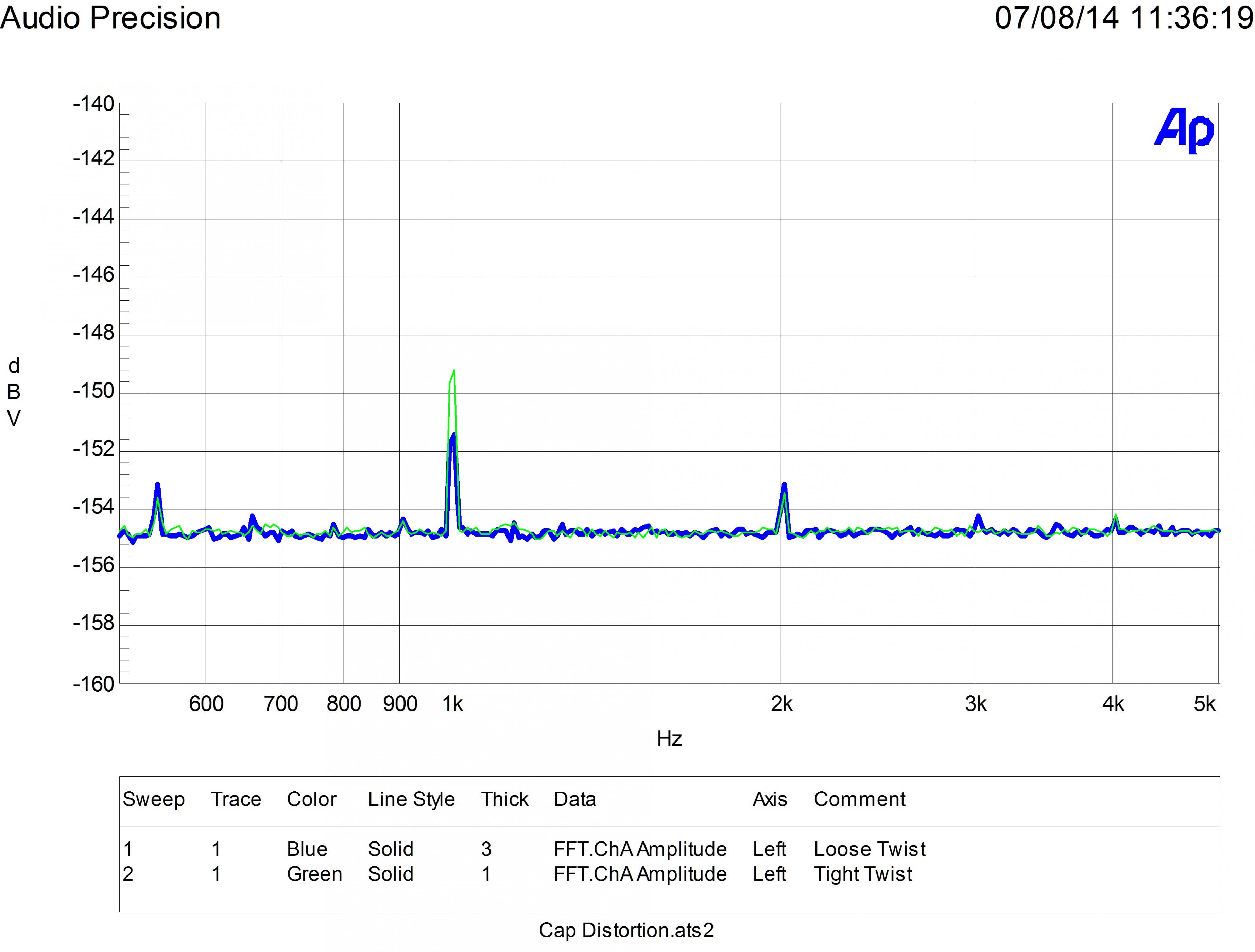

I see where we still are not communicating. The FFT's of the output of my analyzer showed a difference in noise level, but that is more likely the way the circuit responds to what is changing.
So either a few other folks can build similar analyzers or we can try wire that deliberately has added defects. Since the issue of twisted pair cable came up (J.N. you have to use a variable speed drill to get nice twisting. Back when the idea first started the common drill was a single speed AC line powered model and the results could be amusing.)

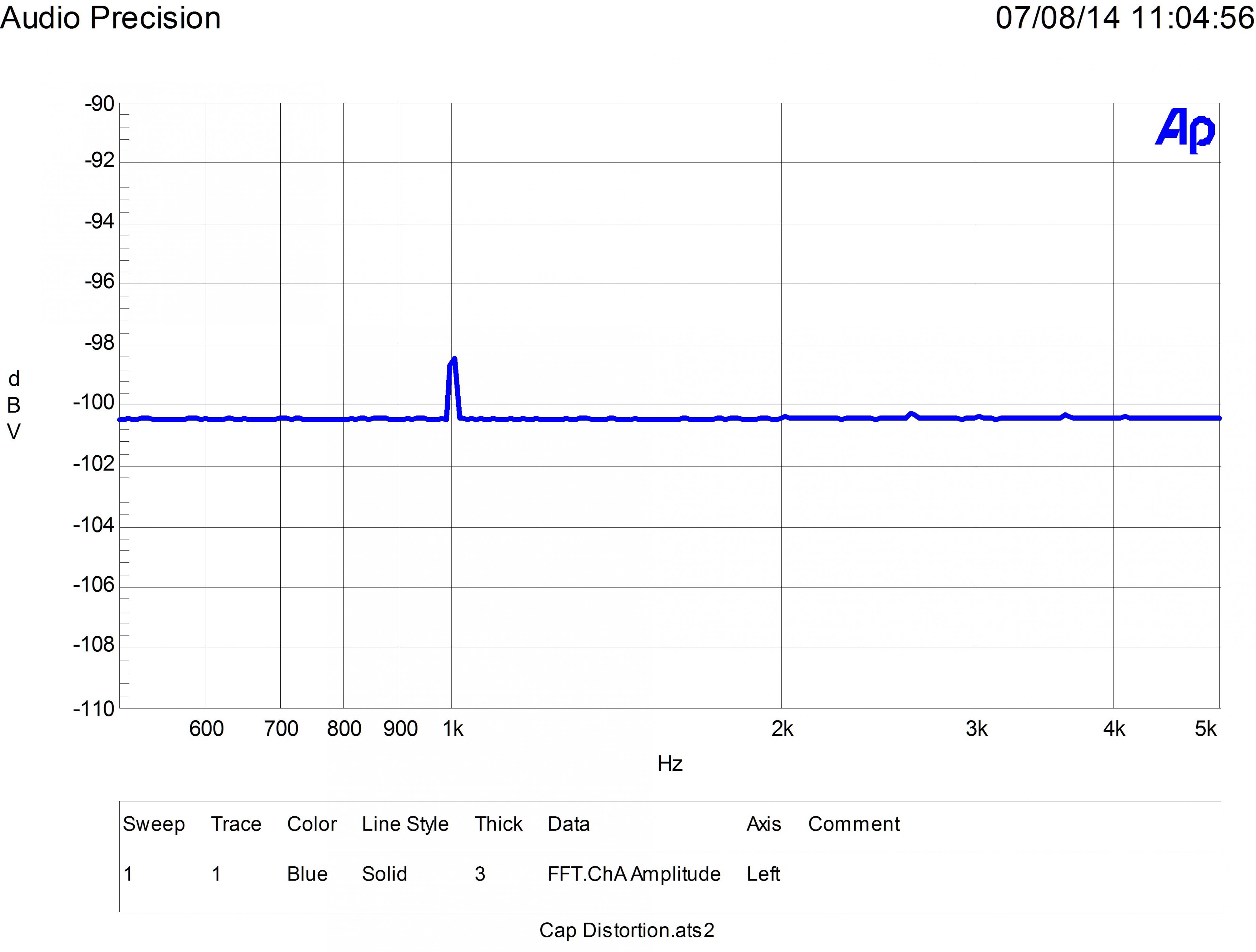

So here are the results of taking ten feet of 24 gauge magnet wire and loosely twisting them versus the same thing twisted as tight as possible, the drill reversed and untwisted and retwisted for a total of five times in each direction.
The high level signal is 10 volts at 19,000 and 20,000 hertz. The low level is 10 mV and has the loosely twisted compared to the tightly twisted. The 0 db reference level is 1 volt. Note both high level and low level test show a 20 db range. The low level is 60 db below the high level.
NO SPECIAL GEAR WAS USED. This is a simple test many can repeat.

The twisted pair of 24 gauge wire is connected as a balanced jumper from the AP output to the input. It is 50 ohms out and moderate impedance in.
The 1000 Hz on the loosely twisted pair is the same as with a normal mic cable jumper and is probably the residual of the AP.
Yes the resistance will have changed. Do you think a change of a few milliohms would have that effect? It is interesting to note the distortion is lower at a high level signal.
I did two before and after sets, and two just afters, as the befores were all the same. The more you torture the wire the greater the 1000 Hz spike. It is also easier to remove the insulation after the mega twist.
The issue is does something funny happen at low currents due to defects in the wire. So if you try it just be sure to really mangle the wire and use a high impedance A/D input. The source resistance should keep the noise level down.
Please let me know if you have any other questions. I think you will have fun with this.

A bit confusing is the color scheme what is blue is the first run the second is green. So what is blue on the high level plot is green on the low level one.

The idea is to get the current into the wire as low as possible. At higher current I think the defects are less important. If you like you can terminate the cable with a resistor and I would expect the distortion to drop. My theory says that you can go to great lengths on reducing cable defects or raise the voltage and current so they don't matter.
I first loosely twisted the wire then while twisted connected it to the measurement system. As it is a long loop I fold it in half and roll it up on my hand and then twist it to stay in place. After two test runs I then torture it and retest it the same as before. The twisted pair makes for a nice balanced test cable to reject much noise. The results shown are 1024 averages of the FFT.
Yes the signal is barely above the noise, but it is repeatable in my setup and at a much higher level than a decent cable should provide.

If you note at high level the distortion is just under 120 db down from the excitation signal. It is just under 110 db at the lower excitation level.
