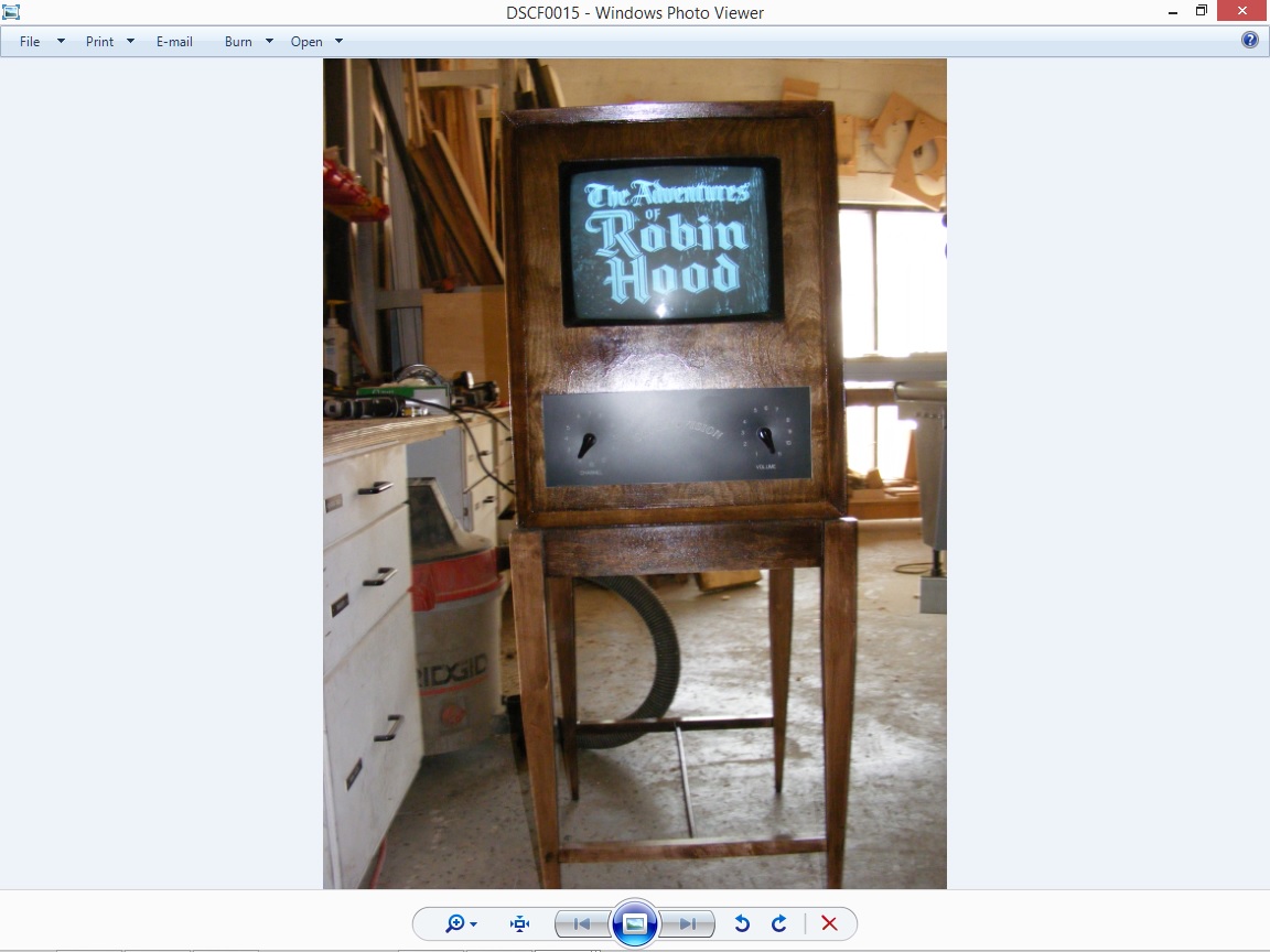

This is my latest project a 1940's style black and white television. It only gets old TV shows.
