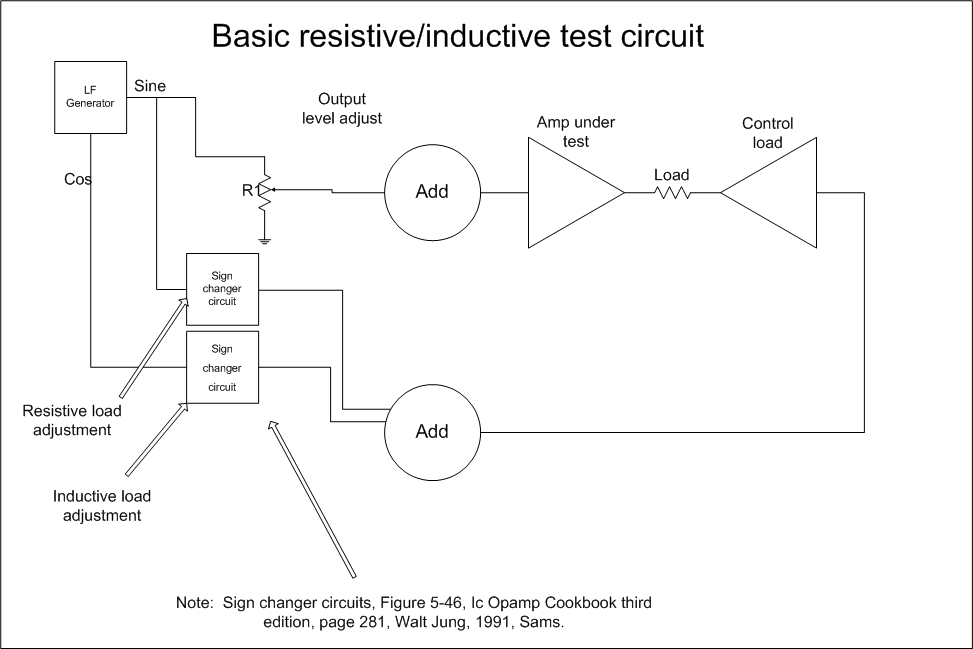

ps..darnit, I was trying to post the active amp test circuit block diagram I used to test amps, it's not in this computer. I'll find it later and post it if anybody's interested.
AHA! found it...
The basic theory is this: by inverting the signal to the control load amp, you can adjust where the zero voltage of the load is. If the signal is zero, the amp sees the load directly. If the signal is equal and opposite, the test amp sees half the load impedance, the center of the load is forced to zero. If the signal is equal and same sine, the test amp sees no current draw, or infinite load impedance.
The same applies with the cosine fed to the control load. The cosine signal causes the control amp to draw or force current from the test amp, so is useable to vary the load phase shift plus or minus 90 degrees.
This can be used easily for single tone testing, basic bog stuff... Or, you can drive hard LF into the load, then inject a lower level hf signal to see what the amp does to the hf signal in all four quadrants of test amp operation. Remember, if the load is a pure resistance, a two tone test such as this will remain in quadrants 1 and 3, whereas the LF inductive load forces operation in all 4 quadrants.
Exercising an amp this way is more consistent with how we use them in the field..
Edit: I sent this to Jon Risch back in march 2007, but do not know if it was adopted at Peavey.

AHA! found it...
As if there is not a track load of jn stuff to check, there comes a new one (as usual, I don’t understand a word from this but I’ll try again…)
Let's smoke together that long pipe 🙂
