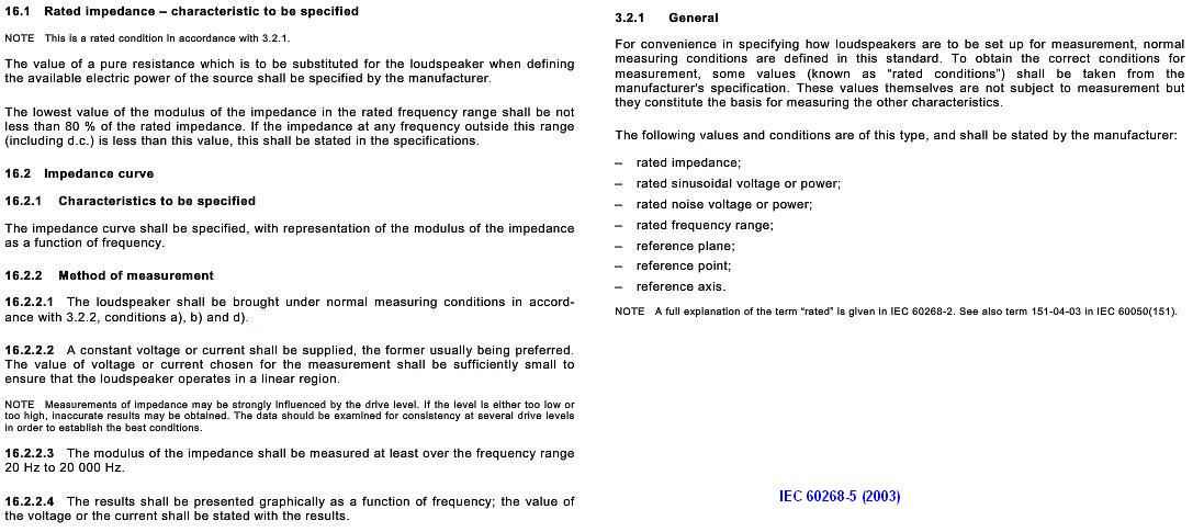

The statement about impedance is from the AES standard. A loudspeaker's rated impedance is twice the minimum impedance.

It is not in AES2-1984 (r2003) (*)
In ‘Sound System Engineering’ by Don Davis (2nd Ed.) it says: "Normal specified Z is the lowest reading just above resonance of the device"
At an online source Ι read: "Rated impedance is 1.17*DCR"
Nothing in old text books (H. Olson, L. Beranek)

(*) It only asks specifying "Zmin to a stated tolerance and the voice-coil temperature at which the measurement was made.) Normal practice is for this measurement to be made at 25 ± 5 °C."

The current AES2-2012 defers to IEC 60268, if you PM me an email I can send you a bit more, but it can't and won't fit here. (IEC-5 now says "The lowest value of the modulus of the impedance in the rated frequency range shall be not less than 80 % of the rated impedance. If the impedance at any frequency outside this range
(including d.c.) is less than this value, this shall be stated in the specifications.") Note it now includes DC! So this fall when we meet again, I'll see what people are really doing.
Thank you Ed.
I found the relevant paragraph on the web. Max difference of 20% is logical and acceptable.
Today I was searching in the “AUDIO Annual Equipment Directory” from 1988. There were indeed many speakers with Nominal Imp/Minimum Imp 2:1 ratio (almost all of USA origin, why?)
