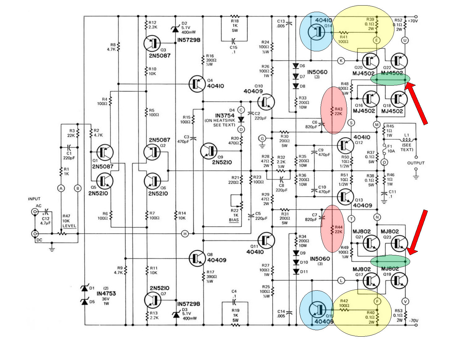

edit: here's the protection circuitry of a tiger 250. The yellow and blue hilite the current sense circuit, it clamps the drive to the upper and lower output pairs. Note the pink 22k resistors, they are the foldback part, if the output is further away from a rail, it reduces the drive to the transistors of that rail.
However, there is a severe error in the schematic as provided in the initial builds. Note the green hilited jumper between emitters Q16/18 and Q21/23. That jumper prevents those transistors from sharing properly, so slight mismatches there will cause runaway. If you own one of these puppies, make sure those green jumpers go away.
pps..almost forgot, the resistor across Q16 and 21...make them 200 and put another pair at 18 and 23.
JN
