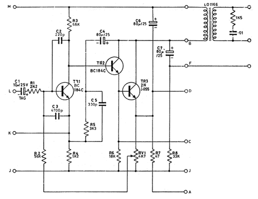

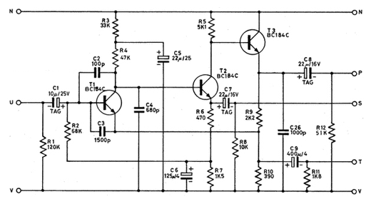

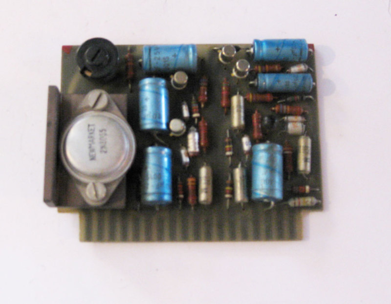

Are you sure about that? Take a look at typical gain modules by him (his company?) from that era. Caps usually are tantalums or axial Philips types.
There's plenty of information about Neve electronics out there. They're sought after by musicians (and modern day fools 😉) because of sonic signature they have. They also get "cloned" en masse.
And, by the way, putting modern caps in place of tantalums is taboo.

A lot of polarized capacitors, all properly biased. Then a lot of band limiting at the input, good local decoupling and robust PSUs.
Not very different from the grandfather's modules 🙂
