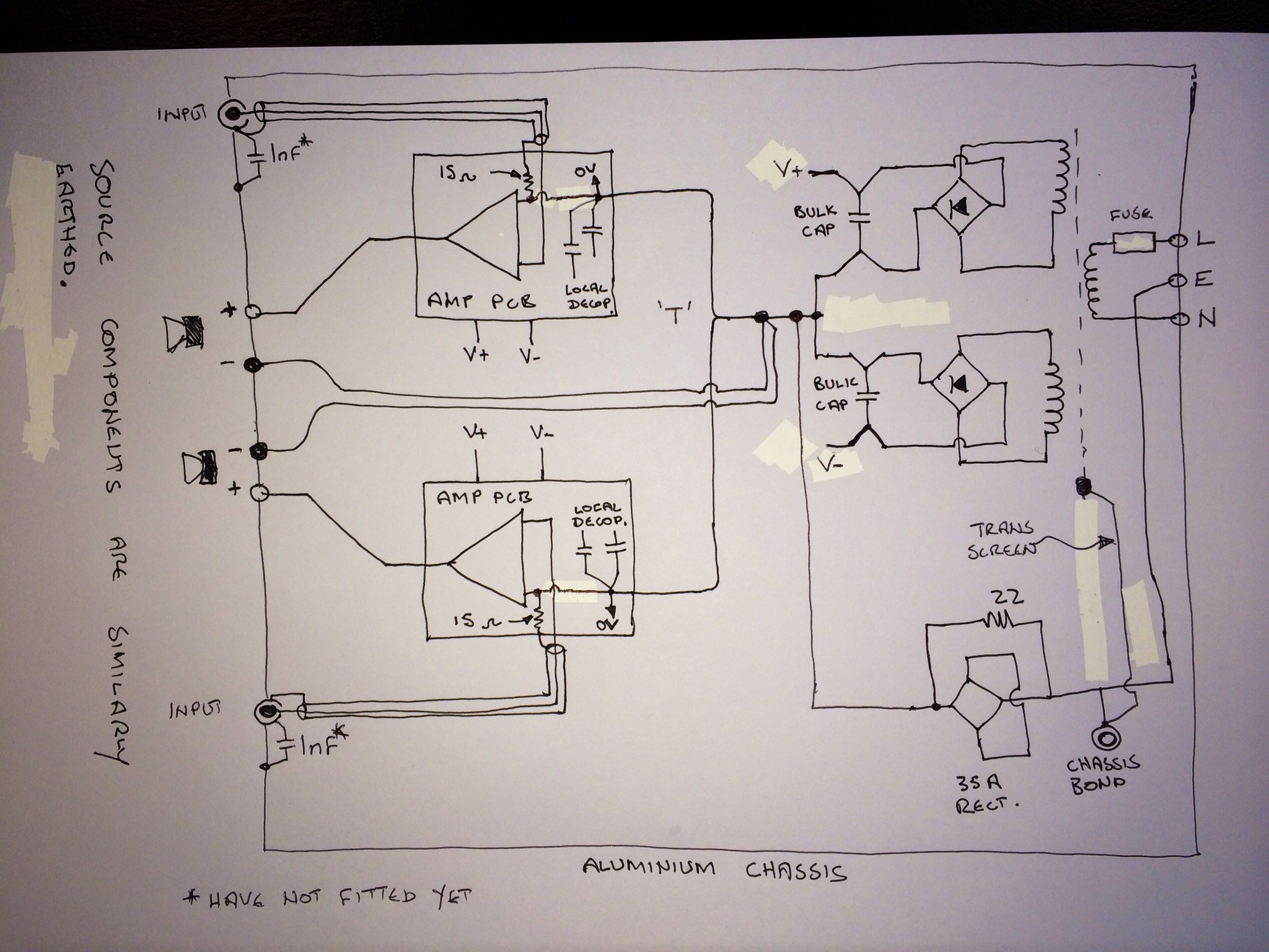

Attached is how I am doing it at the moment. The 'T' is about 1" end to end length
I should add:-
I twist the amp module ground return and supply rails together (I never used to do that)
I keep the speaker return and the +ve twisted for about 1/3 or the length, but then about 2/3rd is not twisted as it is returned to the 'T'
The input cabling is kept well away from other wiring
All transformer secondary's are twisted up to the rectifiers
Mains L and N twisted together
Secondaries and primary wiring kept well away from other cabling.
Only 1 earth bond point on the chassis (located close to IEC inlet)
I have not fitted the input phono socket signal return (i.e. signal GND) to chassis capacitors - I need to do that.

You inserted 15 ohms in series with your signal grounds?? Then cross-couple the grounds through capacitors to the chassis, then have a chassis path through 22 ohms to the electrical GND T. I’ve seen similar configurations used to enhance the L – R element of a stereo signal, though at these values I’m not sure that would have an audible effect in this case, especially if the grounds are common at the source.
The caps (some use lower e.g. 100-200pF) are to connect the shield to the chassis at RF - They have no effect at audio. There is no signal conduction through the chassis at audio.
You can also run an earth connection from the PCB GND back to the star ground (with the 15 Ohm signal ground isolation R in situ), but I do not note any improvement doing this (this method is shown in some texts - with and without the signal GND iso R)
At the values that you’re using I certainly wouldn’t expect any effect at audio frequencies. It was more just a theoretical observation/comment about the configuration and the potential for a different amplifier gain for L + R vs a L – R signal aspect between the two channels; - that is if larger component values were used such that it did cut down into the audio band, and were roughly on the scale of the amplifier’s inverting input’s Rs. The caveat being that the two grounds would need to be isolated from one another at the source (dual mono pre with Transformer inputs). Sorry, I realize this is a lateral from your focus on noise minimization. Probably shouldn’t have even bothered to mention it.
