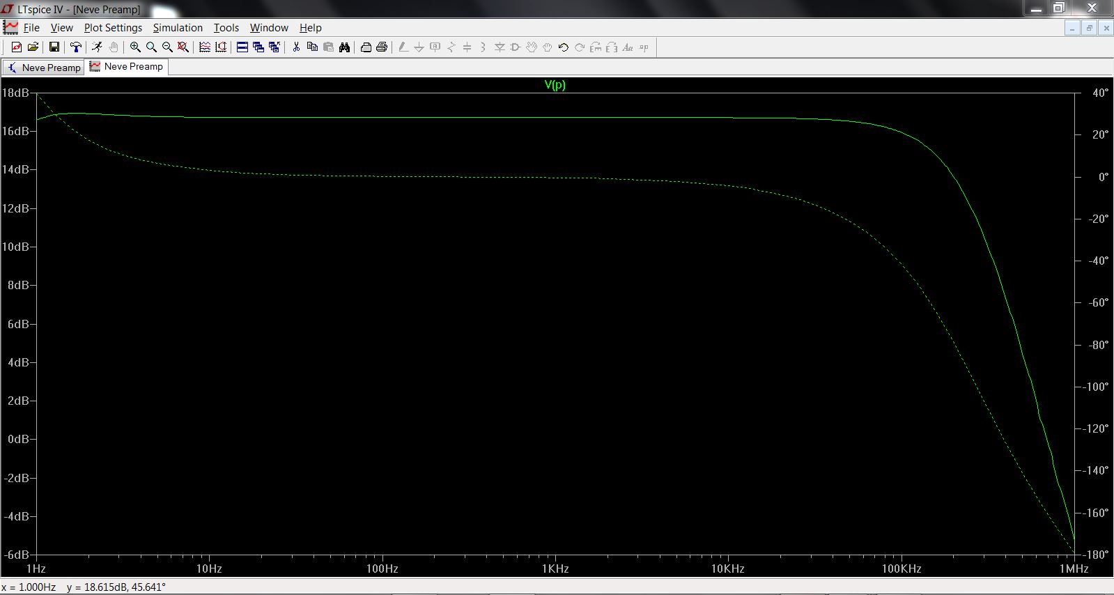

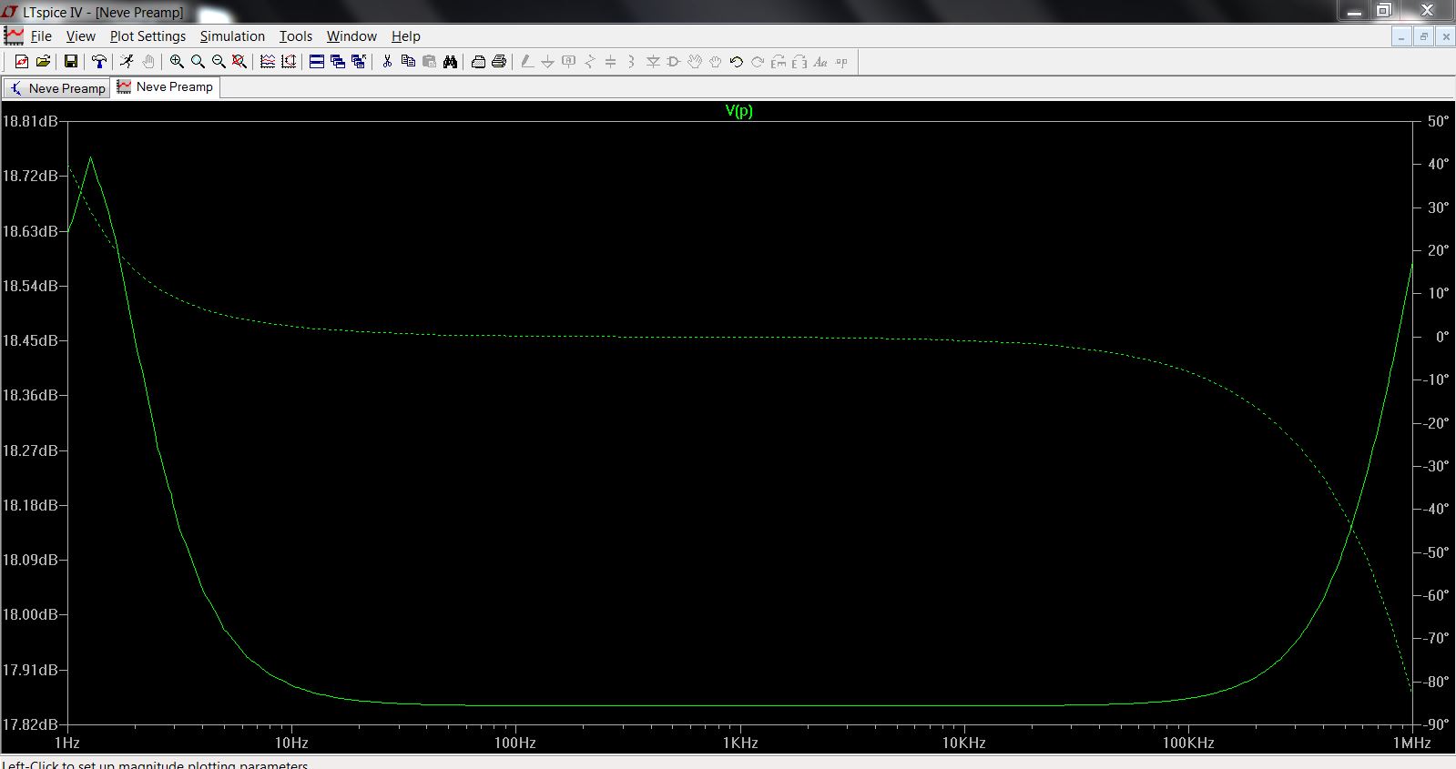

The output of the Neve circuit fed from a low source impedance, and then a more "optimal" 6k.

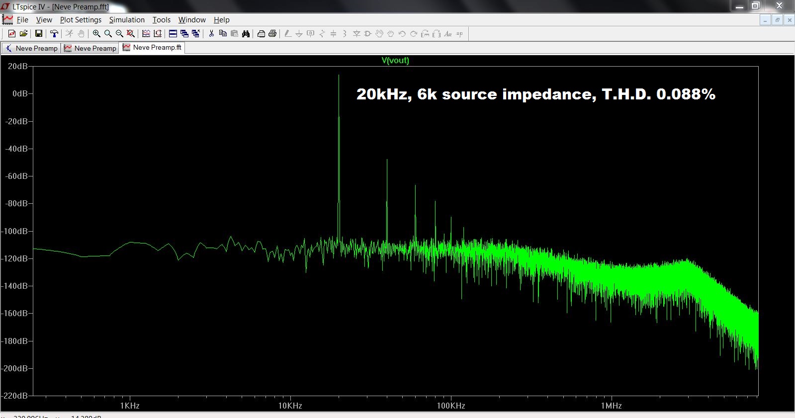

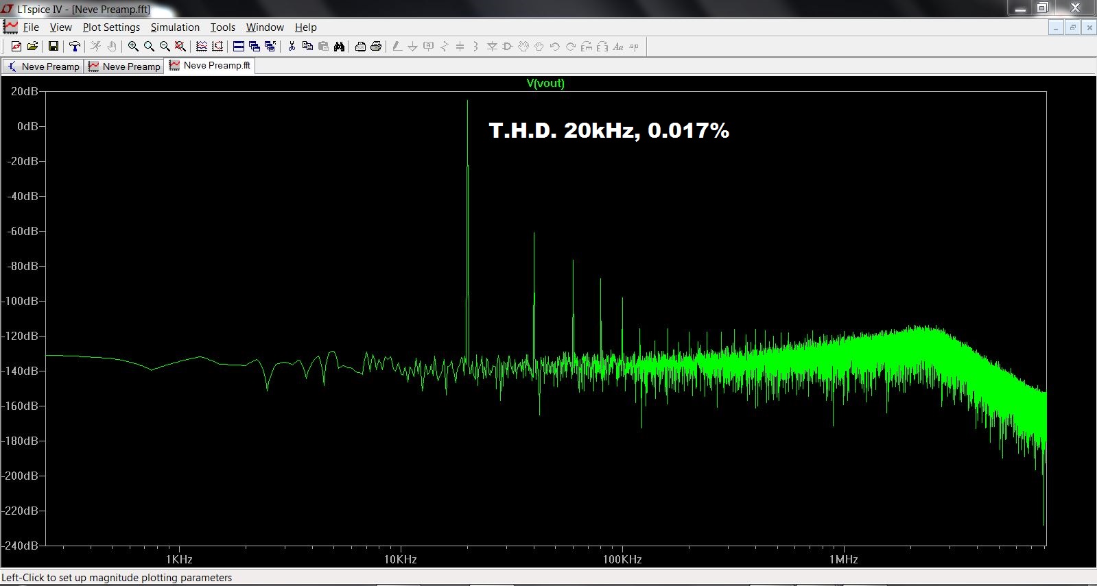

If I have done this correctly then this is the F.F.T. for the Neve at 20kHz with 1 volt input. As I mentioned earlier, the design is critically dependent upon the source impedance feeding it to get a flat response both at lf and hf.
Edit... second image is from a low (1ohm) source.
