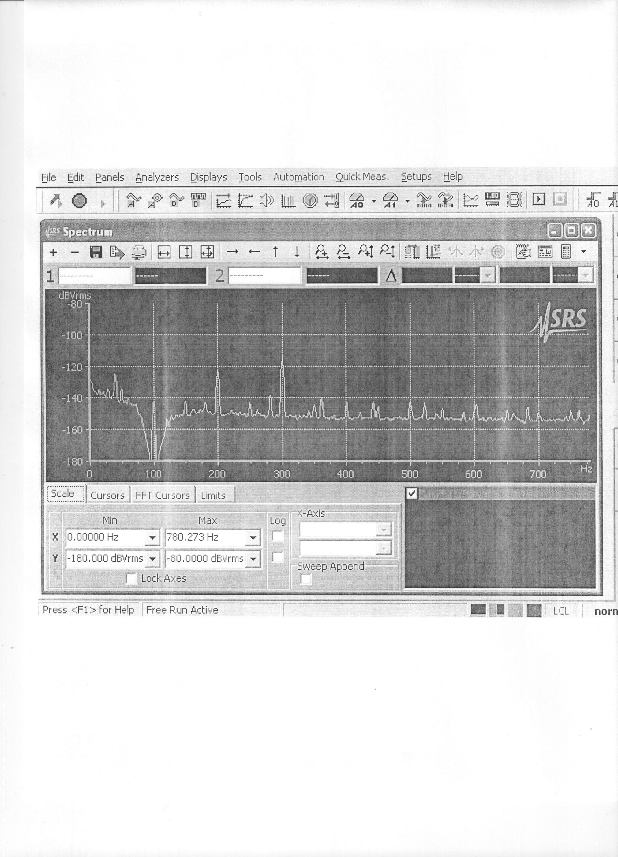

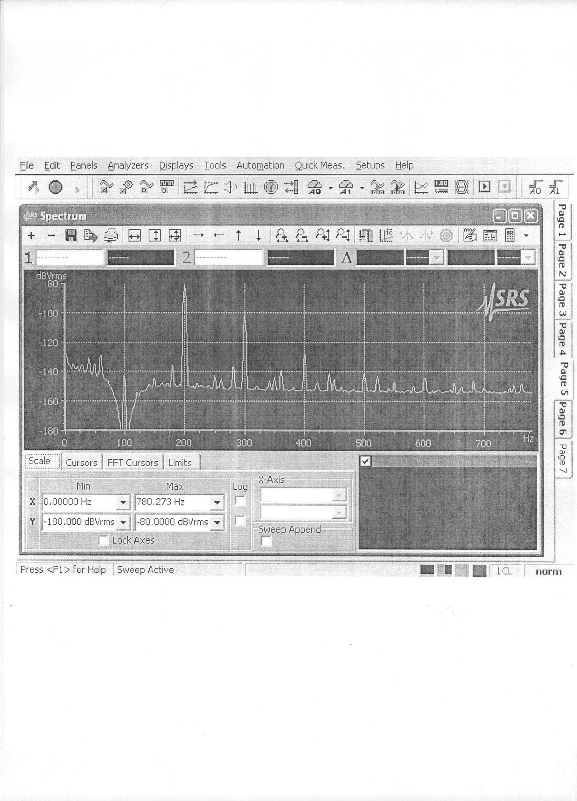

I will give a written description and the results:
5uf Tant cap, 1V AC rms, 1000ohm load, 100Hz frequency.
natural rolloff is 32Hz. If one scales this result, it is obvious that even with a 50uf Tant cap (typical for this situation) would have a similar result with a 10Hz frequency.

Tantalum? Who's using tantalum for coupling caps? Thought the discussion was about film caps. Did you have any DC bias on the tantalum?

Try to use ordinary elyt, not tantalum cap (worst possible selection) . Use "big enough" value (fc bellow 3Hz), distortion in audio band will be -130dB and lower..

Did you know that I discovered that Tantalums are pretty bad, and that I discovered this 40 years ago? I even wrote an IEEE paper mentioning Tantalum caps. Did anybody listen to me then? VERY FEW! But I had measurements much like the one I put up. That makes you guys up to 40 years behind in cap quality. So what to do? MYLAR was tried, even by me, and found to be audible in listening tests. Then what? NOW we use polypropylene, polystyrene, or Teflon in our highest level designs. I do have perhaps 1000 Tantalum caps, what should I do with them? Haven't used them for anything important for the last 30 years.

Yeah, I think it was a bit duplicitous of John to respond to the -160dB figure Scott put out with a -100dB figure, only to find that John was talking about a tantalum cap, apparently without a bias voltage on it.
