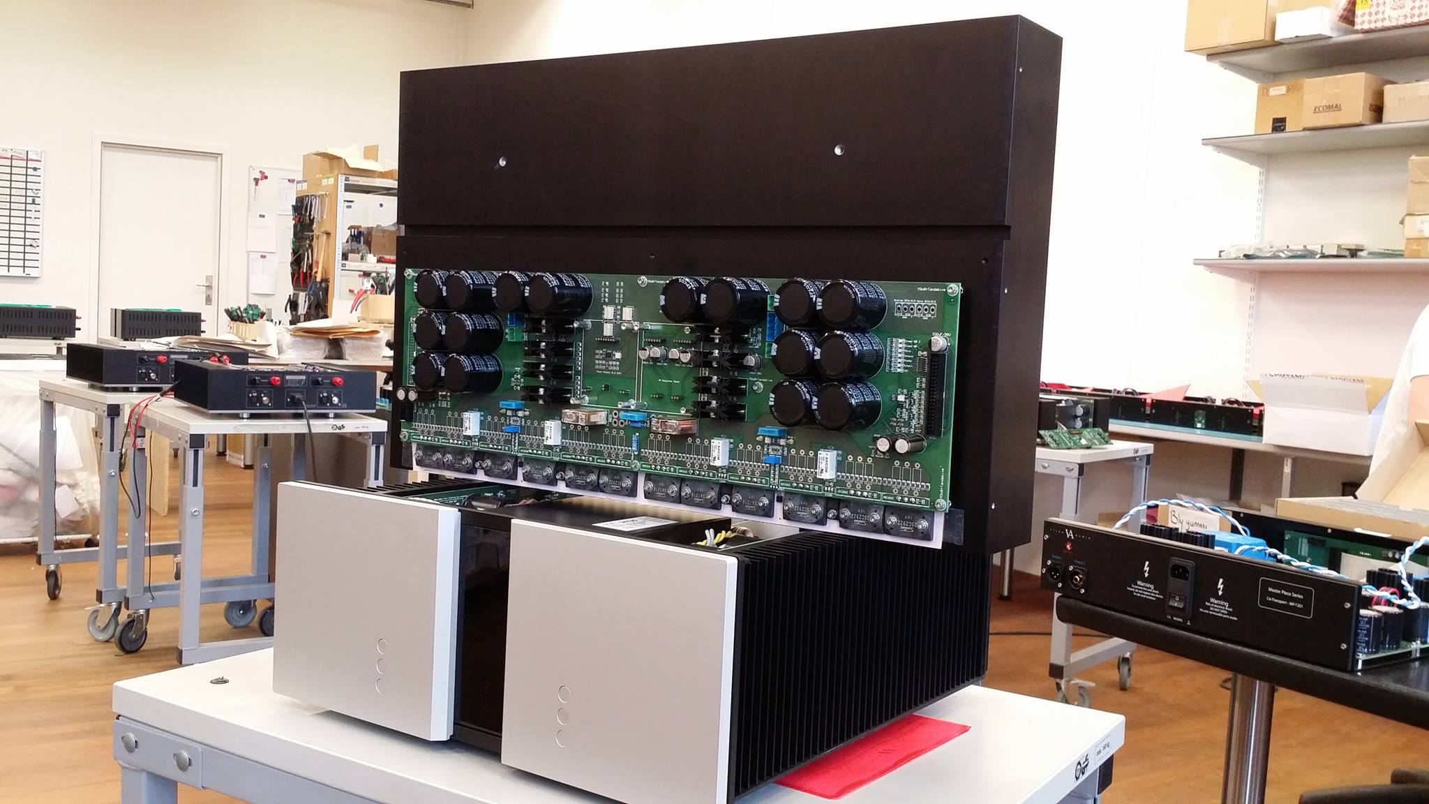

Cool, I'll take one of the 34K euro 100W amps for my DQ10's and see if it betters my Hafler 220's. Chances are I'll keep my money in local real estate.
Every cap, Scott? I just measured one today that measured higher than -100dB. Of course, there is also DA and vibration sensitivity. However, the bottom line is making a successful product, both in measurement AND sonic quality. Because I do both, I am successful at what I design.

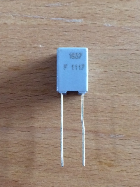

The real tradeoffs here, may as well be lead material (magnetic?) and internal attachment.
Wima may be just as OK, but they do seem to be larger and probably harder to source.
My 0.1uF-MKP-1837s are non-magnetic. Burklin is a good source for Wima including 1%-FKP 2(5mm. LS as well).
34k In Cambridge Mass ? What you buying an Outhouse ...
I heard Classe is now manufactured in China and yet still commanding big $$. Big difference between your DH220 and a vitus, really big ..
