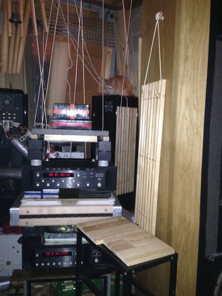

I have moved all my CD's to hard drive, gets rid of a lot of these problems. I would hope that the CD manufacturer would address most of these problems, though having looked inside some CD players (mid range) I was quite shocked at how cheap the construction and PCBs were.
I would though be interested in any research that has been done regarding vibration levels in equipment in domestic situations, as such things as record decks and valves I would have thought are susceptible to vibration?
I afraid, again, sound effects from vibrations are still listenable even if proper sensor can not measure any vibration amplitude.
Saying not for joke, Yuri Makarov was playing with Mark Levinson CD transport and DAC, and reported listenable improvements up to 160kg of total load over CD cabinets.
Of course, he also did his best in inter-cabinets anti-vibration measures.
Lifting up and putting down 30kg weight over CD transport is his routine everyday exercises during listening. At the same time, no any computer-based source can approach CD sound quality, he tested dozens of them.
