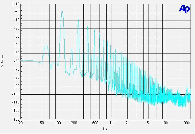

Now as to old camel dung. I have attached an image of the results of a single audio interconnect in the forward and reverse directions. As the investigation target is around 3,000 Hz, most folks can note the increase in noise floor from this repeatable measurement. Dimitri as you can see the cure changes with cable changes and it is "noise" that is the issue so it is not what would be expected from an op amp issue. Scott, note that the test signal is 15 millivolts and the loop area is a meter. Testing capacitors at a few volts is a much easier task.

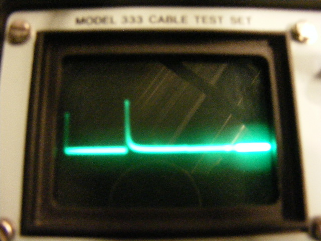

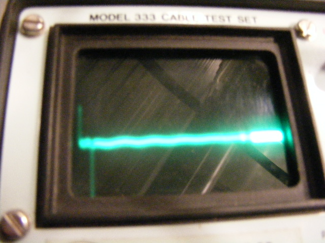

Now next up are two Time domain Reflectometer images. A TDR quickly inserts a charge into a cable and then looks at the voltage vs time. As you can see on a shorted cable after a brief delay the voltage drops below the zero level as the charge that went out on one conductor is returned on the other. In the other image the charge takes more time to return and it is not inverted as it returns on the same conductor. NOW during the time the charge is propagating there is more charge in the cable that at rest or equilibrium.
I have tried to explain why I believe at low current levels charges do not propagate the same as at higher levels due to the decrease in intercharge reaction from the inserted charges. My opinion is that is why there is varience in the actual charge transit path, which cause a variance in the current flow and shows up as noise.

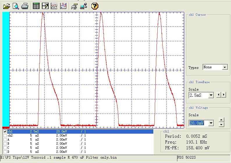

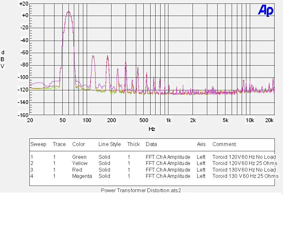

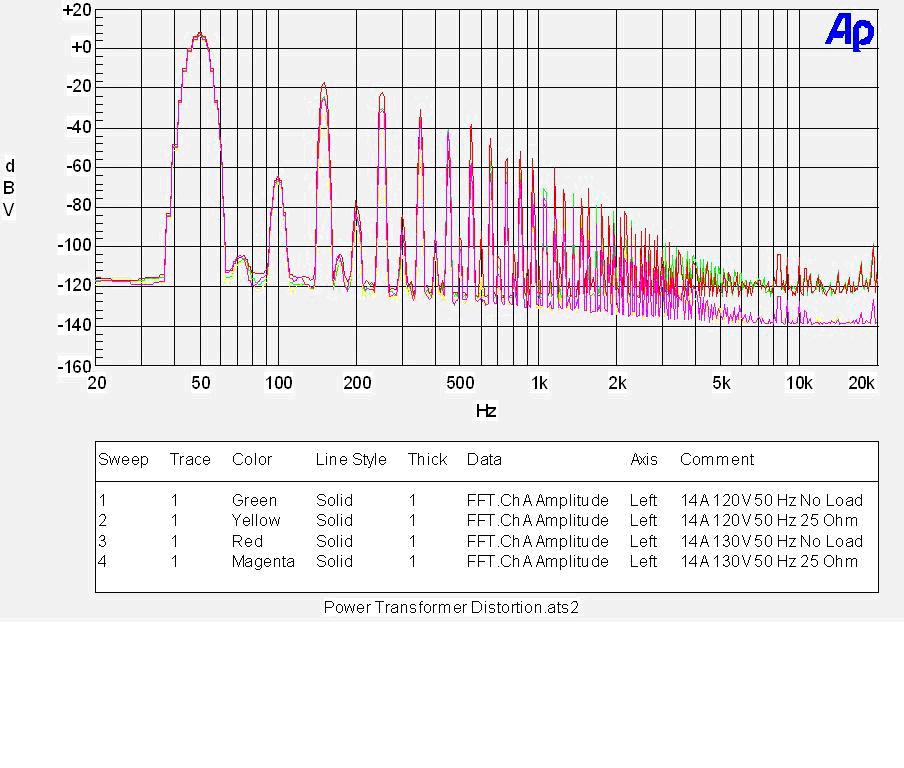

Finally the argument over power transformer size. The first issue is what are you powering? A power amplifier has a voltage gain of maybe 30. Jan's preamps probably only need a gain of 1! However John's phono preamps require a gain of 1000 or more! So what you are powering is a big factor.
Now for power amplifiers an 8 ohm loudspeaker may have a minimum impedance of 4 ohms according to the standard. It will also have a back EMF. In a very efficient loudspeaker this could have enough effect to again halve the minimum impedance. However in real loudspeakers this would be a maximum of another 30%. So if you size your power transformer to drive a 2.8 ohm load you should be fine.
Now if you look at the transformer noise images you can see that small power transformers have cores that are driven farther into saturation than larger cores! That is because they are able to dissipate heat a bit better than larger ones. So when you up size the transformers you get less distortion. They also tend to have less line noise coupling. Now I also show the conduction angle for large and small transformers. A large transformer lets less line noise in than a small transformer.
Now there are other techniques I have show to reduce common mode noise by using four secondary windings.
The conclusion is that larger transformers do have a place in high gain audio circuits. (The wise may look at using a 240 volt primary on a 120 volt line with four output windings!)
By " 4 windings " do you mean 2 / channel ?
Right about the 240 V primary
( remembering to maintain the current capability of the secondary )
I'm glad you say this is your OPINION. It makes no sense to me and has nothing to do with the process of conduction in a metal like Cu, Ag, Au, etc. If you continue to choose not to reference any other source for this opinion then there is no talking point.

None of this has anything to do with conservation of charge, violated by Ed's comment. A pulse propagating on a transmission line is not a packet of charge.
Thank you Simon, but the cable can filter 100kHz in different way (depending on direction)
