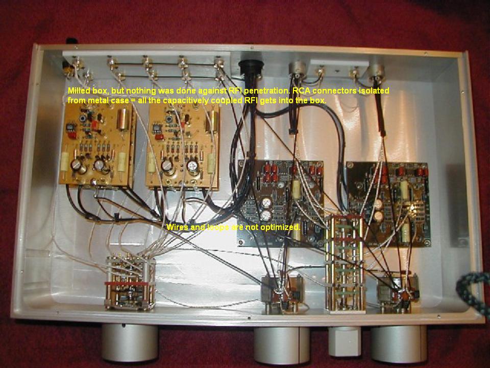

Sneak peek of the CTC Blowtorch with Vendetta.
I am sorry but I am not impressed, as there are many violations of proper HF design. My comments in yellow characters.
A reminder of design differences. These are two different phono designs that do almost exactly the same thing, but one is discrete, the other IC. The discrete unit is about 6dB quieter. They sound somewhat different too, even though they may use the same EQ caps and resistors.
I'm not surprised, was the IC layout an DIY layout. its far from optimal, it hasn't got any planes just disjointed copper pours connected by narrow high impedance paths, just from a basic EMC point of view its dodgy.

Tight twist with gnd wire for all internal wires (or shielded?), box grounded how?, RCAs grounded (to where?), RFI filters (res in series, cap to gnd) on all inputs, etc ...
PS If you use yellow text, use one with a black border: "... wires and ??? are ..."

Some might say it's smarter to check out the guts before making the buy.
