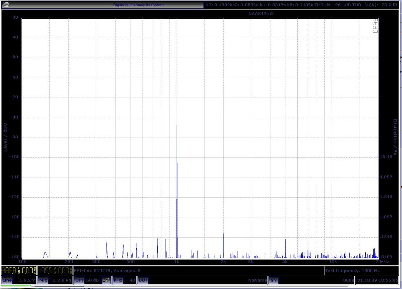

I measure. This is the resolution floor of my ( old ) equipment, 5 years ago.
I published it on my MPP thread in the beginning.
That was a selected DAAS Analyser with intersected 24 Bit converters.
Today -160dB is posible, with a lot of averaging.

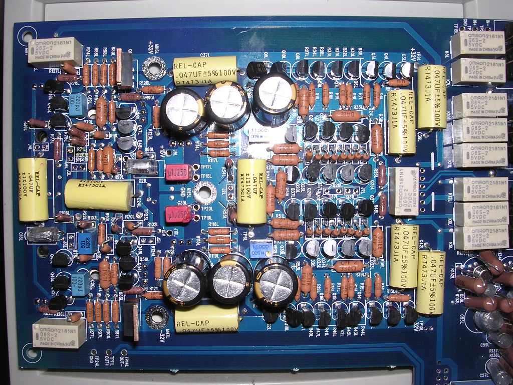

In the beginning of the MPP thread i made an MC Phono input stage with AD797.
I configured it as an instrumentation amp with several AD797 in parallel at the input.

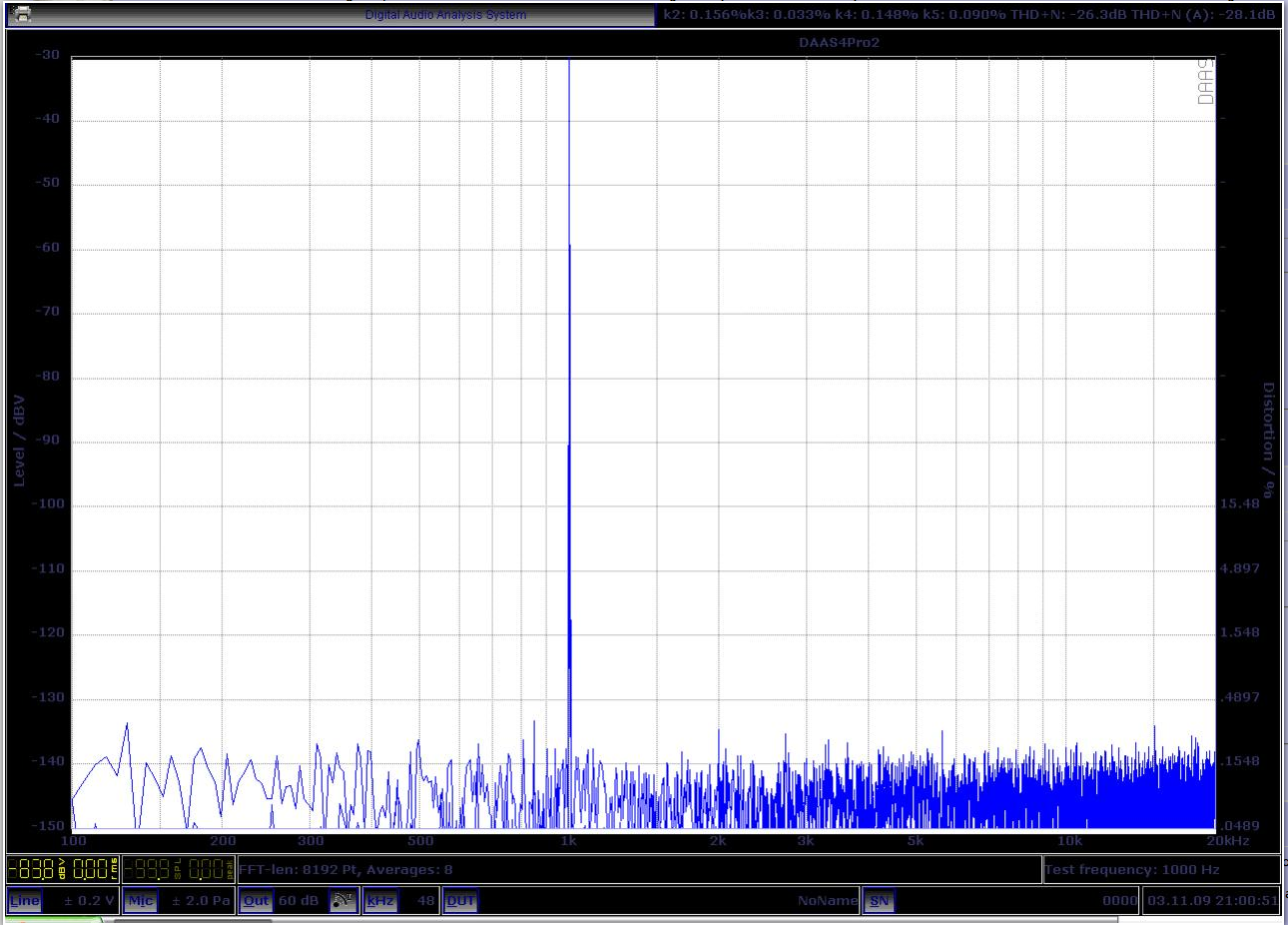

This is a simple 1kHz harmonic measurement at -30dB ( ca. 33mV output ).
Besides the slight increase in noise i could find NOTHING.
No PIM, no IMD, no inferface distortion, no TIM no nothing !!!!
Mission acomplished. Why did i not close the thread ?
