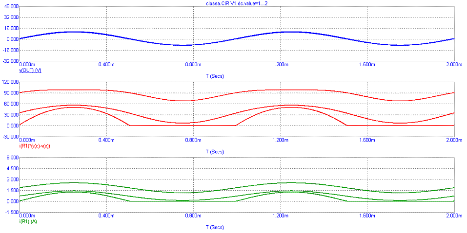

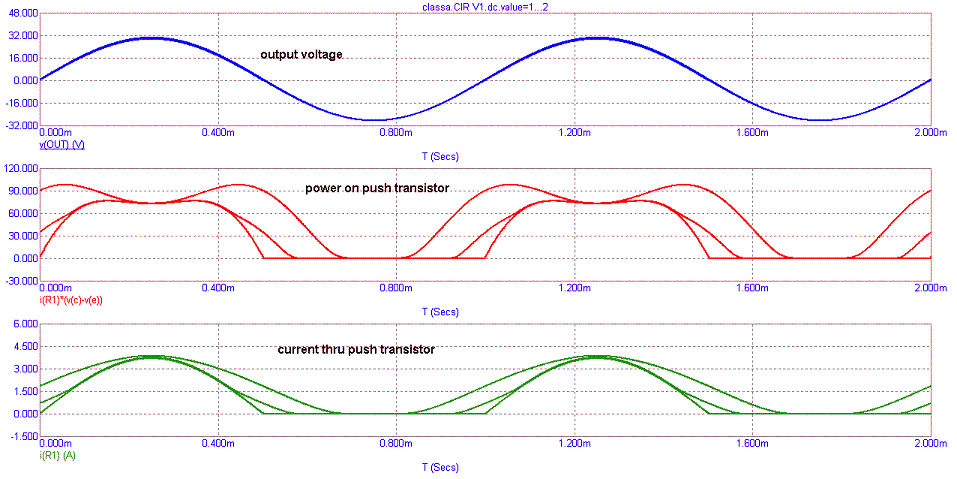

PMA said:Same for smaller output voltage. One can see that at higher idle the power dissipation approach to a constant, or at least fluctuates much less than in a class B.
Hi PMA,
Thanks for showing this. This is the point I was making in Post 452.
BTW, an interesting side note is that this tends to be synergistic with MOSFETs, where gm doubling basically cannot happen. Bias them nice and toasty and they will have very little transconductance droop, a gairly large class A range, and rather small deviation of power dissipation as a function of output power. The price, of course, is higher quiescent dissipation.
Bob

AndrewT said:Bob,
I'll try again.
Using your 20W as a medium term output from a 200W amplifier, we can expect many seconds even minutes operation at the 2W (-20dB) level.
This output will fall to tens of milliseconds at the 20W (-10dB) output level and for a 200W amplifier that has a 2pair output stage is just 5W per device. I can't tell you the device dissipation since that will depend on the load reactance, but I could estimate it will be of the same order as the output power. The devices will dissipate on alternate halves of the overall cycle and thus have cool down periods between half transient.
The short term transients should last just a millisecond or so and hopefully they will be short of clipping.
It's on this basis that I suggested that PMA's posting show a power dissipation that is likely to indicate temperature variations that are worse than what happens in an amplifier reproducing music.
I am not specifically referring to change in bias conditions nor how the bias compensation should work. Just variations in output device junction temperature.
I do however support PMA's contention that the higher the bias, whether optimum or higher, helps swamp out deltaTj with variations in output power that follow normal music waveforms.
Hi Andrew,
I'm not sure we're really disagreeing here. My main point was that we should not underestimate the amount of variation that can occur in junction temperature as a result of program power variations. It is certainly true that the heat sink has a long time constant, but such program-dependent variations in junction temperature will occur even if you bolt the output transistors to the Brooklyn Bridge.
It is certainly true that the extent of such variations depends strongly on the nature of the program material and how loud it is being played. Hopefully, our amplifiers will sound good with all kinds of program material. Consider the 1812 Overture, with extended periods of high program levels followed by very soft levels and vice versa. Consider also other material that might have bass notes that drive an amplifier to 1/3 power for over 100 ms, where output stage dissipation may be near maximum.
A simple 100W/8-ohm amplifier with 45V rails might have output stage dissipation of 10 watts quiescent and nearly 50W at 1/3 power. That's quite a swing. Such an amplifier might typically employ two output pairs.
Junction temperature variations do have consequences, and those include possible intervals of over-bias or under-bias.
Bob
