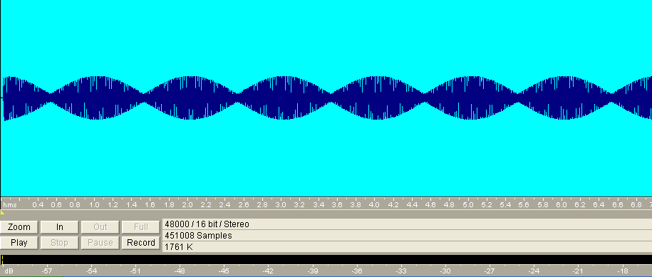

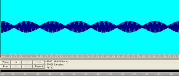

Try multitone signal 50+51Hz (beat 1Hz) with 0dB and 10k+11k with -10-20dB relative to 50+51Hz. Observe only IMD products 10k+11kHz(1kHz...), When driving amp with this signal just under limit, power is cycling from 0-100% with 1Hz, so IMD products cycling should be visible..You can try e.g 50+50,2 Hz as "base", so thermal cycling is with 5sec period.

Have the signal, but see nothing special in a FFT.

BTW, the test signal is periodic ....
If you use music with 60 BPM, it is also periodic cycled in power..But serious, if 1 or 2 seconds period between 10% and 100% power (with 10+11kHz present)have no (visible)impact on sidebands (9,11kHz) and 1kHz IMD (with properly constructed and biased amp), how can it be hearable?
BTW, you should use no averaging and FFT e.g. 4096 or 8192.
With underbiased amp i can see so with sugested signal sidebands "pumping" at levels between -120 to -110dB , peaks 10+11kHz at -20dB, 50Hz components peks at -6dB on spectra. Power is cycled from 1W to 100W..But is it from termal effects? Sure not.
