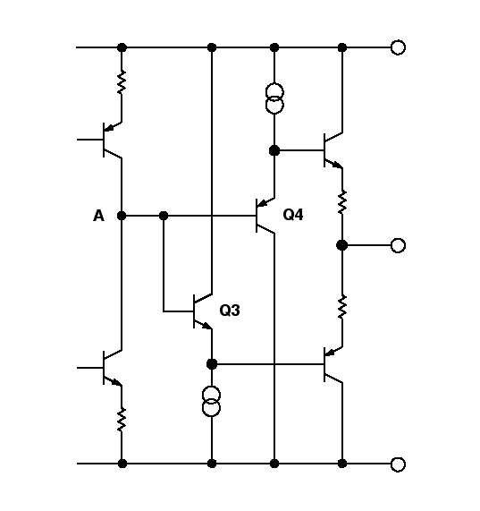

OK, question to those who have more experience in the field..
Is it possible in 'real life' to drive either Q3 or Q4 into saturation in the schematic shown? Conditions: +/-15V supply, closed loop gain of the 'opamp'=3 or so.

Depending on current level check for quasi-sat on the datasheet, otherwise there would not be much of a problem. Quasi-sat is when there are two breakpoints in the output resistance characteristics.
