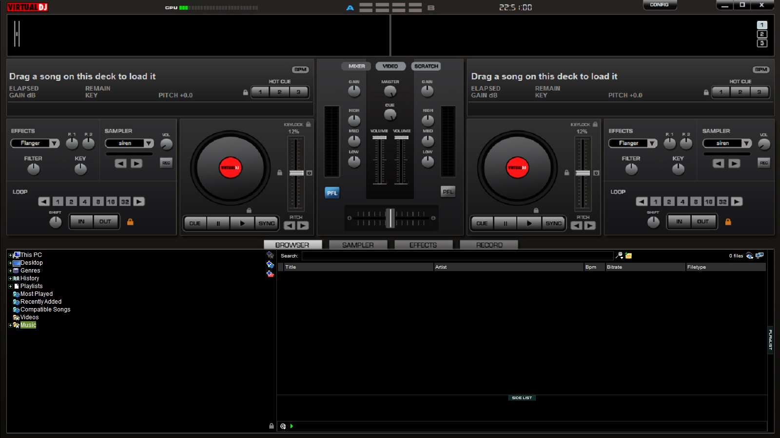

Hi Frank, I recently discovered this VIRTUAL DJ SOFTWARE - Download VirtualDJ Home FREE due to a DJ friend obtaining a dedicated hardware controller for this DJ software.
The thing I like about this player software the ability to instantly and seamlessly crossfade between two 'same but different' recordings.

Edit: Of interest to Dan, I've downloaded that DJ software he mentioned,and it's a no-go at the moment: the interface is brimming with eye candy, the CPU is working hard to keep all the fancy dials, etc, spinning while playing the track - and the SQ is walloped badly, for me. If there is a way of dumbing down the interface, to get a lift in quality then it may be a goer - at the moment, not a chance, sorry ...

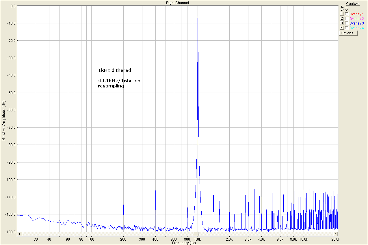

It may be a question of the DAC used. My external DAC works perfect with 48k and 96k sampling, for the reason of the clock frequency used. For 44.1k and 88.2k it uses internal HW resampler, which is horrible (it creates plenty of artifact spectral lines). You can easily find it by measurement and measurement is the best proof here. To get the best result, I set foobar resampler to 96kHz and ultra mode, instead of using HW resampler in the DAC box. Then I get the best possible result both by spectral measurements and listening. Listening is nice, but tuning by listening only may be misleading and not shooting on target.

I Always Wanted To Be A DJ....
Hi Frank, Ok, I'm running a Toshiba 18" laptop, WIN 8 Pro 64bit, i7 processor, 8Gb Ram etc, into an Edirol UA-25ex USB audio interface.....so no processor speed bottlenecks in this case.
What system/OS are you running at present ?.
I will try some listening (an excuse to get the Stax rig out :sing: ) on a few different media player softwares and see what gives....if I can pick differences, I'll let you know.
The KB shortcuts (wireless KB/Mouse.....Kmart, $19.00) that I have set up in Virtual DJ allow me to start both decks together, and then flick the crossfader instantly between the two tracks playing (Z/X).....no momentary mutes or glitches whatsoever.....another KB shortcut to rewind both tracks to beginning (M), another is Play/Pause (Spacebar).
Ergonomically this KB shortcut arrangement works particularly well for me for comparing two similar recordings, in this case comparing recordings of the same but temporarily physically modified interconnect (loopback) cable.
Being able to instantly and seamlessly switch between tracks helps immensely with quickly identifying and characterising very fine audible differences.
I have not found any other software that gives me this ergonomically perfect KB functionality, combined with glitch/mute free changeover.....Foobar ABX is a complete fail in this important respect.
Advice of other suitable/capable media player softwares is welcomed.
