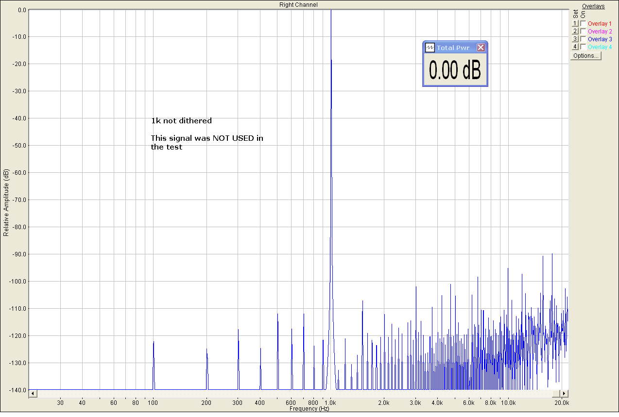

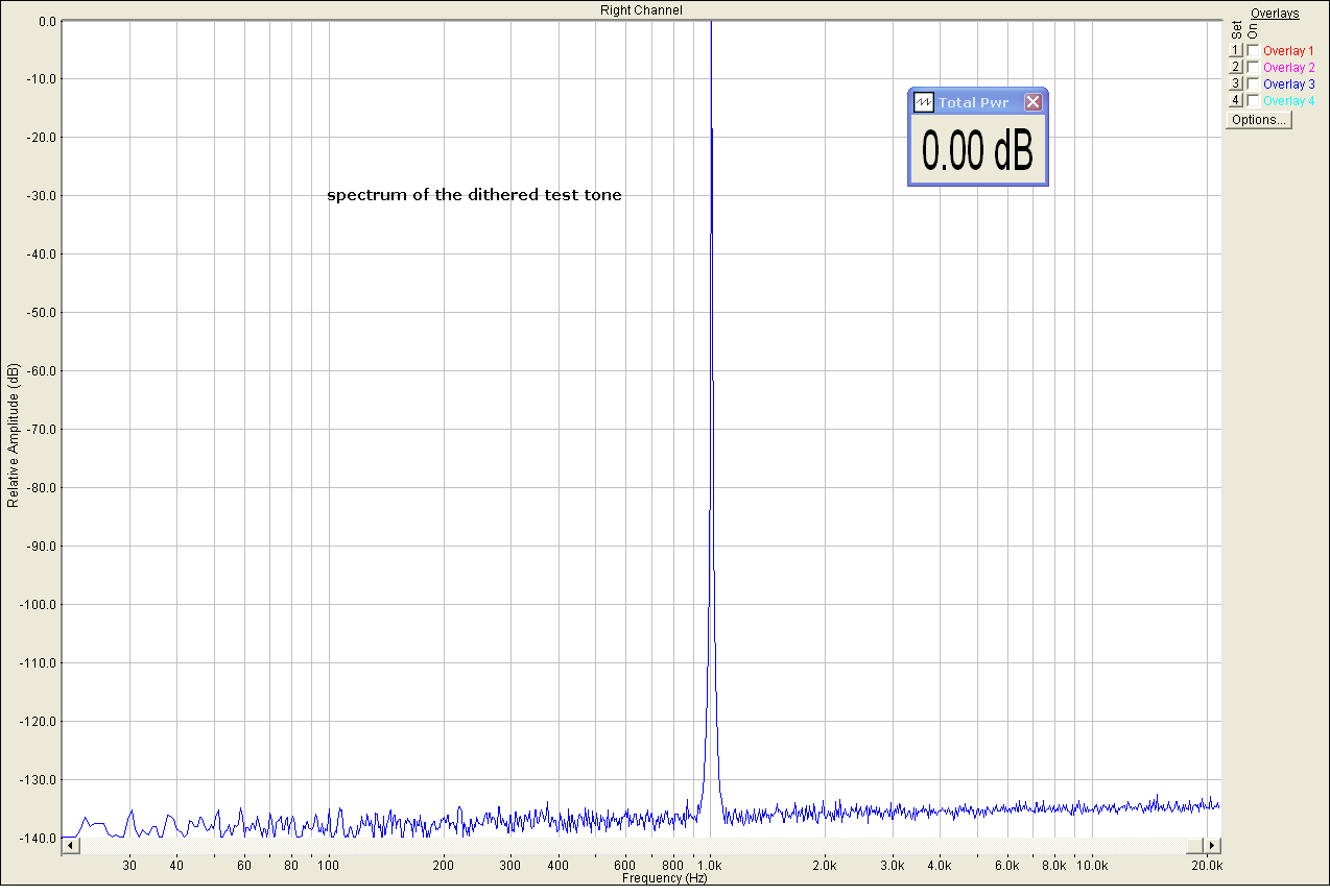

PMA any idea of where the sub-harmonic tones come from and if they are "there" in the original why would resampling make them go away? In a mathematical sense TPD dither applied to 16bit -6dB sin wave has no tones visible in 64K FFT.
HW resampler (DAC board), as I already explained. Original 1k test file is TPD dithered and clean. HW resampling (probably not dithered) makes that forest of spectral lines. As you know, spectrum of undithered 1k looks very similar. As I explained, DAC works only at 48kHz multiples for the reason of clock used and it resamples 44.1kHz.
Please do not ask me if i used the dithered tone for the test. Yes, I did.
All, please do not ask more trivial questions about dithering, at least not addressed to me.
All I want to explain is that if someone does not check his system he may not know what is really happening.
