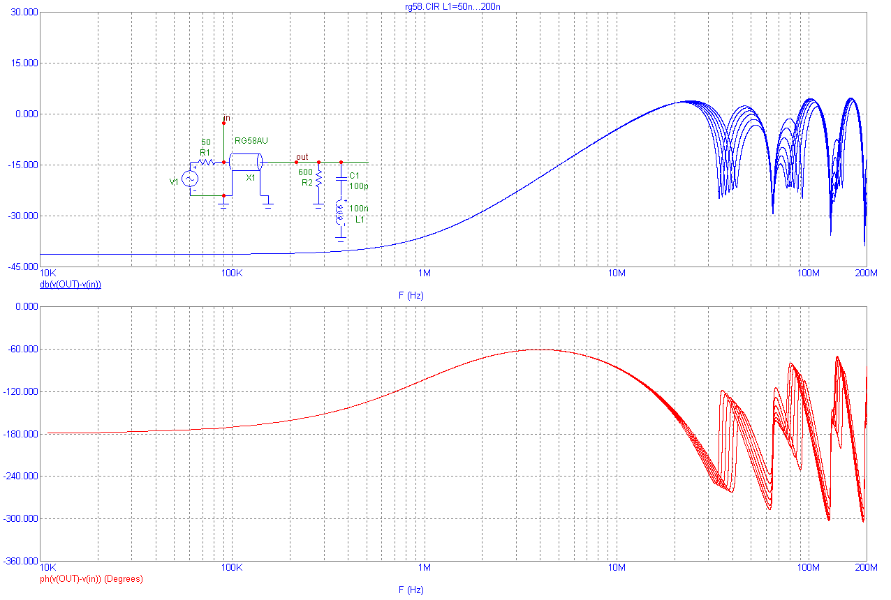

Now, let's look at the test setup. What exactly is the AP doing? Is it measuring the phase difference between ends, or relative phase between lf and hf?
How does it respond to the termination mismatches at both ends? Remember, we are talking audio band here, and the line impedance AND propagation velocity are both frequency dependent. How does the AP respond to a transmission line delay?

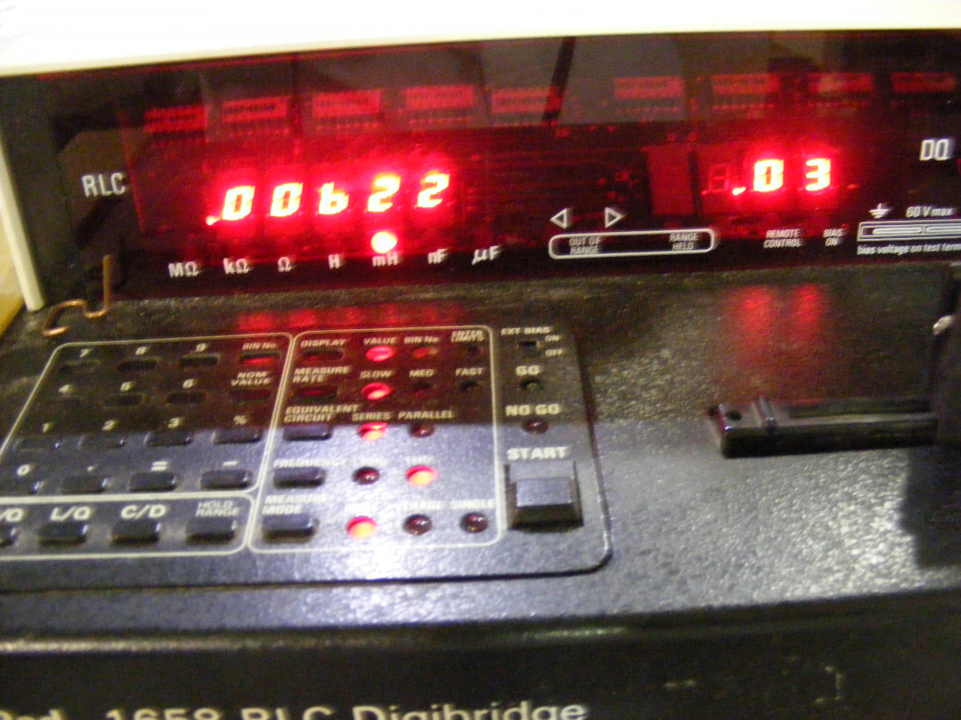

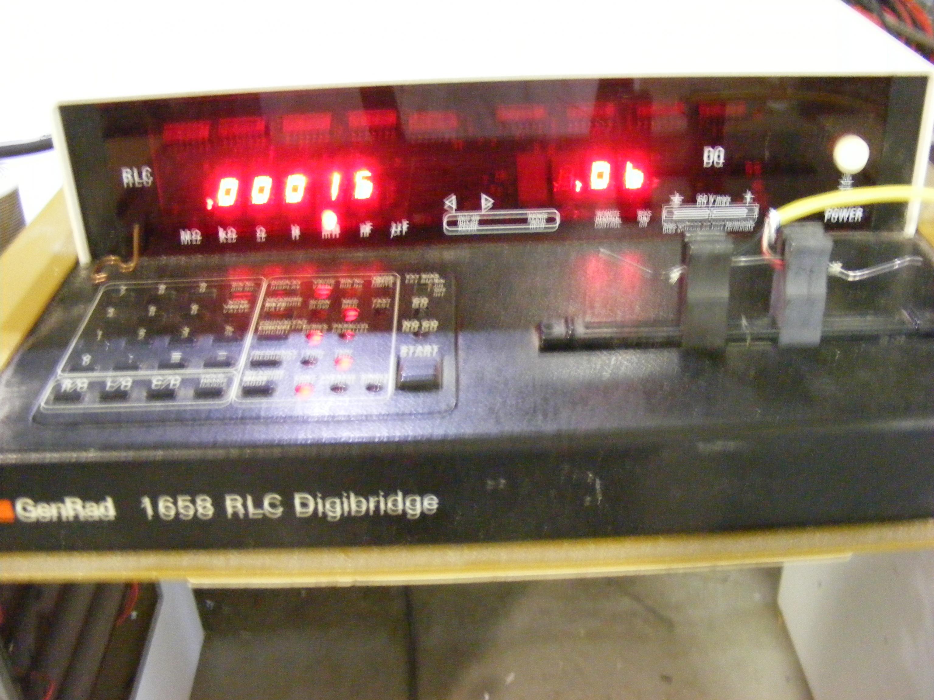

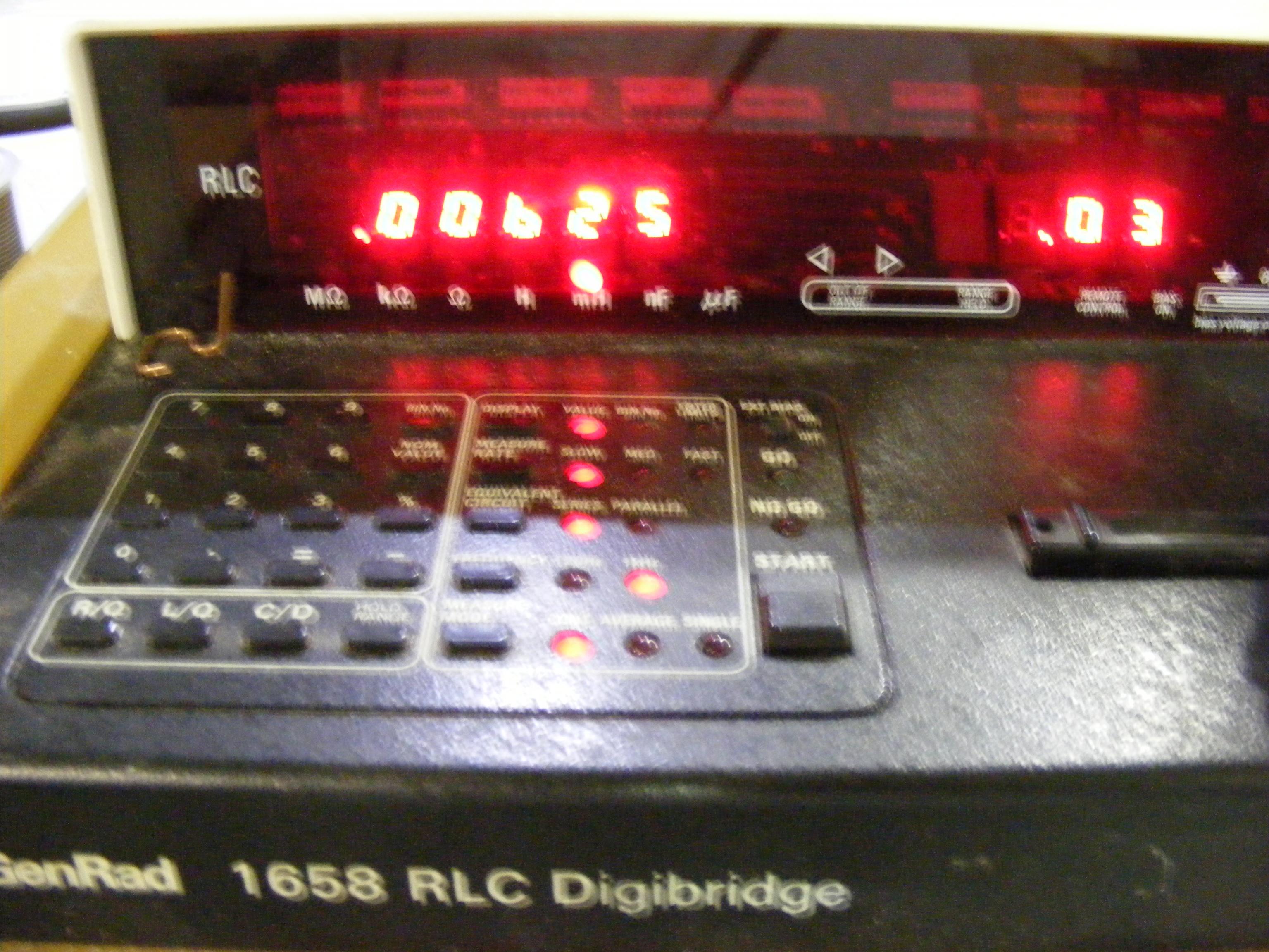

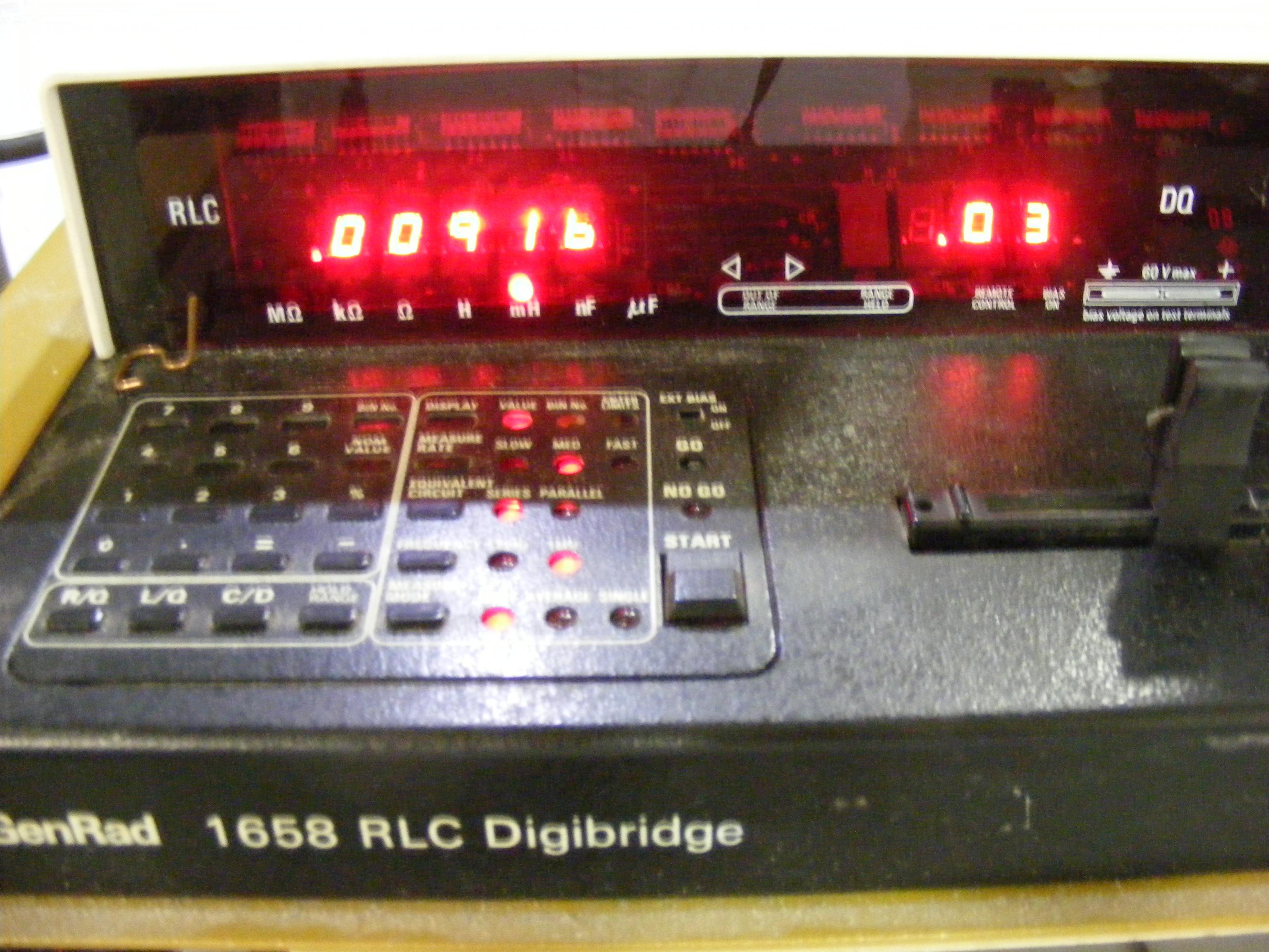

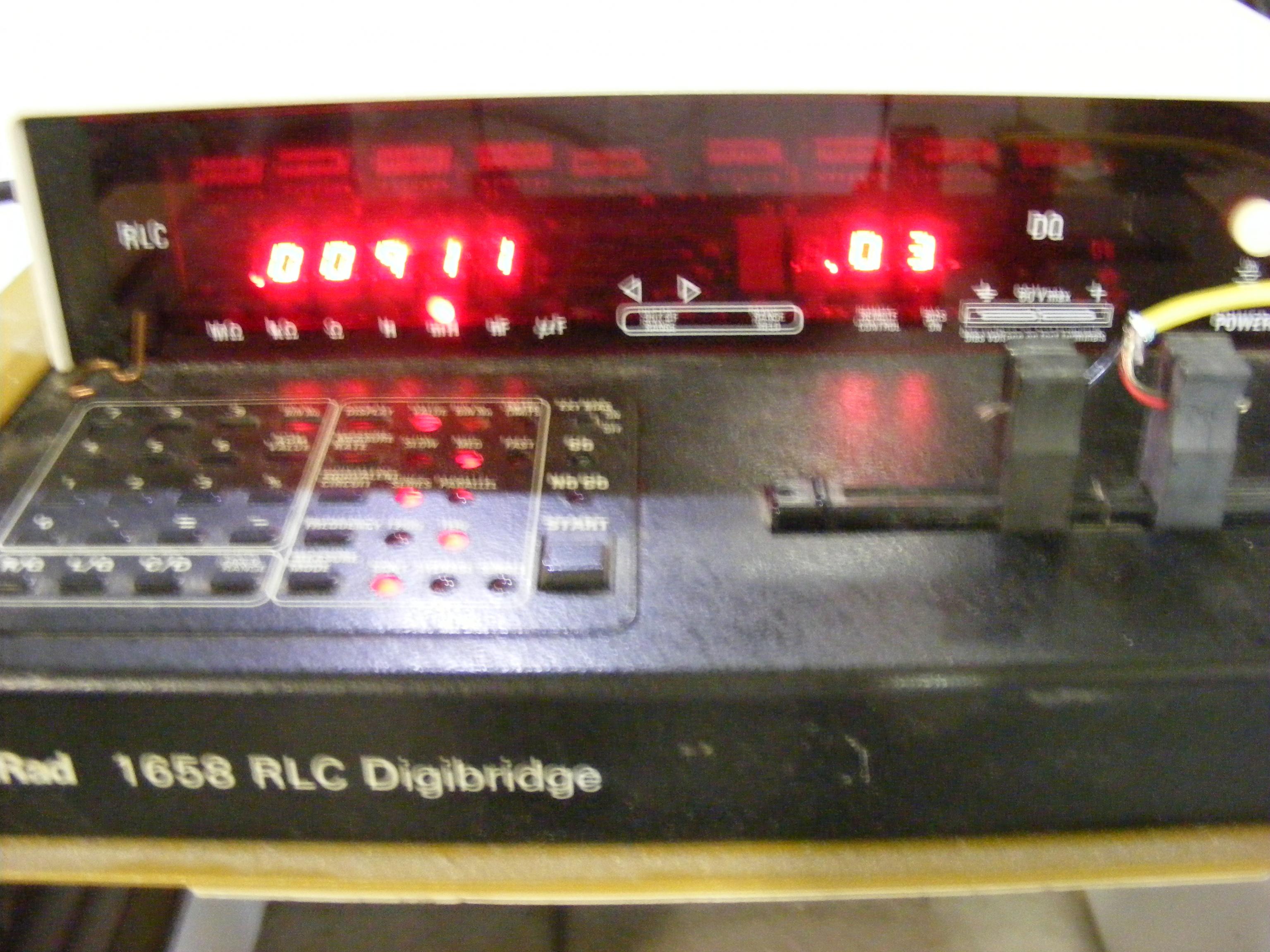

So, what has been learned here? First, posting without captions is garbage.
Second, the test mode is very important. Your initial tests using Lp/Rp gave readings that were off by three orders of magnitude. You justified those readings because of the number of turns and the solenoidal equation of inductance vs turns. At least that is now out of the way.
I note that page 3-15 of the manual for your machine states that the series mode is more appropriate for air core inductors..
It is very refreshing to see those leading zero's, with numbers far more consistent with the actual numbers expected of the cable.
Now, let's review the actual numbers being seen, and why they may or may not be accurate.
160 nH for the shorted seems ok, but can't you autocal that out? The manual says you can.
Then 9.11 uH, 9.16 uH, 6.25 uH, and 6.22 uH.
I assume one set is coiled and one uncoiled.
I did not find in your manual a discussion of Q, series resistance or capacitance issues which will impact the measurement accuracy. As I stated quite a while ago, these meters are incapable of discerning capacitance from the inductance readings. So unless you can scan across frequency and plot the resultant values, you still do not know which is the correct value. I assume the uncoiled would be the correct one, and the coiled is compromised.
Nonetheless, as you can see, the number of turns vs solenoidal inductance is totally blown outta the water. All that's left is to figure out how badly your meter reacts to capacitance.
But you're getting there. Perhaps somebody else could repeat it using a better meter, scanning across the frequency band to identify confounders that are not visible using a single frequency.
