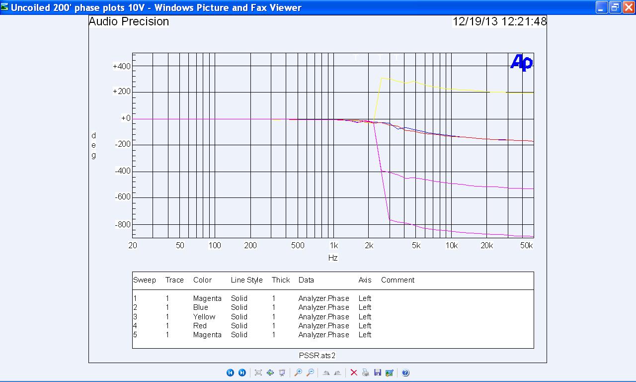

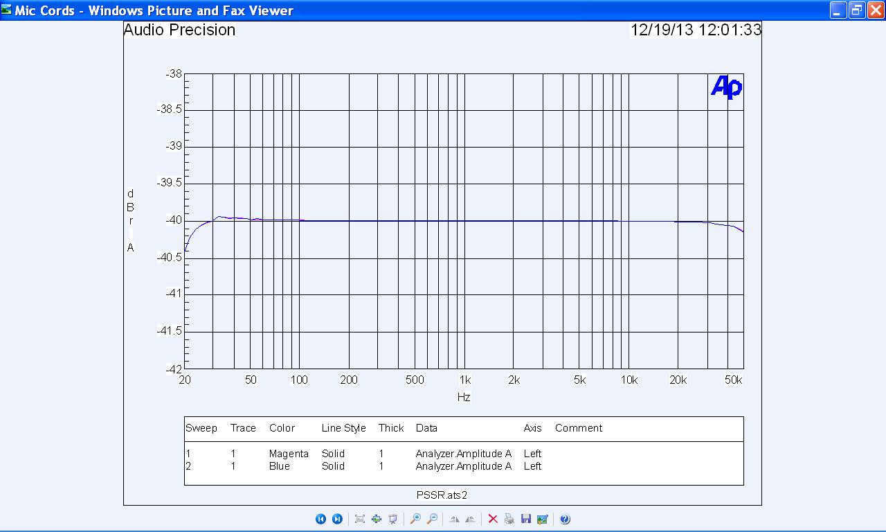

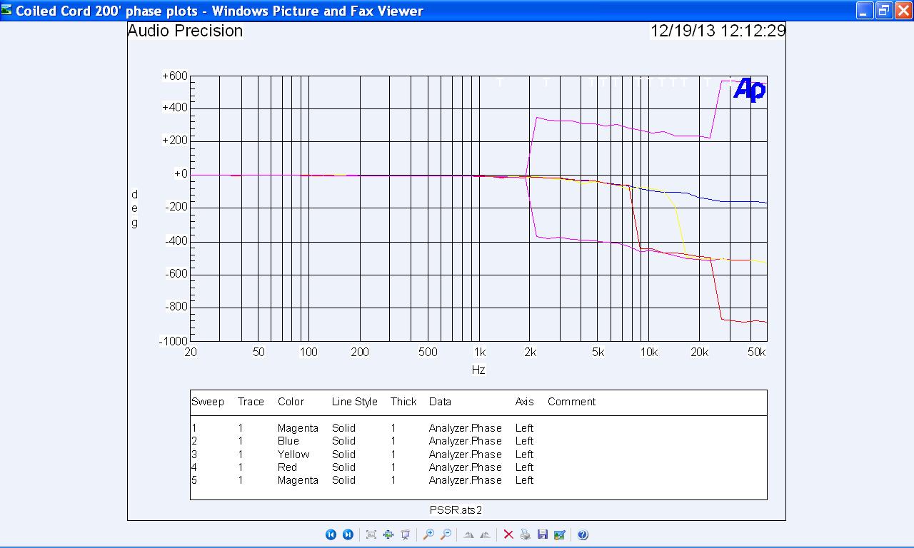

I was just showing there is a difference between coiled and uncoiled. Now a valid question is there enough difference on 250' of microphone cable to actually be heard. So since I have all the gear I'll run a frequency phase plot set.
Here are the results of 200' of portable mic cable. I ran the F plots at 10mV but stepped the phase up to 10 volts as the AP seemed to lose it's grip on reality.
The most important band is around 5,000 hertz and the coiling seems to reduce the phase shift there.
Ed. The most important thing for you to understand with your plots is this: Your plot goes from darn near zero degrees to 800 degrees between data points? And that doesn't raise alarm bells in your head??? And yet the FR plot is darn near flat through the entire range?
That in itself should tell you that you have a test setup problem. You are not measuring what you think you are.
I most certainly have a problem with how you present data as well. You have 5 lines on a plot, with absolutely no textual information as to what it is..
Also, how are you controlling shield currents? What is your test schematic, did you terminate both ends of the cable at the same piece of equipment?
