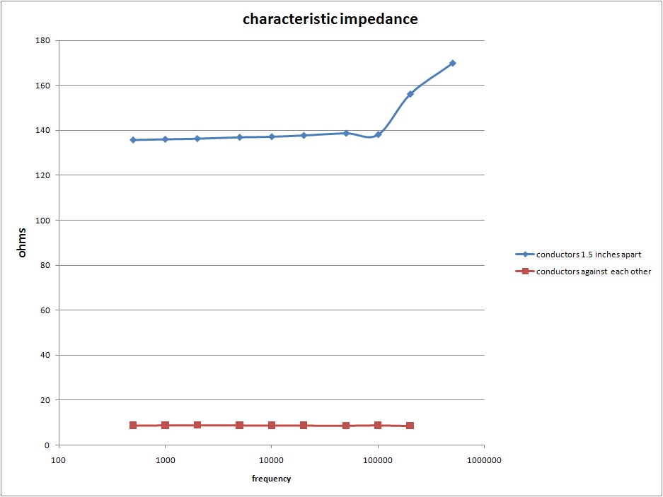

Back in 2011 when I was making a valhalla clone, I took measurements of variations on a theme.
Using half inch wide copper strip, I measured L and C when the conductors were 1.5 mils apart via insulation film, and 1.5 inches apart. Here's the data plotted to show the characteristic impedance of the pair.
I started at 500 hz and ran it out to 500 khz. Note that the tight stripline maintained it's 8 ohm impedance out to 200 Khz, while the split pair went off at 200Khz and 500 khz. For the wide spacing, I can trust the data out to about 100Khz, but above that the data is suspect. It was the inductance that went nuts, btw. The meter started getting confused by t-line effects.
That is why I graph the measured parameter vs frequency, and take the freq well outside the range of interest just to make sure the equipment is telling me the truth.
