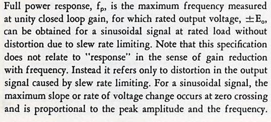

Here's an excerpt from Vol. 1 No. 1 of the Analog Dialog (1967). Large signal BW/distortion and its relationship to slew rate was well known.
Was this in Cherry and Hooper's book? No, I don't think so. OF COURSE, we knew about slew limiting. In 1967, the engineers in my department, Ampex instrumentation division, were complaining to me about the slew rate limitations of the UA709, the best that was available at the time. In fact, I was a near expert on the UA709, in some ways, because I had to measure 100 of them with a special analyzer that we built, with a Fairchild app note, at Friden in 1966. However, slew rate was not what we were most concerned with, on that project, BUT our instrumentation recorders went up to 2MHz. No IC's for us, thank you. We did it all by ring of 3, discrete, using the fastest devices we could get.
I once did a survey of Slew Rate limiting in the 1960's with just about everything available to me and in silicon valley at the time. Very few references to it, except how to measure it, on occasion. It wasn't really a problem until IC op amps became available.
