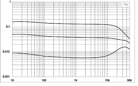

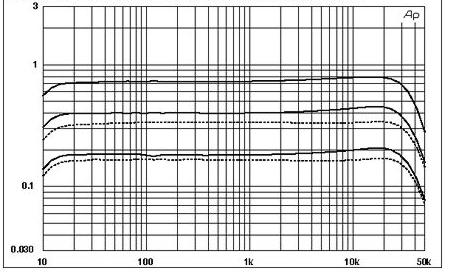

John,
There is much talk here about PIM, wide OLBW etc, however I don't see
much discussion about distortion versus frequency profile which is one
result of the OLBW and amount of NFB used.
It is my observation and experience that amplifiers with a flat distortion
versus frreq characteristic sound better than ones with rising distortion
at higher freq, even where the absolute levels are lower.
Ref to two images below. Both amplifiers won Stereophiles highest accolades
WRT subjective sound quality. Both have no loop FB. The distortion levels
are moderate in one and quite high in the other but they both share a very
uncharacteristic (for an amplifier) flat thd level vs freq respone.
I agree with Putzeys on this one, if you are going to use FB, use tons of it
and get rid of -all- distortion right up to 20kHz, which most power amplifiers
dont come close to, or make it flat in level through the audio band.
cheers
T

Both measurements are using high frequency rolloff filters, as the distortion will usually rise above 10KHz, if only because of added non-linear capacitance that will come to dominate the nonlinearity, at least in solid state.
I personally think that a flat distortion response is a good thing. IF not, then take the worst case, that is usually above 10KHz.
Generally speaking, a flat distortion response, at least to 10KHz, shows a high open loop bandwidth, with either open loop or feedback. More negative feedback would probably be OK, IF we could keep these flat distortion curves, just reducing them with the application with MORE feedback. Alas, that is almost impossible, because for a given gain bandwidth, set by the actual devices used, their operating current, etc., we LOSE open loop bandwidth in order to increase low frequency feedback. In fact, above 10KHz or so, the feedback is about the same with any equivalent amplifier design where current sources replace load resistors, for example. If we could keep the open loop bandwidth to 10KHz or so, we would be way ahead of the curve. Even my best high power designs only have an open loop bandwidth of 4KHz, at the moment, and I am hard pressed to improve it. Still, 4KHz is a lot better than 40Hz, or less, used by many op amp and power amp manufacturers.

...as the distortion will usually rise above 10KHz,
John, please don't jump to the conclusion that they are automatically using filters to get that response. The whole point of Terry's post was to point out that it does not have to 'usually' rise. My (limited) experience suggests that designs with a flat THD / f response can perform remarkably well compared to those with THD that rises with frequency.
I understand that Lamm makes this flat response a design goal in their line stages.
Terry, which amps were they?
