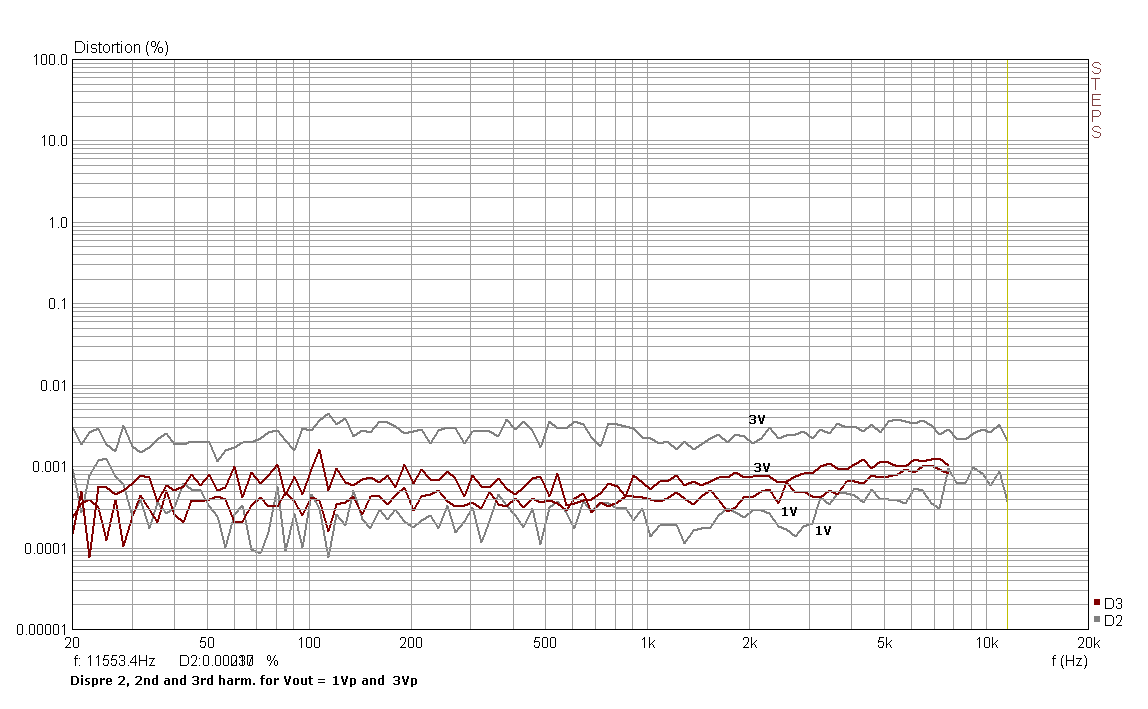

Is this a power amp into 8ohms or preamp into high impedance
Here is a 250W power amp with a flat response vs frequency. This was plotted at 1W and 10W and the curve is quite well behaved. However, I think if this was done at say 100W or 200W, it would take on a different shape, and distortion would rise at higher frequencies (here I mean at a few KHz for example). This is a 'moderate' feedback design - about 18dB at 20KHz you can see here: http://www.diyaudio.com/forums/solid-state/89380-ovation-amp.html. Note the response drops off at HZ because of the AP's filtering.
(Note: This test was done on 100VAC rails, and the transformer is wound for 120VAC)
