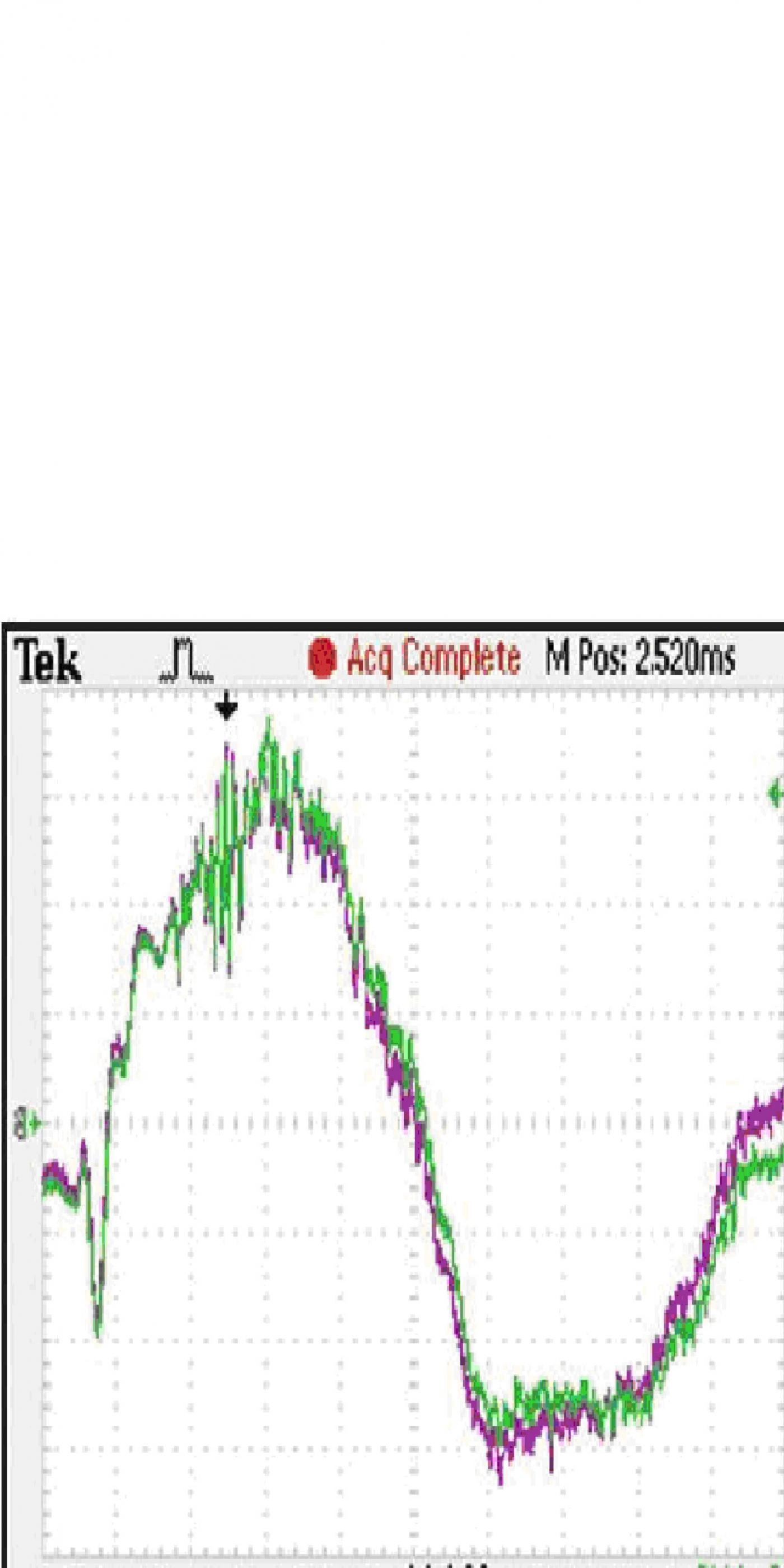

This months AudioXpress is a particularly interesting issue. First they have not wasted any space on my drivel and secondly there is an article showing the change in processing delay over the course of a single cycle for both a gain clone and a tube amp.
Simon, AX is always interesting, even with your stuff in it 😉
But seriously; are you referring to fig 1 & 2 in that article?
jd
😉=Humor
Yes, the changing delay is most interesting.
I will try to confirm his results as I have some gain clones.
Simon, I'd be curious to your findings.
I cannot see any delay in Figs 1 & 2. The plots don't support that.
If you look at some tell-tale peaks on the waveforms that can be used for reference, for instance at the bottom of the negative-going part of the waveform, or just to the left of the zero crossing, it is clear that in both cases the waveforms line up EXACTLY. There is NO delay visible (which would be difficult to see anyway at a 1mS/div scale). There is only a level difference.

When I look at this I see the waveforms start out at the same time then the green trace begins to lag. If you shift the trace to match levels the lag gets worse. I do not know if this is an artifact of how the waveforms were sampled. I just find it interesting.
When I blow this up I see some spikes have shifted by a few pixels.
