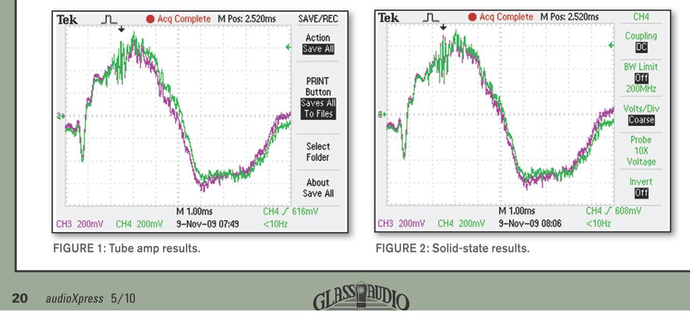

When I look at this I see the waveforms start out at the same time then the green trace begins to lag. If you shift the trace to match levels the lag gets worse. I do not know if this is an artifact of how the waveforms were sampled. I just find it interesting.
When I blow this up I see some spikes have shifted by a few pixels.
I don't see any lag. I see a change in zero-crossing which points to a difference in level and/or shape.
Look at the peaks on the waveforms that are strong enough in both to compare. They line up exactly.

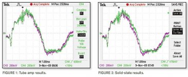

I downloaded the pdf and the graphs are reversed to yours Jan.

The offline version (downloadable pdf) appears incorrect.

Indeed. Jan pointed out, seriously, that the scope readings do NOT show what the author claims they show (e.g., delay). Do you have an alternative explanation of why all of the larger peaks line up perfectly along the time axis for both the tube and the transistor amp?
Here's more Serious Comparison: there's no quantitation over what "fits" best, just a "gee, the tube one looks closer than the transistor one." Now a major part of that is indeed a matter of scope adjustment, but there's certainly going to be some difference. And just eyeballing is not exactly a real judgment- frankly, if I had been handed the two charts without any information about what was being compared, but just asked the question of which output appears to follow the input more accurately, I'd have picked the other one. Whose eyeballing is correct? I don't know, but when the author had the actual data in hand, it would have been nice if he'd done more with it.
So, get serious. If you (or Ed) think these data DO support the author's contentions, please explain why.
Thanks for clearing this up, Terry. I was confused also when I read this article in AX. The graphs were apparently published backwards, and the solid state design tracks the input signal better. I wonder if that changes the author's conclusion?

When I cut it, paste it and blow it up to a full page size (English 8.5 x 11) I see about a 3 pixel offset on some of the spikes. Full blown proof! Of course not. Valid data, not really. Does the author have more detailed information, don't know. Enough to try the experiment myself? Yes, since it is trivial, as I have all of the parts.
As to AX mixing up the graphs, that is not uncommon.
The advantage of publishing is that sometimes people who know more than you do, write in and increase your level of knowledge.
The biggest issue to me is that I do not expect to see that much difference between the input and output of any amplifier!

The error is the magazines and I have notified them.
FWIW, I don't see much substance in the whole article. It needs
to be done more scientifically with much better plot resolution.
