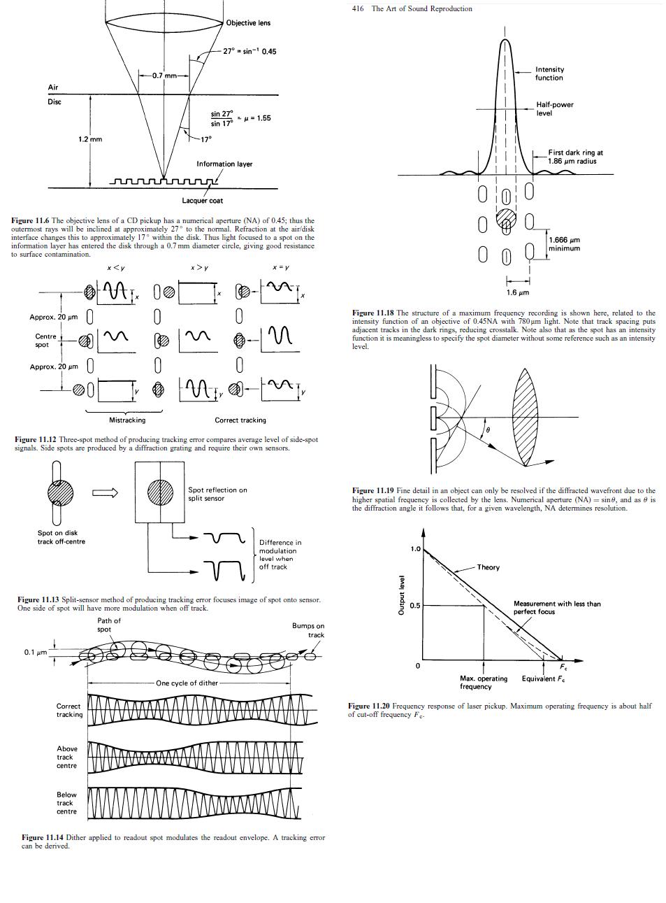

Annealing alum at temperatures that will not damage the plastic, will give you at very best 1% tensile strength reduction.
Recrystallization is also out of question.
As for the disk edge treatments, if one read only on optical design, he will realise that such treatments have no hope of affecting data readout.
(Attachment is from John Watkinson’s very telling book “The Art of Sound Reproduction”
Years ago I had hand bevelled and painted black the edges of very many CDs.

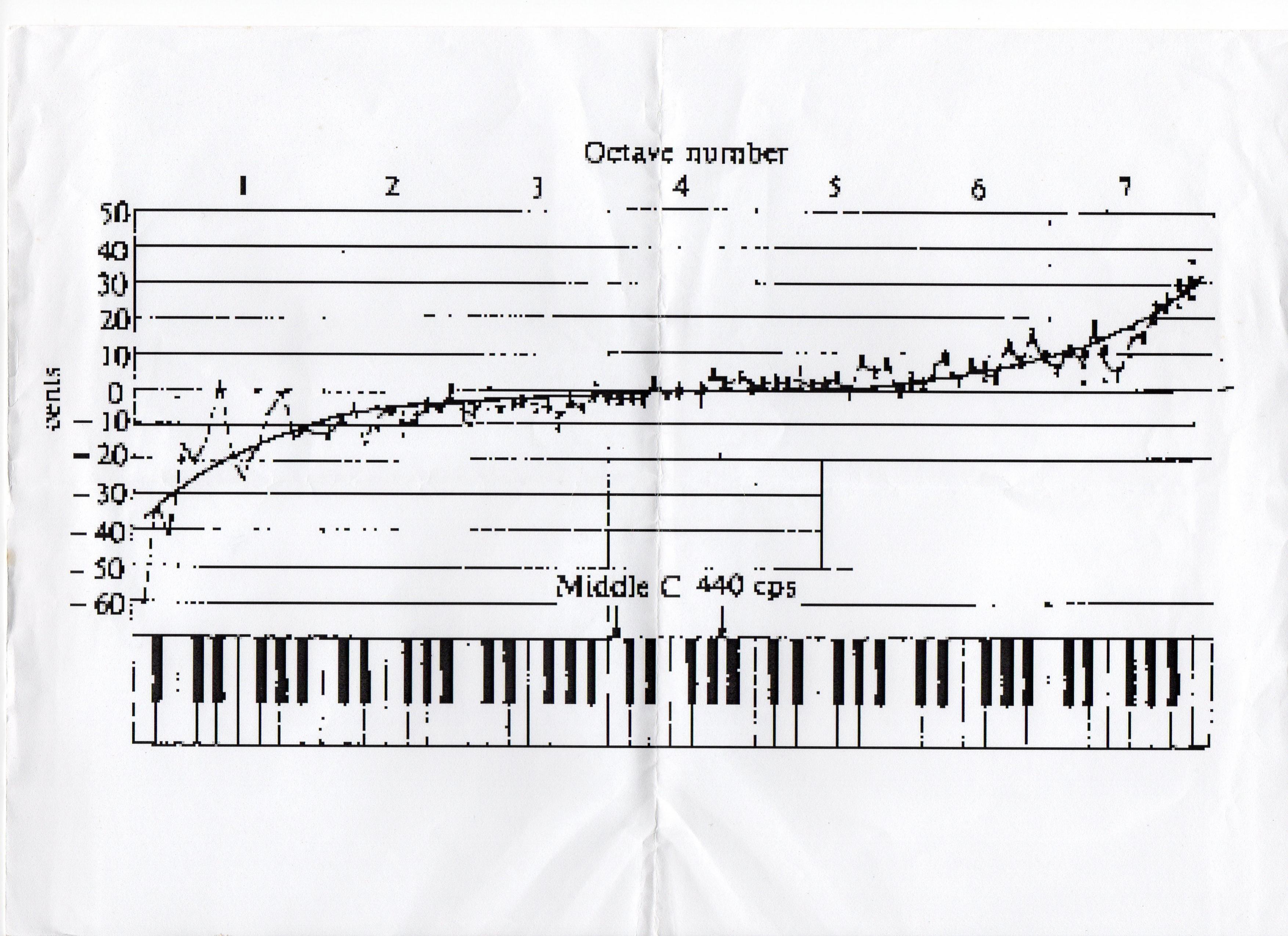

A piano for example is tuned to an equal tempered scale, perfect octaves but the top octaves are "stretched" and sharpened a few cents (because that sounds better to the ear) and the lower bass octaves are flattened for the same reason.
Mooly,
This is a peculiar take on what constitutes an equal tempered scale. Are you saying that tunings exist in which each subsequent octave is not an exact doubling in frequency of the preceeding scale?
Surely, the exact intervals within an octave have to be 'stretched' in order to align with the other mathematical universe of logarithms, but this takes place within an octave, not between octaves.

This shows how an experienced tuner might tune a particular instrument. Its always a matter of compromise and what "sounds right" for a particular instrument.
Also,
Piano tuning - Wikipedia, the free encyclopedia
Hmmm, one learns something new every day: Inharmonicity - Wikipedia, the free encyclopedia ...
All part of the problem.
