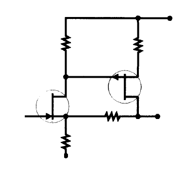

I'm trying to figure out what causes the signal attenuation.

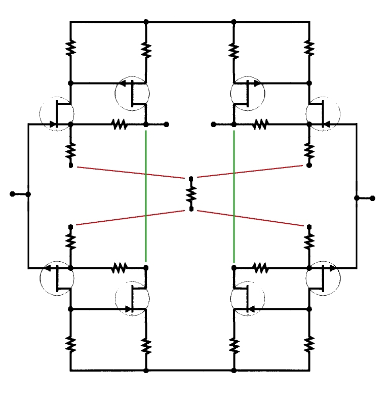

Gain is set by 1k+180R and 100R (simplified) for one quadrant, and the basic topology of each of the four is like in the picture below, right?

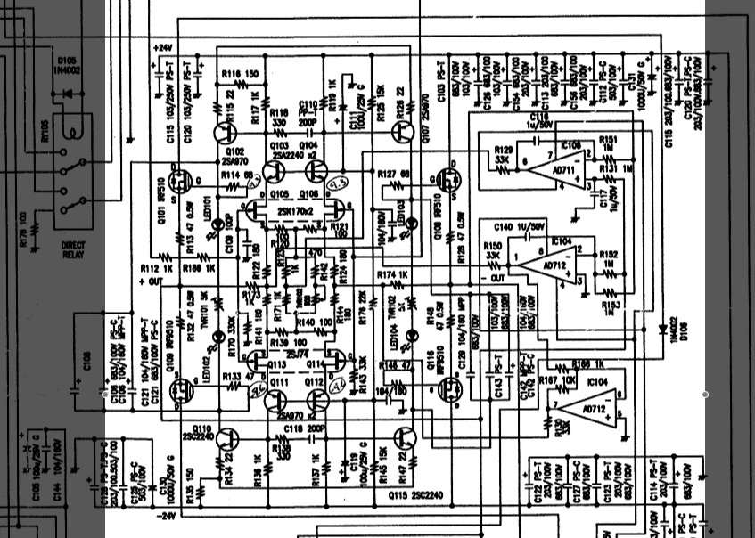

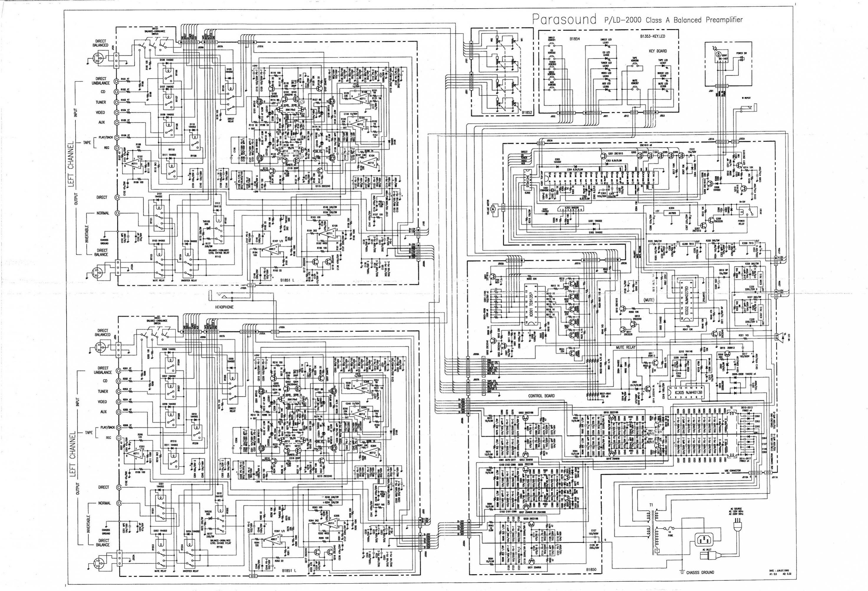

Real schematics are 'messy'. This is because they have to meet so many needs and features.

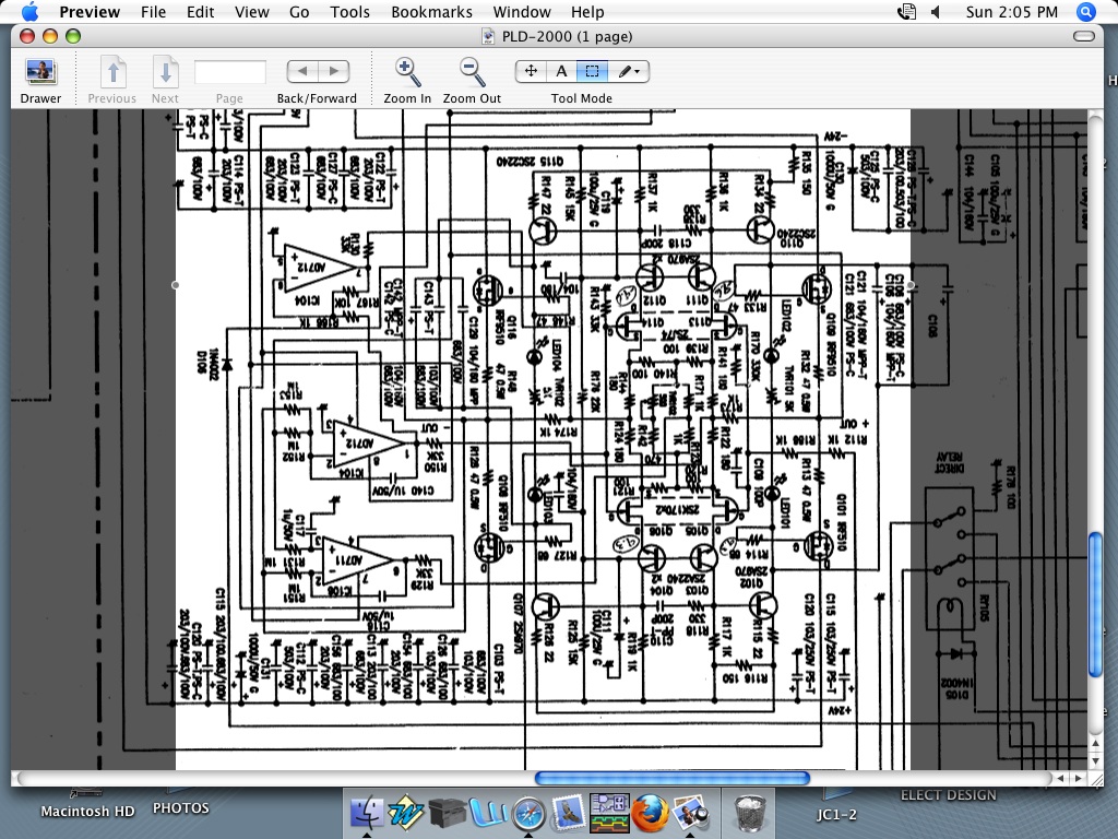

The PLD2000 was my first effort to make an 'all out' JC-80 based preamp for Parasound. I did only 1/2 the design, and that should be obvious, but I did the 'heart' of the design, the 4 quadrant gain stage.
This preamp never got very popular, although it had lots of features, my name associated with it, and very competitively priced.
