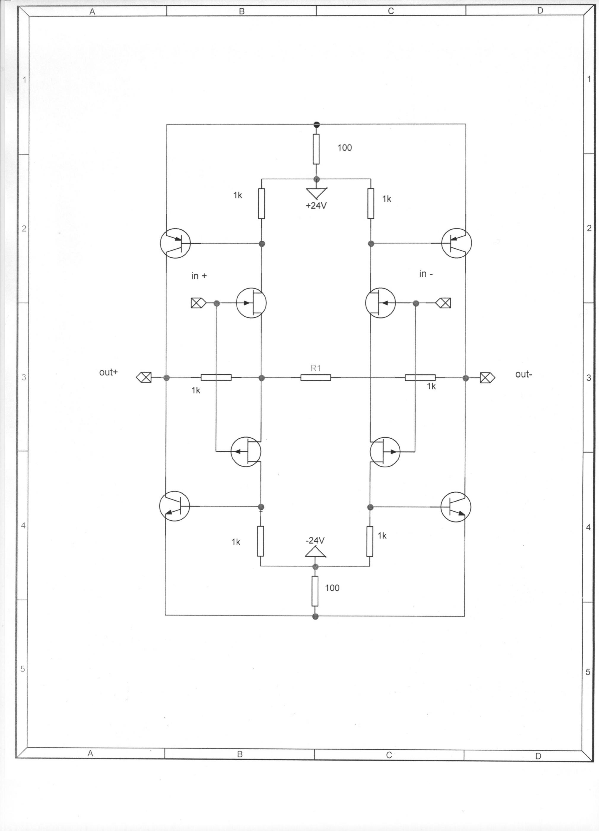

Still, nobody seems to want to talk about the circuit topologies in both the Blowtorch and the Parasound products. Should I simplify it still further?

Here is the 'minimum' version for discussion at the moment:
