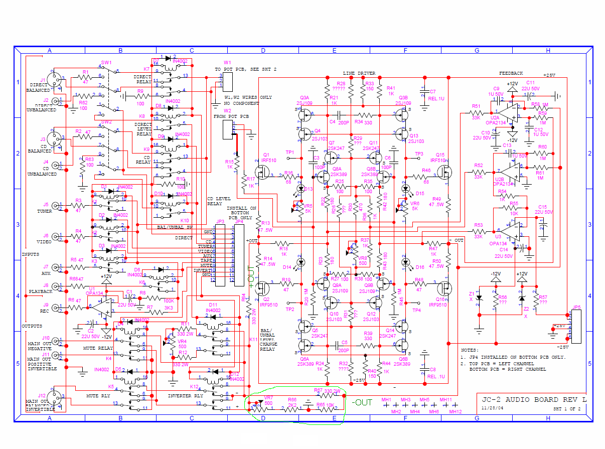

OK everybody, here is a 'dated' example of how we make line level preamps 'today' rather than 30 years ago. This design, known as the Parasound JC-2, is more versatile and measures better than either the CTC Blowtorch or the JC-80.
Why don't we discuss this schematic, instead of trying to turn a T0-92 into a TO-5?

Thank you John this is a huge step forward. I think everyone here would like to talk "shop" rather than all the back-biting.
Better distortion than the LT1210 then ...?
I should hope so, I am getting my own eval card to do audio measurements since this has nothing to do with audio.

Is this correct???
Please note very different load resistance (and different location of loading resistors) for +OUT and -OUT. Suspicious parts in green circle.
