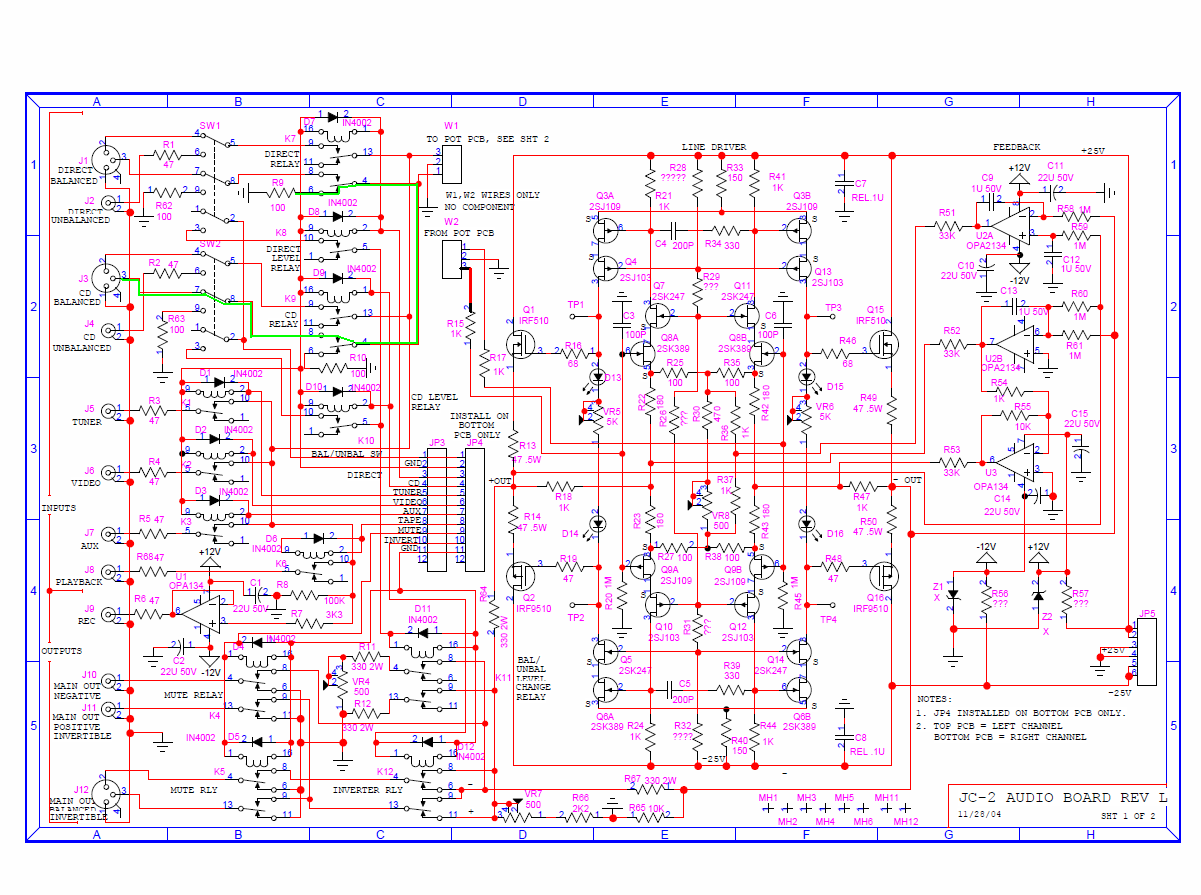

Pavel, is that jumping an open circuit at contact 8?
Yes. It must be closed (4-8 CD RELAY) when we want to get -IN from J3 connector. 4-6 of DIRECT RELAY is Normally Closed.

jn
SY, PMA, you're a party poopers!
I thought we'll be discussing topology, but all you both do is pick on errors in drawing. John posted the same schematic, but later Rev. a while ago, didn't you downloaded it?
Ok, I'll ask: John, in contrast to your previous preamps, you're using LEDs to bias output Mosfets. Any special reason for that, except the largish voltage drop? P/LD-1100 has two bipolars in that place..
