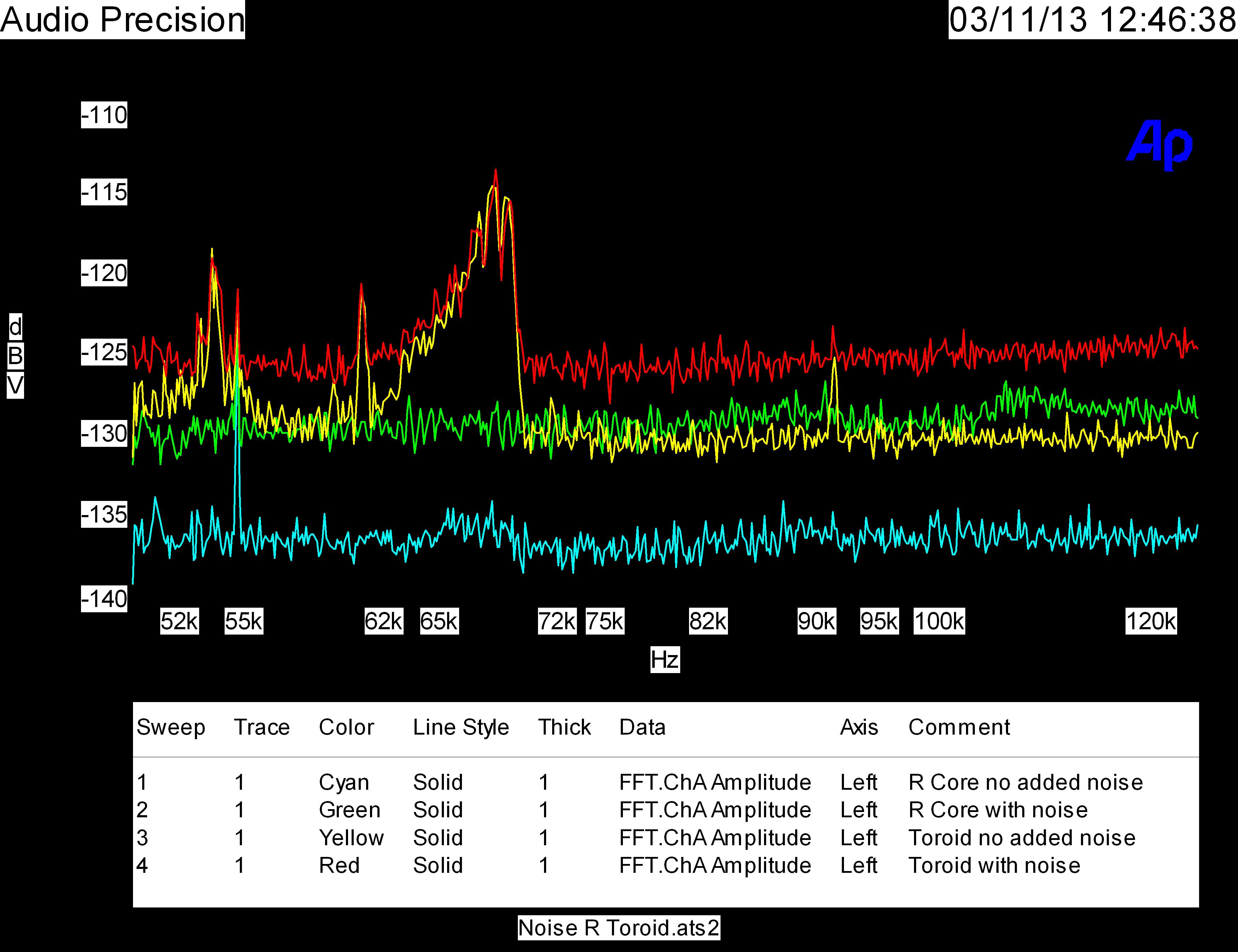

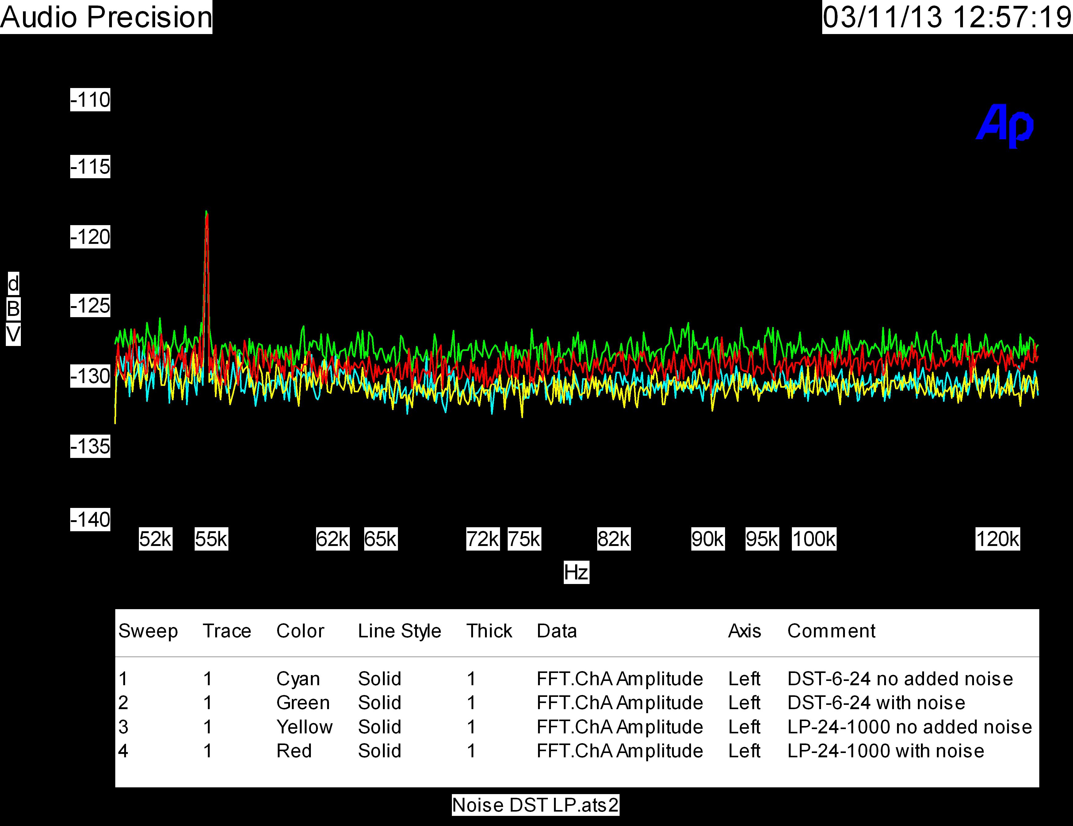

Well since things are quiet, I'll post a few more interesting power supply measurements.
This is the AC line noise that passes through a power transformer. I find the self limiting resonance most interesting.

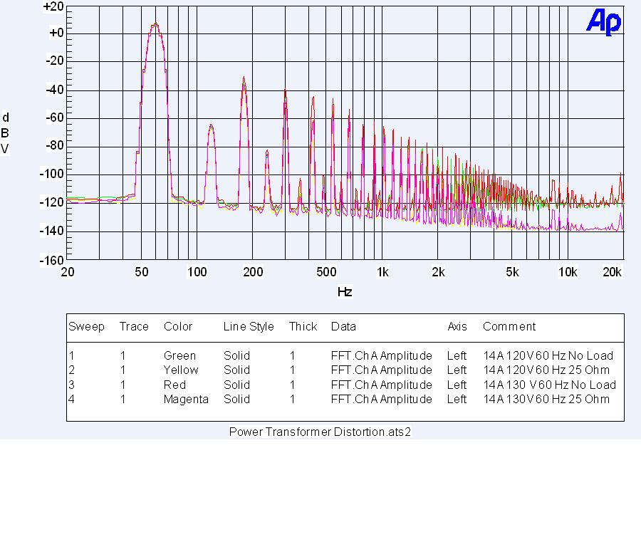

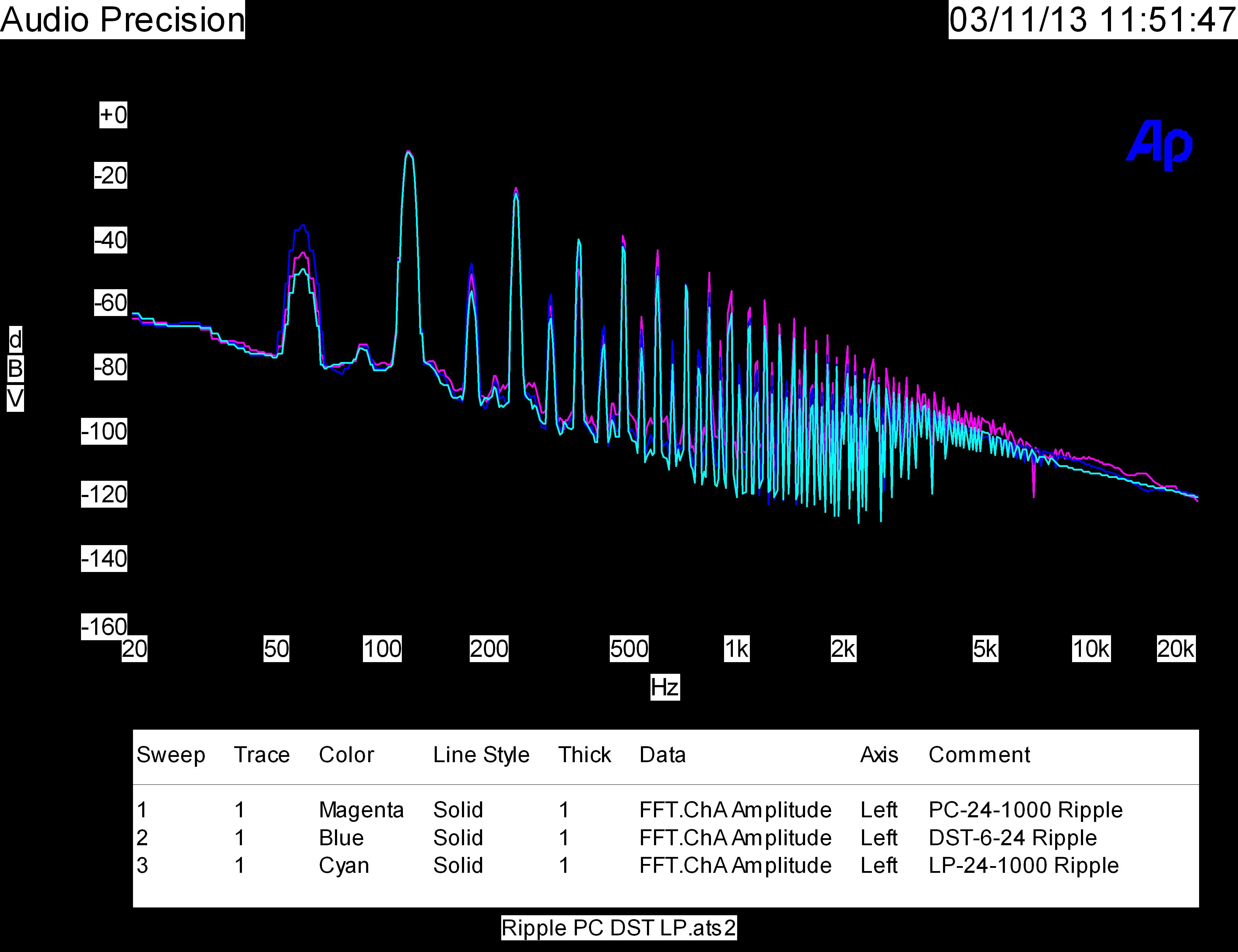

Thanks, I am two years in on this power supply thing and think I can finish the article.
I found it interesting how much distortion just comes from the transformer even before you add rectifier noise.
Attached transformer distortion with an AC load resistor or not and then with a rectified load. BTY the first graph has a 26 db attenuator in circuit.
So far I have shown transformer distortion, rectification distortion and line noise pass through.
Next I might even show the effects of filtering with big C versus distributed RC.

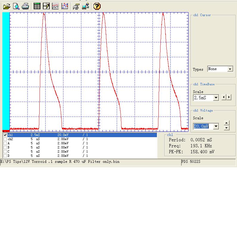

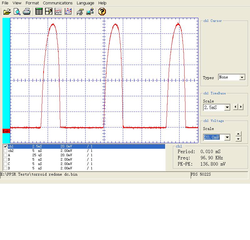

The thing that popped out was that the transformer uses up 60 degrees of the cycle actually charging, pretty much no matter what the load.
