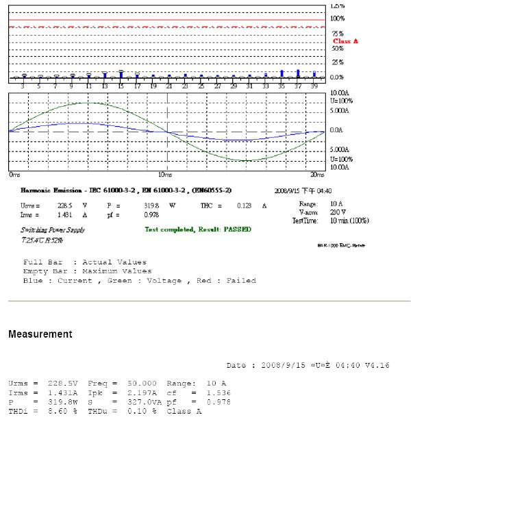

I spent some of today looking at a problem. The venue has around a hundred switching power supplies loading a single three phase breaker box.
Some of the switchers are 300 watts others are as small as 60 watts.
The circuit breakers have failed.
The question was if the harmonics of the power supplies did it.
After looking at the actual measured AC harmonics and radiated distortion, my suspicion is the breakers were installed incorrectly.
The harmonics from the switching power supply are lower than much of what I have been seeing from linear power supplies!!!!
If I get a chance I will post the spectrum of the switching power supply currents.

Yes. New construction of large venues gets special pricing direct from the manufacturers. My main breaker here is several hundred dollars through normal distribution. A spare picked up from a friendly contractor during a large project was $80.00.
These are fancy breakers that monitor the current and combine into an energy management system. So either they set the trip point switch incorrectly or didn't mount them in the panel correctly.
Balancing the phases "fixed" the problem and no one wants to send me a failed breaker, so I suspect installation was the actual issue.
This is the data on the switcher. 8.6% line distortion at 230V in. Look at the current vs voltage graph. Linear supplies are nowhere near that good. The spectrum is hard to read as it is a bar graph but you can see it is higher order stuff.

Clearly that one has pretty good power factor correction.

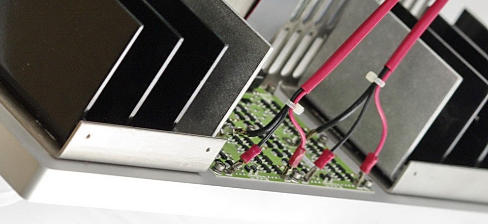

Dual output stage on an Al2O3 board, face to face with the 'heatsink' panel.
Jacco, marce is likely talking about devices that expose the die/substrate to a pad on the underside, rather than the pretty high impedance of the epoxy body, when trying to pull the heat through the top, like you have there.
using these devices means 2 thermal interfaces are cut out of the thermal impedance calculation.
even something as simple as the LME49726 opamp in a MSOP8 powerpad package, allows a small opamp that will put out 300mA at 5v output. I havent even picked the highest, just one i'm looking at today.
Was the panel fed delta or wye? Excessive neutral pull could cause overvoltages. Given the waveform shown with the dead just in front of zero crossing, I'd first look at the neutral currents.
Smt packages will generally have one or more of the leadframe coppers being used to remove heat from the die. That is done by bonding the die backside directly on the copper, heat transports through metal to the external solder pads of the board. Any lead which is not chip backside will have a very tiny wire bonded chip to pad, they are not direct heat transport mechanisms, there will be a little due to side conduction of the encapsulation epoxy.

The SMT's have their large collector lead soldered to pads at the underside.
Contact surface of an SOT-223 larger lead is 0.01 in2 , each pad is part of a 0.1 in2 area of the output lane.
Each half of the board image manages 20A peak in 1 Ohm, aka ~2.2A per output device.
Hence the 9 Allen bolts to clamp the board to the front panel.
(each of the SOT-223 can do 15A peak, from a 1/30 in2 size body, btw)
aah sorry Jacco, I misunderstood the photo, I took the exposed board as being the same as the other 2 ie. lots of tiny sot232, but without the heatsink to illustrate what was underneath.
looking at it again now thats stupid, the connections would foul on the heatsink :redface:
